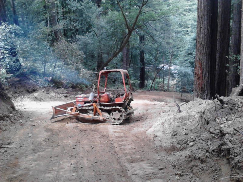

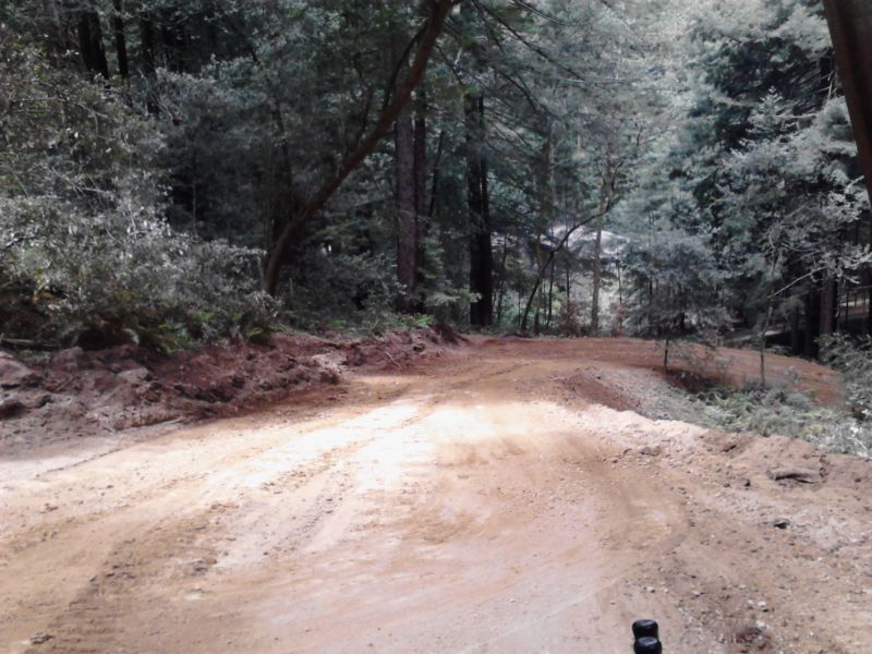

I've cut a steep road to my cabin. Dirt has gotten powdery and slippery. I can get ground up asphalt for free or recycled road base for $15 a ton, just a couple miles away and I have a dump truck. Would either of these help? Do I need to scrape the soft stuff away first? I have a tractor with drag box.
# Posted: 10 Aug 2015 11:34am
how deep is the soil? and what's under it?
from the pic I can't tell if that's sand or clay. kinda looks like clay/leaf litter.
If you put road base on soft soil the weight of your tires will push it into the ground. and come spring it will disappear.
google "geotextile road". the formula is tarp (geotextile). 4" of 3" crushed. cover with road topper (5/8" crushed or similar). I imagine you could use all recycled road base. what size is it?
the tarp is pricey but it will keep your crushed rock from vanishing.
I'm looking at that and boy does it ever remind me of a mountain bike trail a couple of friends built (washed out the first winter). you might want to look at where the water coming down the slope is coming from. and where you want it to go. culverts ditches are some'at to think some on anyway.
looks like a real nice spot.
# Posted: 11 Aug 2015 09:29pm - Edited by: paulz
Thanks Creeky. Yeah it's pretty soft. Looks like the tarp stuff would be about $500 for the 300ft. or so I need. Not bad. If I could just use the recycled road base on that it'd save me a bunch, the crushed rock is $60 compared to $15.
So I was advised to camber the road in towards the hill for the straigtaway, and inward on the U-turn. I have been working on that but need to finish up before I start spending. I dug a ditch where the hill hits it and ran it straight all the way down past the curve. The road has actually been in for a couple of winters and doesn't wash out that much, nothing I can't fix in a day.

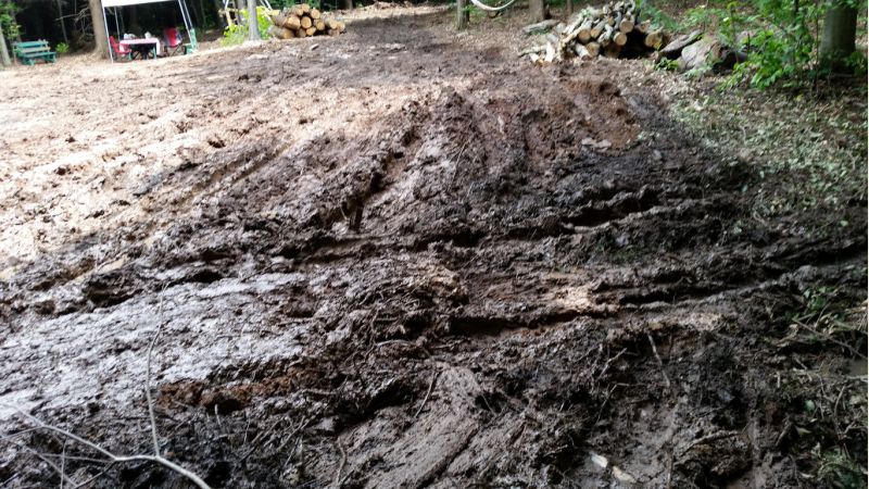

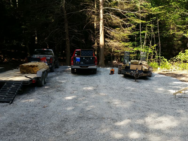

I did exactly as creeky described, geo, then 4's, then 2rc topper stone. And I covered some serious mud.. The corner in these pics got no sunlight, and I got impatient waiting for it to dry out, if it ever would. Thought about scrapping it off, needed that area for parking, but would just need to fill it back in anyhow, buried it...
