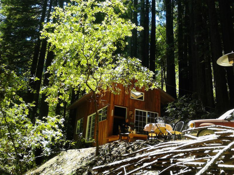

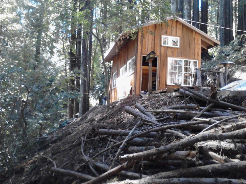

My cabin sits on a steep slope that I cut a flat area into. The foundation itself sits on hard ground but the 4-6 foot area outside is fill from the cut that I put over the side. I have noticed some cracking this summer (maybe 1/2" wide and 2' deep so far and would like to stabilize this area. A neighbor thinks I could rent a pile driver and pound 3" diameter pipe into the ground, anyone ever done this? Should I fill the cracks to prevent water filling them when the rains come? I'll probably tarp the area anyway as I did last winter.
EDIT: I see I can rent a gas powered post driver for $100 a day, anyone used one or know how big a stake it can drive?

The faster the velocity, the deeper and quicker the erosion on new, non compacted fill. Littlecooners law of erosion, 2015!! I see a steep roof, long way to the ground and fresh fill just below where the rain runs off the roof. Question - is all you erosion due to no gutters or no swale at the bottom of where the rain runs off the roof? Any way, you do not indicate what part of the North American continent your cabin is located within, but a quick google search should yield some seed that would be quick vegetation for cover (erosion control) while mother nature settles your new fill site back to a compacted nature. Try millet or rye grass, will usually sprout and start growing within days of the first sign of moisture. Mother natures freeze and thaw cycles this winter will help greatly to re compact the new fill. You can also buy some jute mesh erosion control netting that could be placed over the fresh dirt, helps in preventing the little rivelutes you are encountering. No action and those little normal rivelutes will turn into big gullies this winter in the rain season and you will loose all your non compacted fill to your neighbor down stream. Its called best management practices for erosion control for your google search.

Darn, just got back from the cabin (it's only 20 miles away from my house, 10 miles from the Pacific Ocean in the Northern California Redwoods) and meant to take more photos. Anyway the fill has been there about two years and some ground cover is starting to grow on the slope, looks like ivy or something. And yes, I didn't have gutters up yet last year and there is a distinct line and recession of the dirt outboard of the eves.
Yesterday I filled the cracks with dirt, I guess that's about all I can do for them. Going to investigate the netting, fabric, grasses etc. you've mentioned. Thanks for advice. Got a heap of work in this cabin and love it, need to keep it!
