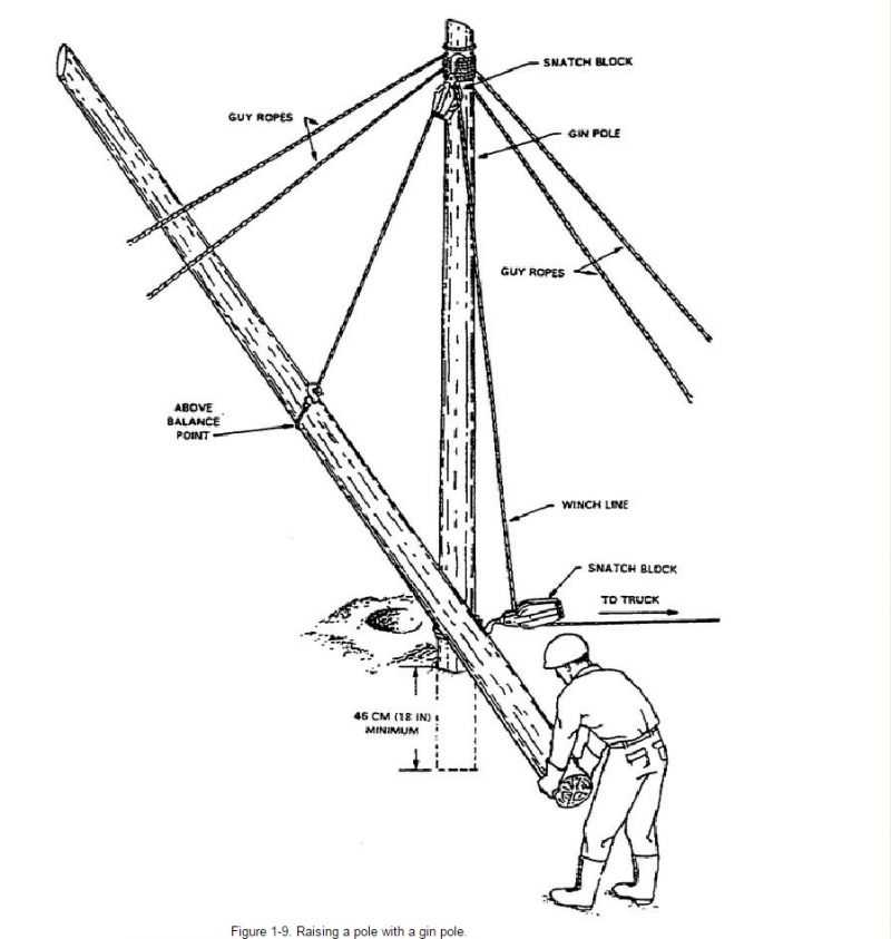

Gin Pole....
The first time you use one it will scare the hell out of you, the second time you trust it but it still scares you...
https://youtu.be/p4I66CJIwLc
https://youtu.be/41aB0lFe_1w

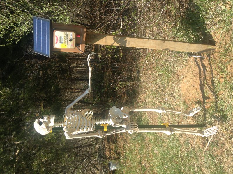

I also ended up working on my electric fence... The idea was to keep out the Bears.... But apparently it works on trespassers too!
# Posted: 28 Mar 2016 10:30pm
Reply Quote
Lol! So is that on display at the cabin?
RichInTheUSA
# Posted: 28 Mar 2016 10:54pm
Reply Quote
Yep, it's my pseudo scare crow!
