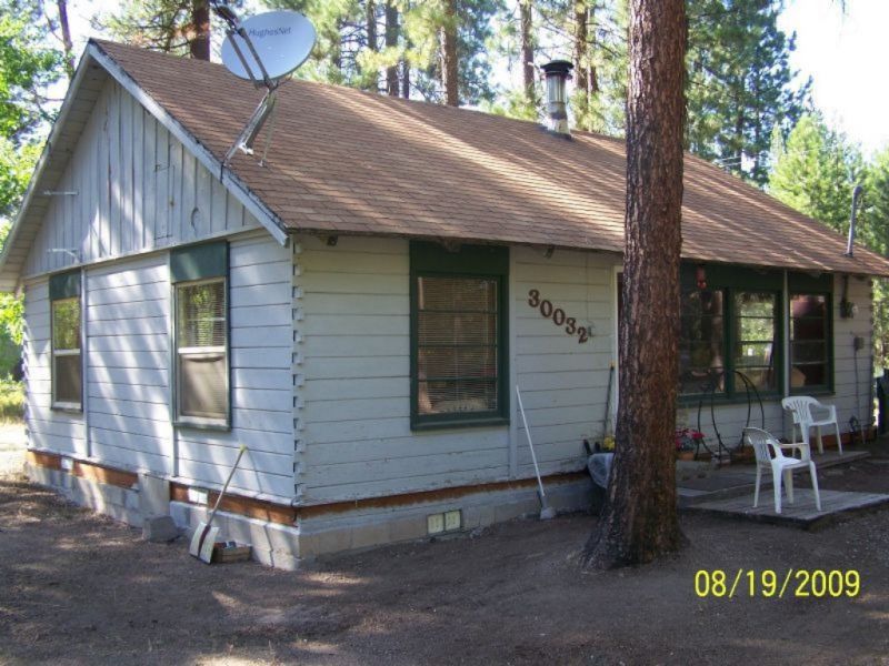

HOWEVER, I was thinking of putting either Hardiboard or LP Smartside on the cabin I'm working to buy. It's wood sided now. Here's a pic. Bad idea? Should I stick with the wood? What's a good way of preserving wood so it doesn't need stained or whatever every year?

Thanks! Good points -- I was going to do the lap siding, not the panels, which is what the shed has. As you can see in the pic, the cabin is on a block perimeter and it also has a vented wood extension before the walls and siding begin so there's good foundation height.
This area isn't rainy but it can get quite a bit of snow. Are there special considerations I should be aware of for that?

I was kind of thinking along the lines of not tearing off the existing siding. Prepping the cabin (I think that doing insect treatment might be wise since termites are a blight in this area), doing underlayment and whatever and then the Hardi. But, I dunno cuz I'm no builder. Your description, Toyota, sounds like what I had in mind.
Notice in the photo how the siding near the gable/eaves is vertical and then the wall siding is horizontal. Would planks work at the top and then lap siding for the walls?
This is just an aside, but the protruding, crossing beams in the corners intrigue me. What's that sort of construction called?

Aanyway, have you been in the pictured cabin... is it a pan abode style log home rather than siding?

Not yet. My offer has contingencies, including a timeframe to eyeball in person. I needed to place the offer so I didn't lose it and structure it accordingly. They want to sell and it needs to be cash because the only heating system is the woodstove. Win-win.
What's "pan abode style"? If it's that, should I maybe let it be, maybe strip the paint and stain it? This particular area isn't wildfire prone, despite the trees.

pan abode made... I think they are still around, a relatively thin milled "log" home kit. I couldn't zoom in enough to really see the corner detail well. WAG. Hard to say what to do without crawling around it, find a good home inspector while you are there. Spend a little time checking them out before they check your house out. In other words they are help but keep your smarts up too. Logs don't burn as badly as thinner pieces of wood... although that doesn't mean you would want a heavily charred home after.

Julie, I'd do the hardi planks on the gable ends too. I dont see a gable vent in the attic or is it living space up there ie a loft?
In wildfire country, you want cement board and a nice clear buffer around your home. Big trees close are usually OK as long as there is no vegetation at the base and no branches till around the 15+foot mark.
If you go metal roof, and gutters, do you get heavy snow there? Metal roofs tend to slide snow off and tear off gutters. You will need to add sno-jacks which is cleats to hold the snow in place. Also, can be dangerous when a few hundred pounds of snow slides on you too.

I'll have to check on the gable vent. I'm fairly sure there are vents. There isn't a finished loft. I posted this photo of the cabin because it was the best one that showed the foundation height, corner, and what the front/side siding looked like in my consideration of re-siding it. (An aside: This cabin is owned by a lawyer as a weekend/vacation getaway and while he didn't do much with interior décor/design, he did maintain and update the major stuff well. It's zoned rural residential so it can be a full-time residence.)
