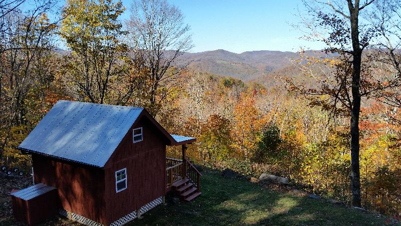

# Posted: 1 Nov 2016 01:51pm
here's a pic
# Posted: 1 Nov 2016 02:54pm
Quoting: silverflash That means i can leave after 23 hours and 59 minutes to go outside then come back in and technically not be in violation. I doubt it. That rule is to prevent sleeping more than one night.
Nice pic! Nice spot.
If the building there was built before codes went into effect it is, in effect, permitted as is and you should never need to permit it. If it is considered unpermitted, it will be very difficult to legalize.
You'll pay an attorney a lot of money, but he'll tell you what you need to know. You probably could get the info cheaper by other means, but not as quickly.
