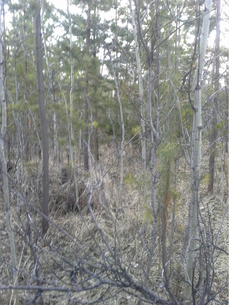

I apologize it this has been asked but in searching I haven't found a definitive answer. I just bought 25 acres, now the work begins. I live in the city so this will be a long project for me. However, my first goal is access. I am having a driveway put into but that will be along one side. I would like to add some trails to have to the natural clearings on the rest land. But as the picture shows, it is dense with small trees. There are some larger trees and such that are fine, but you cannot walk more than a few feet without a pine or birch saplings having to be pushed out your way. They average .5"-2". Obviously a brush cutter, shears and a chainsaw will work but they will leave hundreds and hundreds of little stakes sticking out the ground ready to trip you or puncture a tire.
What is the best way to clear, say 6' paths across the property that wouldn't have countless 1" tripping, tire destroying little stakes sticking up? Or how do I remove the saplings roots and all? Get a walk behind brush mower and keep cutting them off short a few time a year until they are dead?

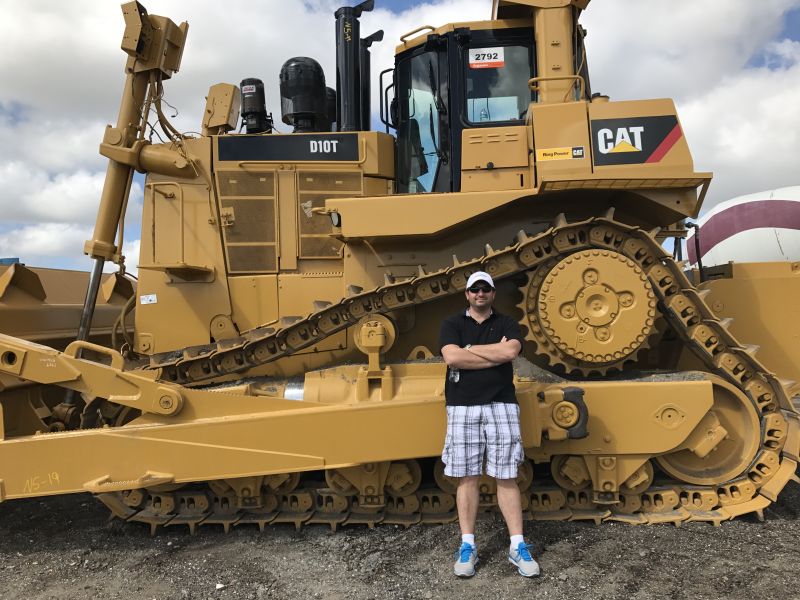

This is what I prefer to use.

Driven a few D10s, it works but it boring! Put blade down, clear path, clean up, done! Now, that forest cutter looks like fun!

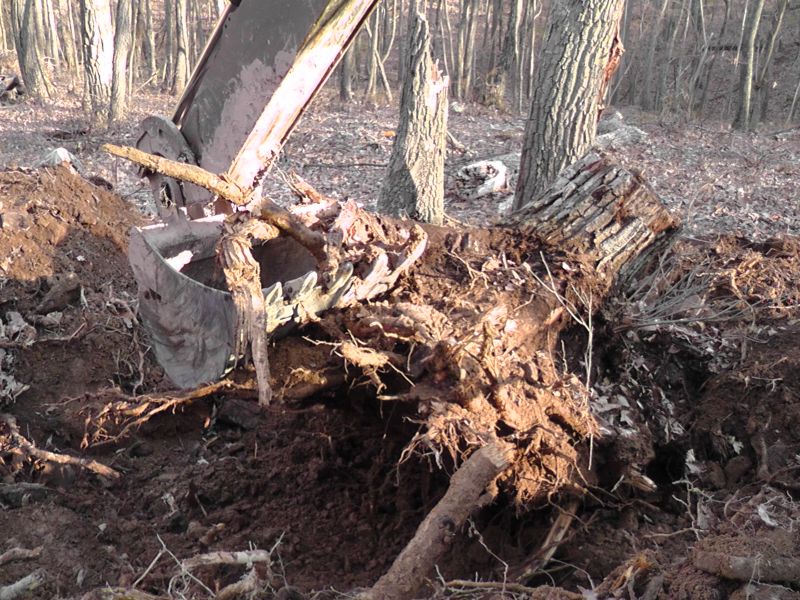

Good ol' Virginia stumps. Wish I had a buck for every one I've dug out.

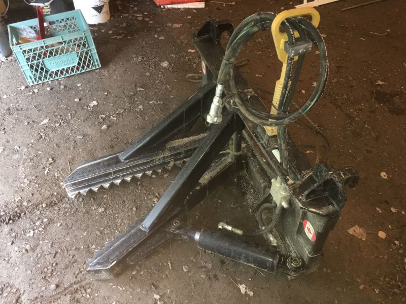

Put one of these on the front of a tractor. I use mine on the front of a New Holland Boomer. Easily takes care of up to 5" poplar, rips the roots right out.

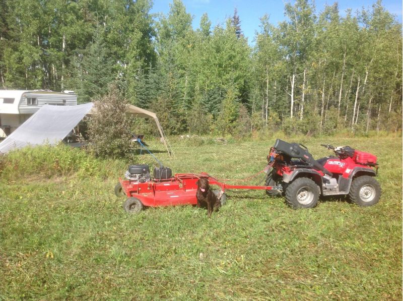

Tyndra,
I should have read your post a bit more carefully. I used to own a Swisher 54" rough cut trail mower that had an 18hp engine. I pulled it around with a Honda quad. That mower was advertised to be able to handle 2" saplings. It could if you went slow. I used it to clean up a bunch of older trails scattered around our 1/2 section. I started out with the mower deck at its highest setting which was about 6". Went over the trails 3 times lowering the deck with each pass. The blades were pretty dull and rounded over by then, this left a shattered stem that certainly wouldn't puncture a tire that was in good condition. Mowers of this type are not inexpensive and do require a lot of maintenance. The one I had was $3800 when I bought it 6 years ago. Just sold it a month ago for $1700.

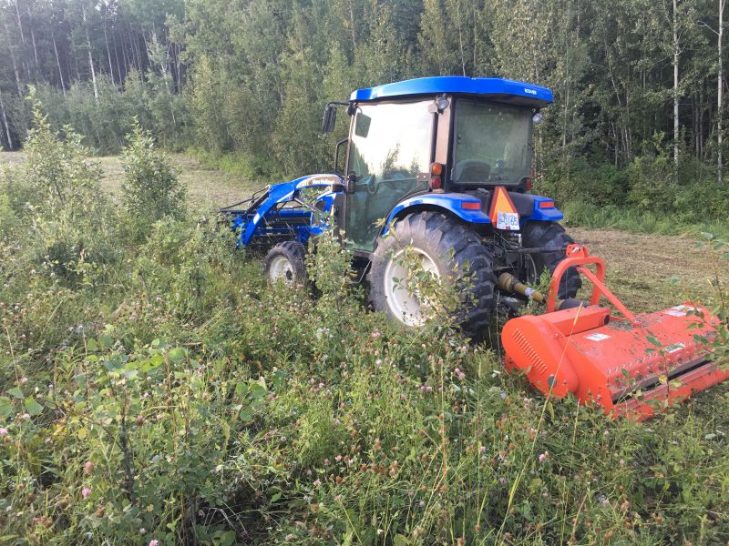

This is what I'm using now, to maintain my trails and fields.
