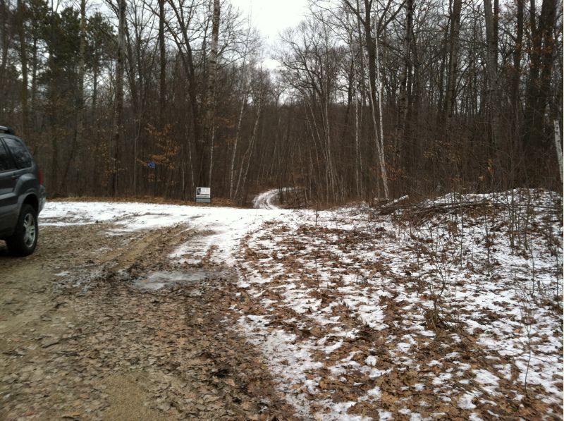

Hey
My cabin is on a private road....and Im the only property on that loop....so I need to try to keep it up enough to drive it on a regular basis.
I knew this before I purchased the property...thought no big deal.
Problem is...I didnt expect to have so much rain this spring...snow was minimal (MN).
Plus now the trucks and ATVs like my road for doing their 4 wheeling...its more challenging than the smooth roads everywhere else. I now have puddles and low muddy spots...fairly remote..dump truck wont fit to dump gravel.
Ive been looking for a drag or harrow....to pull with my truck. Ive seen the farm harrows...with spikes, but im not sure this is what would work for me.
Plus a way to drag one off to one side....to get the edges of the road without driving in the sticks...or downed trees....these drags are usually only about 5ft wide.
Ive been looking at any object I could use as a drag also
Any expertise or good ideas appreciated!
Thanks
Murph

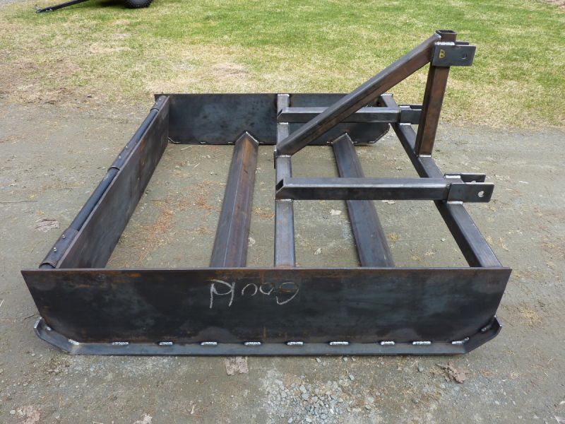

The best thing is a tractor with a 3 pt hitch and a grading scraper, or land plane. This is designed to level out the road.

I'm at the end of almost 4km of clay road that used to be maintained by an oil/gas company. They shut the wells in a few years back, so if I want it maintained I have to do it. I use a land plane similar to the one in the photo. You need a tractor with a 3 point hitch to use it. It usually takes me 2-3 hours a few times a summer. There are all sorts of things people have hobbled together that don't require a tractor. Some with varying degrees of success.
The land plane also doesn't require a great deal of experience to start getting good results.
