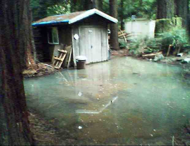

Should have taken a photo yesterday while I was there..
I have a 6 inch culvert pipe going under my road that is supposed to keep my shed from flooding, and never does. Yesterday I dug a big hole under and around the pipe entrance, that should take care of dirt and stuff, but what happens is floating branches and redwood duff clogs the entrance. Wondering what type of grate and how to situate it so it doesn't plug up.
Here is the shed. The culvert is just off to the right a few feet.

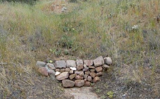

A check dam can be simple or engineered. What you are trying to do is slow down the energy of the water. Doing so will allow the silt, sediment and debris to settle before nearing your culvert. I have used rocks, straw bales or even vegetation as check dams.
If you google search check dams or erosian control devices it will give you an ideal on what you can do using items available locally.
Just mentioned screening the inflow end of the culvert and Greenland South mentioned increasing the size of the pipe. I would do both if it was me.

OK thanks, sounds like a great idea. I think the pipe might be 8" fwiw but no bigger. It runs diagonal to the dirt road it goes under and probably 30 ft. long, hate to dig it up. Anyway I think I'll try something like this.
