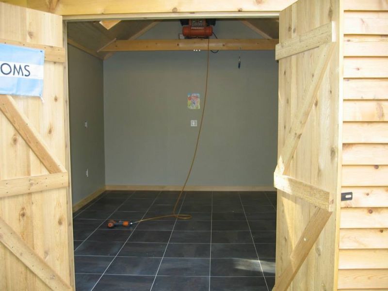

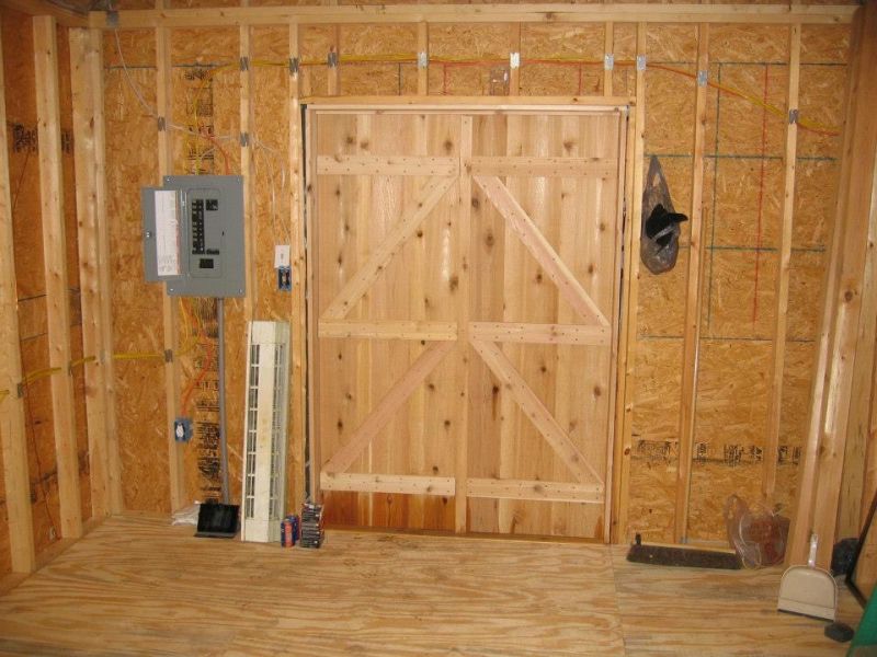

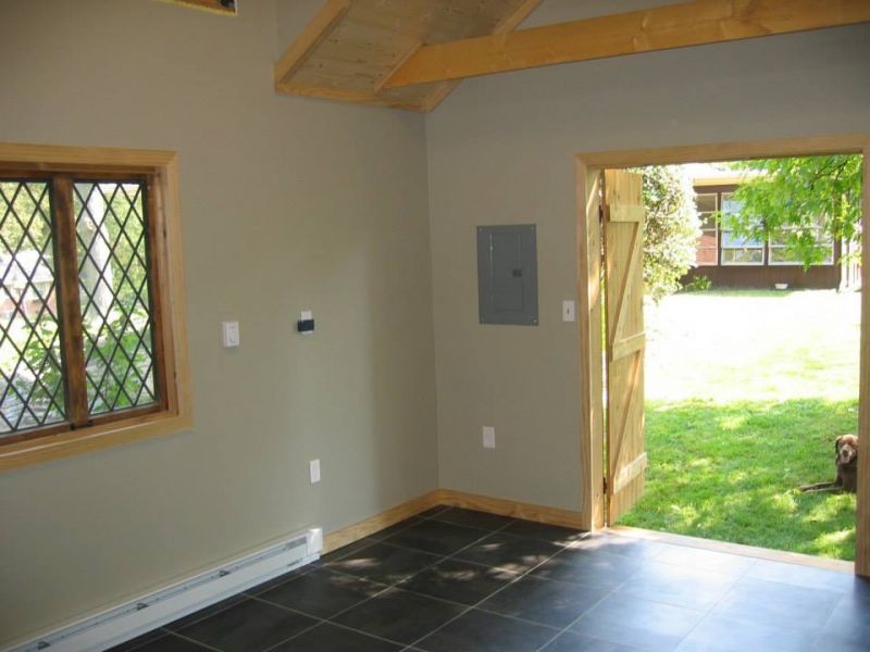

In 2013 It cost me $703.63 to do the electrical in my 192 sq ft shed. The interior finishing cost me $1,527.20. This is material only. There was no plumbing. I tracked all costs to the cent (former cost estimator). I’d add 2-3 % per year to account for inflation.
Mike 870
# Posted: 28 Jan 2018 08:26am
This is the shed.
# Posted: 28 Jan 2018 12:15pm
Mike, it may be a shed, but its perfect practice for a real living quarters. It looks like you dont need any more practice though.
