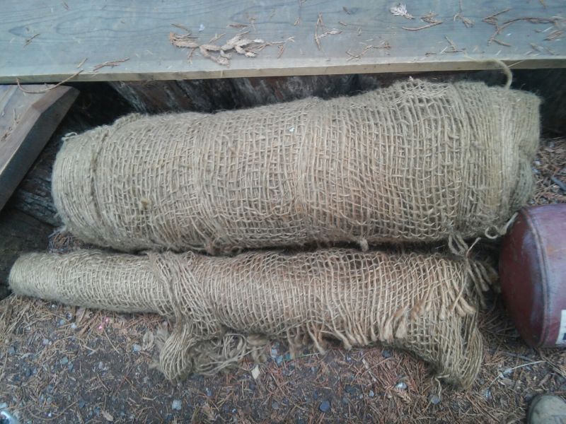

# Posted: 9 Nov 2018 05:51pm
I bought some pipe yesterday and the guy also sold me a roll and bit of this burlap. I keyed my hillside in a couple of places, fairly steep slopes, so I thought this would be a good idea to prevent a slide over the winter if we get substantial rain.
Anyone experienced with this? Do you roll it out horizontally or vertically on the hillside? Stake it in?

# Posted: 17 May 2021 04:50pm
Roll it downhill, stake it. And if cool/wet weather might continue, throw some cheap seed on it. That seed will take hold, give better grip for the burlap. Have a great outdoor season!
Irrigation Guy
# Posted: 17 May 2021 06:19pm
That is jute mat, it works well for hills. Like frank said throw some seed on it and use sod staples to pin it down every few feet.
# Posted: 17 May 2021 06:25pm
That looks like about 4hrs of trying to clean that out from under a mowing deck to me.
Dont use cheap seed. It's got to much rye grass in it. That stuff comes up in 2 days and is dead never to be need again in a few months. It's most of the ingredients in contractor grade junk seed.

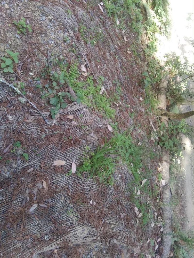

# Posted: 23 May 2021 01:49pm
Quoting: KinAlberta It’s been a few years so maybe paulz can post an update on how it worked out.
Yep. Well that fabric got a bunch of dirt dropped on top of it when I was widening my road. I ended up pulling it all up and disposing.
But, two winters ago I put some down in another spot because my neighbor was worried about sliding. Here is what it looks like right now.
