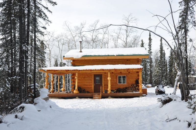

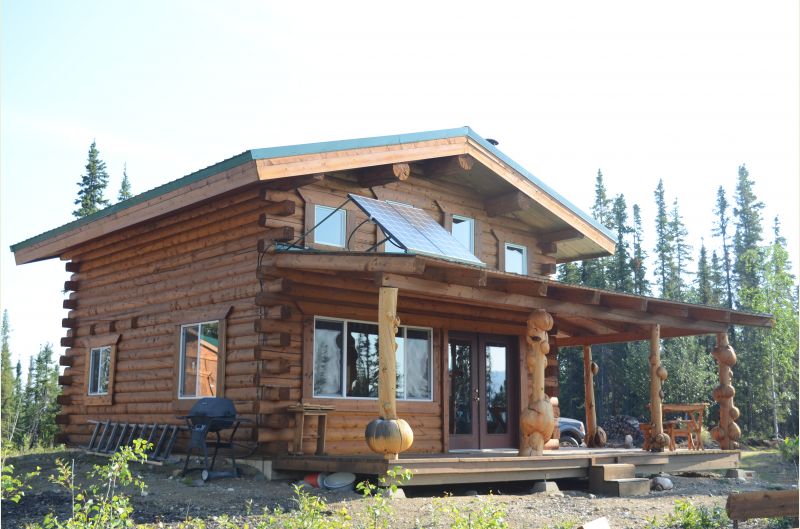

I've posted here a bit as Badgers Hollow. I have 5 acres with a bunkhouse by Crater Lake, OR. I have mentioned that getting into remote and recreational property has led me into a journey of buying, fixing, and flipping little parcels. I was able to pay cash for 5 acres near Dot Lake, AK last winter. I worked the ground, improved access and the view over the summer, and now have sold it.
This sale has led me to the end game in terms of flipping to a forever cabin in the same area. 16 acres, 720 square foot log cabin with solar. There's no well, so I have to haul water in. But, this seems to be the norm for cabin life below zero. I'll have views of the Alaska range. It's the culmination of labor and effort to achieve a dream.

Wow, fantastic, get good fire break and that place will last a lifetime and beyond. Nice work

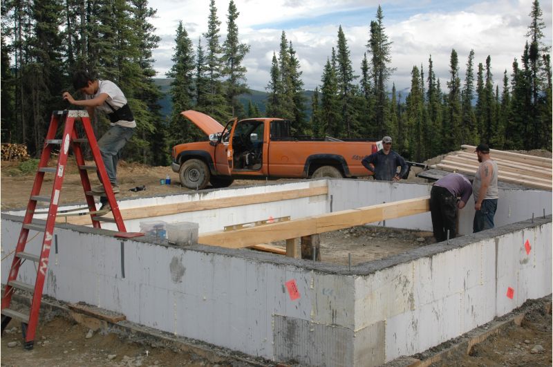

In our area here in CO.... where it do get cold (2* F as I write this!) most places have put their water tanks under the home.... they use the same foam forms it appears you did... and they find it never gets below 32*, and usually never below about 45* under there so water doesn't freeze. Like you, we all haul water from a community spring, most haul in 55 - 125 gallon tanks and pump through a pipe coming from the under cabin tank to the outside. Works quite well. They do not insulate under the floors so heat can transfer through to under the cabin. That said one neighbor here claims his under cabin temps even without heat in the cabin do not drop below freezing because of being dug in below frost line... so earth heat.
Our place unfortunately is on piers with just a sheet metal skirting. We put a 50 gallon tank in the loft and pump from 7 gallon totes up to that tank with a Shurflo pump. As I said in a separate post we are going go revise this and use a 55 gallon barrel next year on a sled and pump from outside up to our tanks (adding another 55 gallon tank for toilet and hot water.)
If you didn't put a tank under the cabin.... dang! Missed opportunity!

Oh, and pretty nice place. Love the burl posts.
