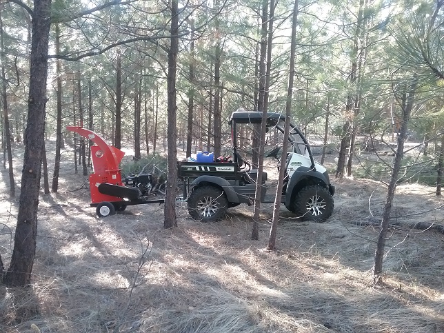

Justin, how big are the trees, ie diameter. I bought one of those DR tow behind chippers, the 16.0 model, I didn't make it road legal, I only tow it around on the property and this thing is a beast, I got the extended chute for it too, it chewed up the wood and made a gorgeous pile of chips a gardener would love to have. With 4 acres and you nibbling at it, t is might work. But you need a quad or side by side or truck to move it around. Drop tree, chip up all branches, leave main truck for sale, firewood etc.
16.5 tow behind chipper

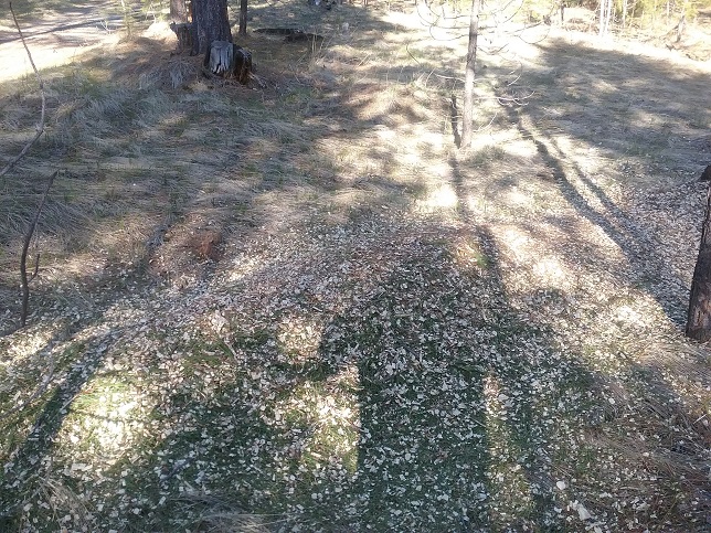

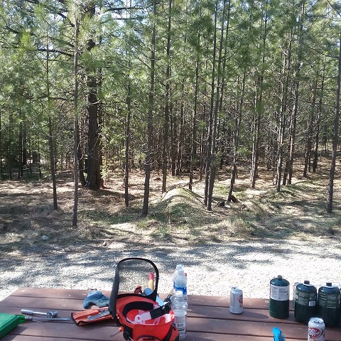

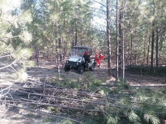

OK, what I did was to cut down loads of the smaller saplings, laid them all in piles, butt ends all at one end, then drug the DR chipper around to each pile and it chewed through them so fast, I was running up to 4" stuff.
I had 2 guys ahead of me cutting and stacking and I kept up with them. The chips are large 3/4" square, pretty thin, smelled so good. Chewed through in a minute
|  tow behind Mule
|  Chip pile (close up)
|  another chip pile
