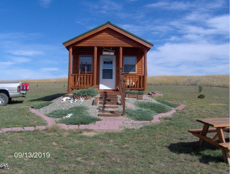

My cabin is in rural Eastern Montana. Put up a dry cabin, outhouse no permits and no inspections. You can pretty much do anything you want in MT. The key is to stay away from resort towns, and any of the bigger towns in MT. Get as far away from people as possible and your good. No people, nobody cares.

redneckpaul - looks great! Congrats on that cabin. Did you ask nearby cities if one was required or did you just assume no one would care? If it’s officially not required that’s good to know. Thanks!

Bulltoad No you don`t need a permit in rural areas. But when you buy land, make sure your far enough away so that the city/people don`t come to you! A neighbor moves close by and doesn`t like your off grid house/outhouse or whatever and then it becomes a problem. Good luck and I hope everything works out for you!
