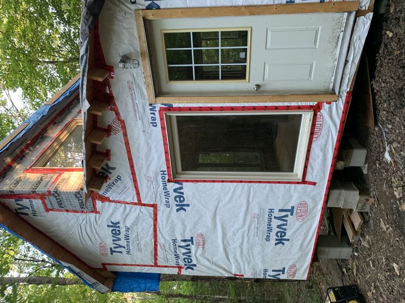

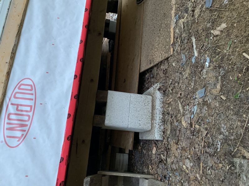

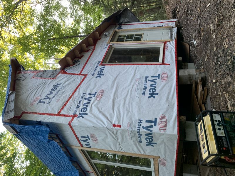

Hello, first time user. I just bought 2.12acres land by Huntsville. Previous owner had built a 16 by 16 cabin...it’s 3/4 complete. He didn’t get a permit for it, and I am wondering if I need to or not. The cabin is sitting atop or on cement blocks and level. It doesn’t appear to be touching the ground. Would this have been done as this may avoid the need for a permit? And if I do need a permit, how are they with pre-existing builds when a new owner buys land? I really don’t want to have to tear the cabin down. I’m going to try to attach a picture.....thx in advance. Any info would be appreciated.

# Posted: 11 Aug 2020 06:29am
You will need a permit in Huntsville area. Contact the local building department. Being proactive might make the process go a bit smoother. Keep us posted!

jsahara24
# Posted: 11 Aug 2020 01:25pm
It completely depends on your local laws/inspectors. Where my cabin is that design would be fine, other places it would require a sealed drawing to support it.
What is the pulse of your area? What do you see from other properties? Can you see the cabin from the road?
Really you have two options as far as I can see it. Decide if you are willing to put money into the cabin while risking potentially getting caught without a permit, and pleading ignorance if you do and hoping for the best.
Or bite the bullet and go thru whatever formal process the municipality/county has in place to get it permitted. Hopefully it would go as you described above, but I work in an area where they would most certainly make you remove it, and my cabin is in a place where they would be amazed you reported yourself and would definitely work with you. So its hard to give advice without knowing what type of area you're in....
# Posted: 11 Aug 2020 01:26pm
Building on concrete blocks certainly does not negate permits. At least in Ontario
I wouldn’t count on an inspector being reasonable but certainly many are. Your only option is to call and start the discussion
