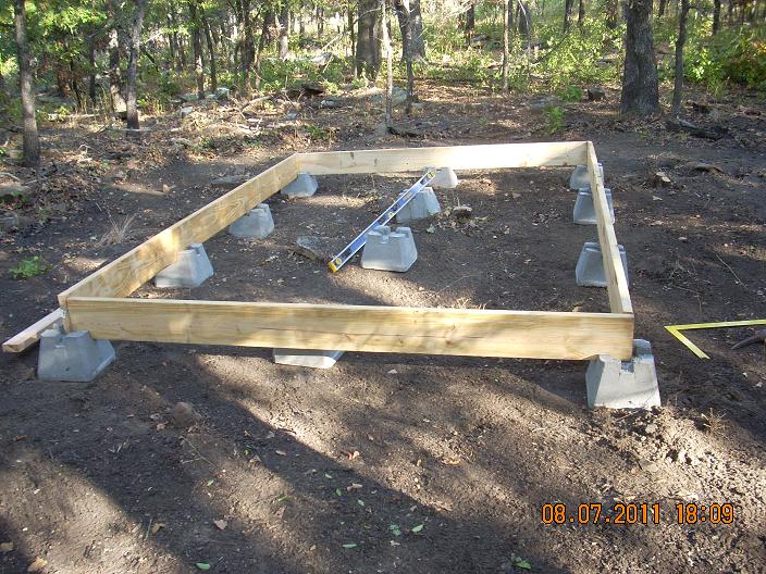

 The prefab panels are a great idea and they are as squared as a precut 4'x8' sheet of plywood can be. I won't say that I am not concerned with being perfectly square, but I am not overly worried since it is only a 8'x12' glorified tool shed. Like always, If the foundation/slab/floor/base is square, the rest will fall into place, and that is my goal.

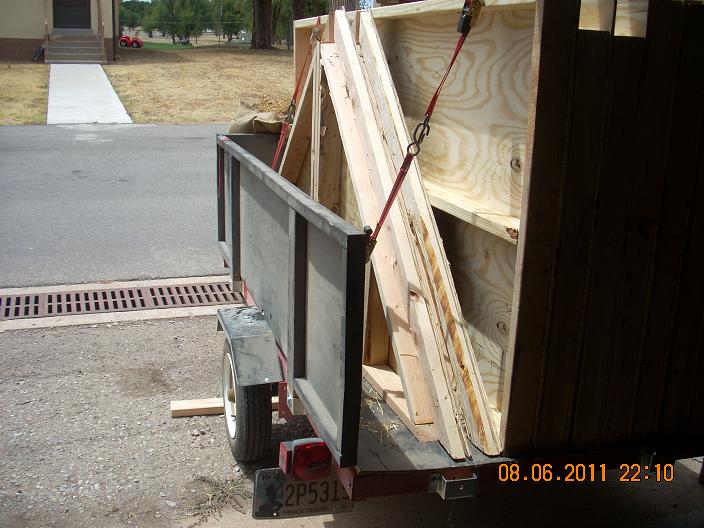

 | # Posted: 7 Aug 2011 02:18pm Reply

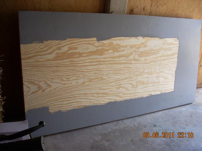

 I was able to clean up my garage some today, by loading up the wall sections for my new cabin in my trailer! I just have 2 panels left to built that will fit in my suburban. Looks like I am going to get some time to head up and get some work done this week afterall.
 --MikeW
 |  Front wall section for entry door.
 |  The panels are loaded in the trailer!

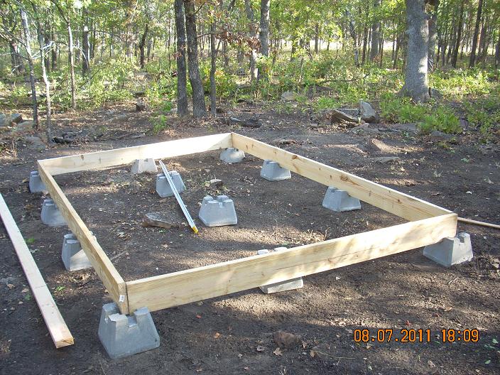

| unixfmike Member
 | # Posted: 8 Aug 2011 08:54pm Reply

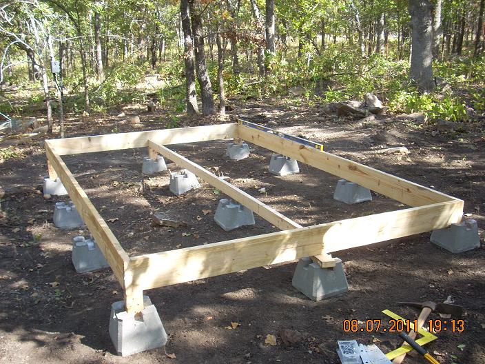

 Here is the start of the work!
 --MikeW
 |  The 128 degree reason to leave
 |  A rough layout of th build
 |  Getting the pieces aigned
 |  Getting a level floor

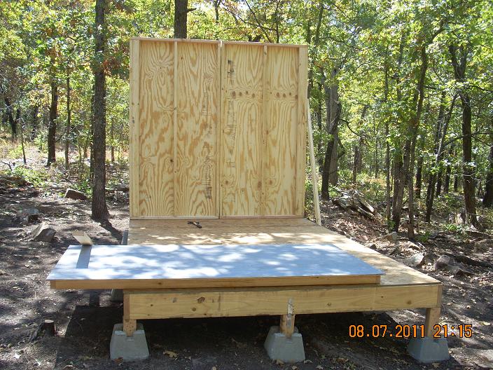

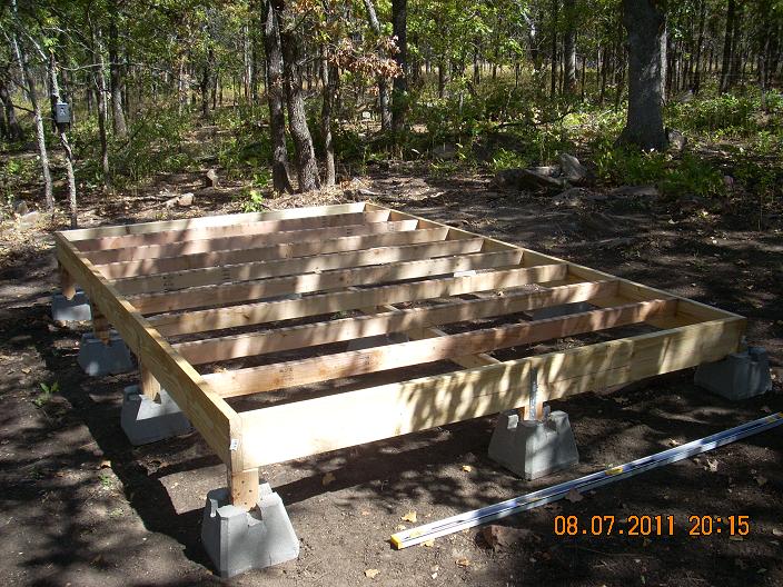

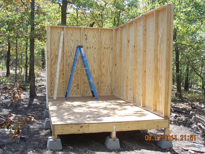

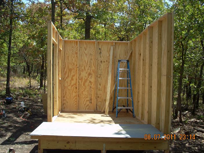

| unixfmike Member
 | # Posted: 8 Aug 2011 09:00pm Reply
 and a little more...
 --MikeW
 |  All the floor joists ready
 |  The south wall goes up
 |  There's the  west wall
 |  The east wall getting started.

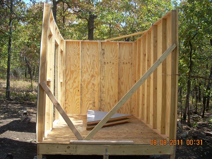

| unixfmike Member
 | # Posted: 8 Aug 2011 09:06pm Reply
 and more...
 --MikeW

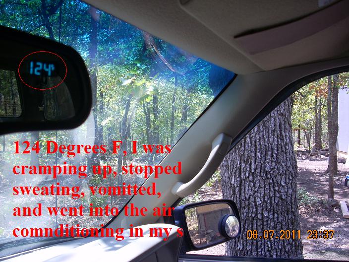

 |  124 degree retreat to suburban air comnditioning!

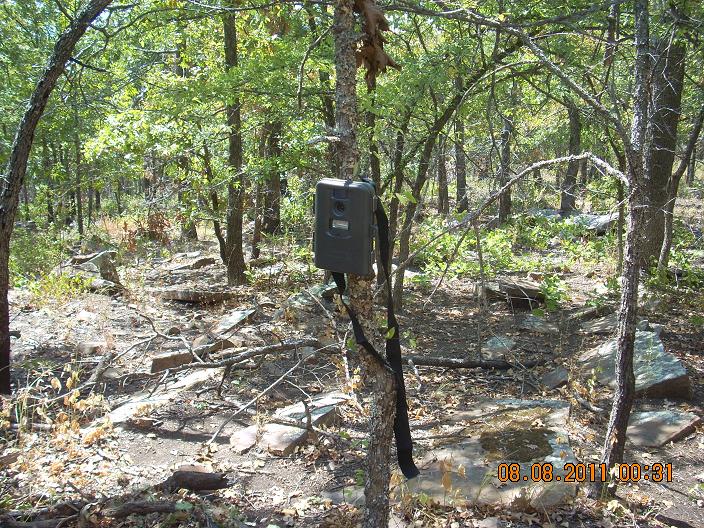

 |  Trail cameras make a great photographer while you work

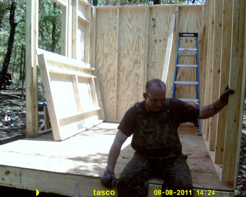

 I put all of the pictures of the trail cam together into a 4 min video of the days progress. Something happen with windows movie maker that destroyed the quality of the still pictures.
 I setup the trail cam to use low quality pictures, and to me they appear to be of better quality than most security cameras and in color.
 --MikeW
 |  A single still from the trail cam

 | # Posted: 8 Aug 2011 09:59pm Reply
 That picture of me sitting there was me getting ready to pass out from the heat. I was cramped up and had already vomited.  I'm glad the trail cam didnt catch that. I drank over 3 gallons of water today by myself. I was working continously since 6:00am, and left around 3:00pm after a full day of work.
 If your going to work in high heat alone, remember work and rest cycles. Make sure a friend or family member knows where and how to locate you. I am thankful for my wife calling to check up on me and that annoying cell phone and random remove service today!
 --MikeW

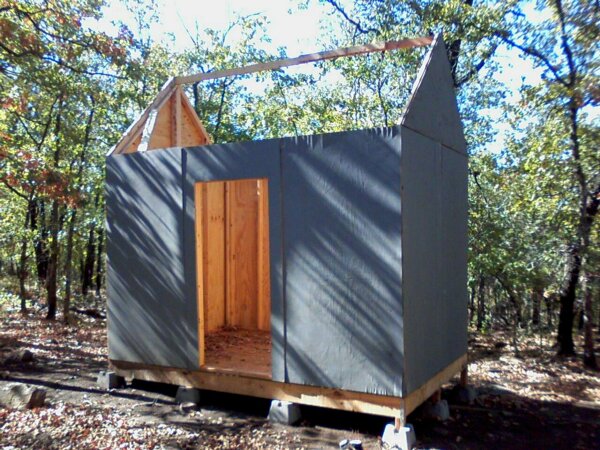

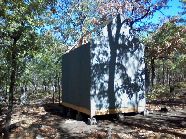

 | # Posted: 1 Oct 2011 06:55pm Reply

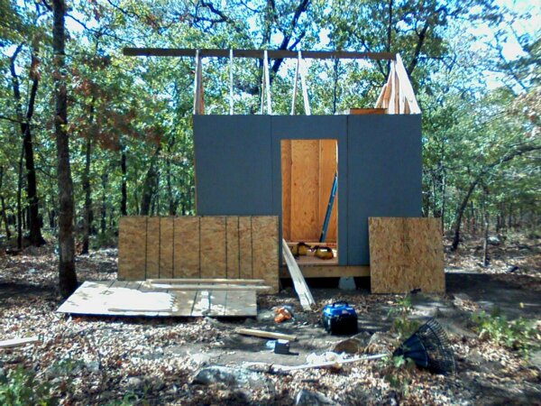

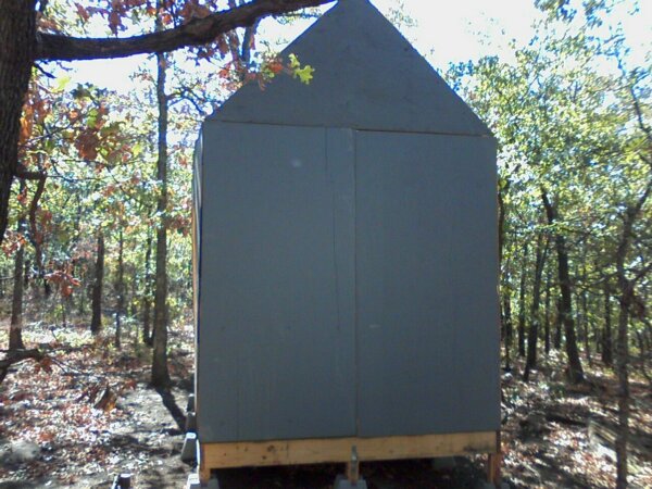

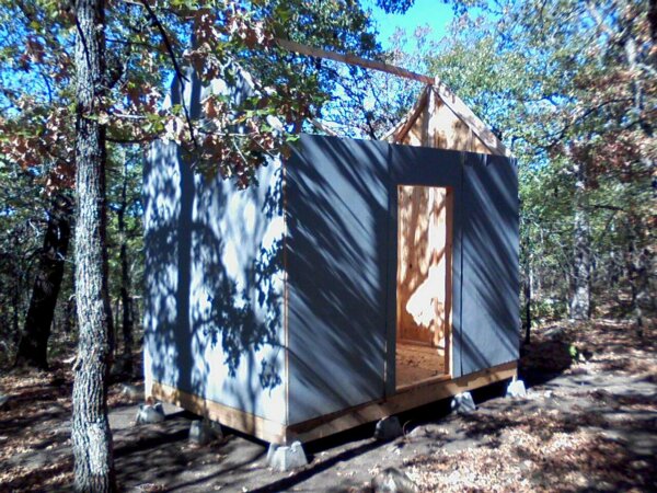

 Went up today in the mild warmth. After a complete walk of the property I stood the last exterior wall and put up my gables! Thank's to my buddy Chris for coming up to help with the lifting and for hanging out.
 That isnt the actual ridge beam. It is just a couple 2x4's used to space the gables until next weekend. This interlocking garage build is so awesome to stand in place.
 --MikeW

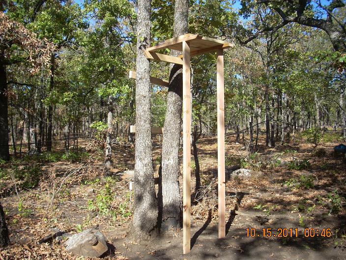

| unixfmike Member
 | # Posted: 15 Oct 2011 10:08pm Reply

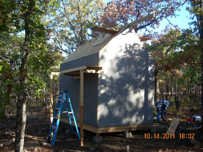

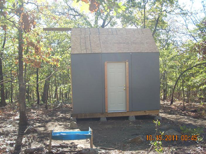

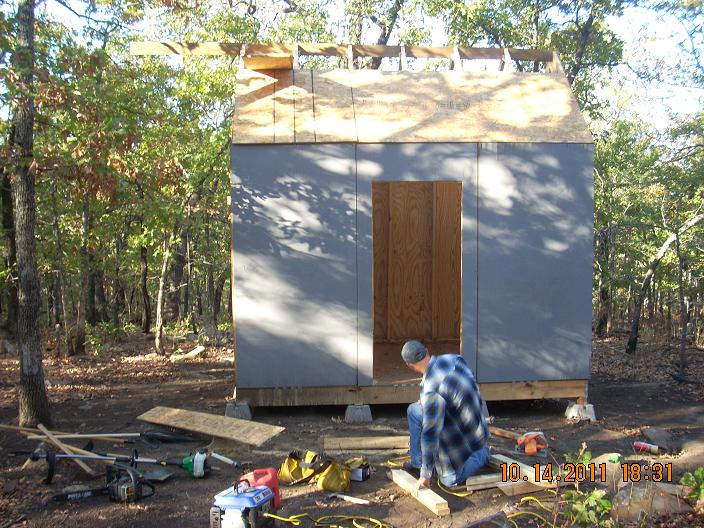

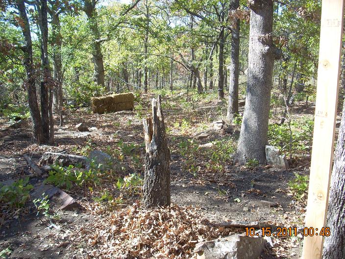

 I was able to get more done. My friend Tom helped me with the roof, door, and a tree stand to practice from. We also refreshed one of the two food plots from last year, and did a little walking untill we spooked a deer, then stalked it. We had to cut the stalking time short to get work done.
 --MikeW

 Thank you for the compliments. I m greatful for the Google SketchUp team who created a marvelous product. Everything you see in the picture (the walls, gables, subfloor, and roof) were able to be measured and cut off site, and then be assembled on site without needing measurements from the structure to continue. I was skeptical about doing this, and the only measurements I had to verify was the roof sheeting (out of my own fear). I ended up with a 1/8" variance on the roof sheeting from the SketchUp plans, the width of my sawblade. The subfloor posts could not be accurately cut off site because I did not know the specifics of the grade the building is on.
 My only modification from the plan was to extend te ridge beam 4 feet to the south to hang my gannon from for cleaning deer (if I ever shoot one of them, man they are fast). My intention is to go up this weekend, check my trail cam, check my food plot and corn troughs, and put some tin on that roof if I have my buddy Chris go up with me. I'm sticking to my rule of not going on a steep roof without someone to drag me out if I fall.
