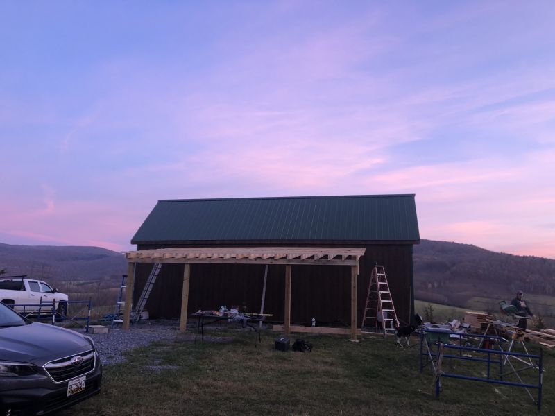

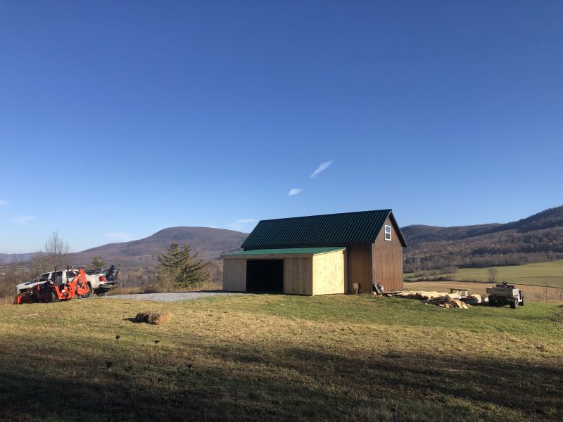

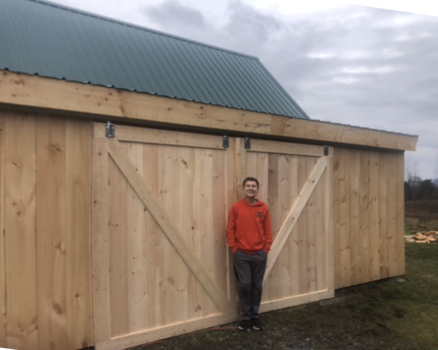

Took a long weekend and got this lean to built. Still need to do the battens and the doors but I was happy with what we got accomplished in three days.

Looks good...I'm looking to do something similar on the back of my barn and I was wondering if I could pull it off in a long weekend.
What size is it?

# Posted: 10 Nov 2020 09:13am
Nice. How many workers?

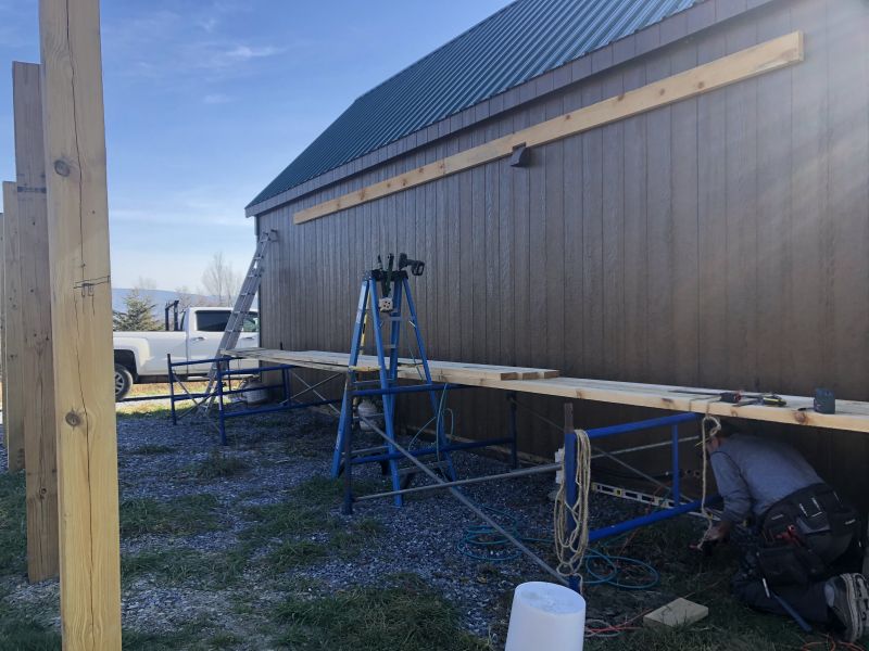

It is 12x24. I set the posts a month or so ago and got all the material on site. Then it was me and a buddy doing the bulk of it and my sister helped on and off handing us stuff, cutting insulation, and screwing in boards after we tacked them in place.

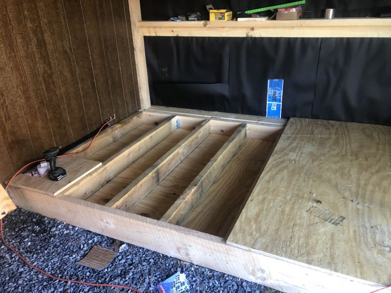

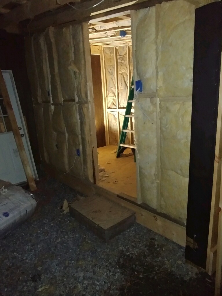

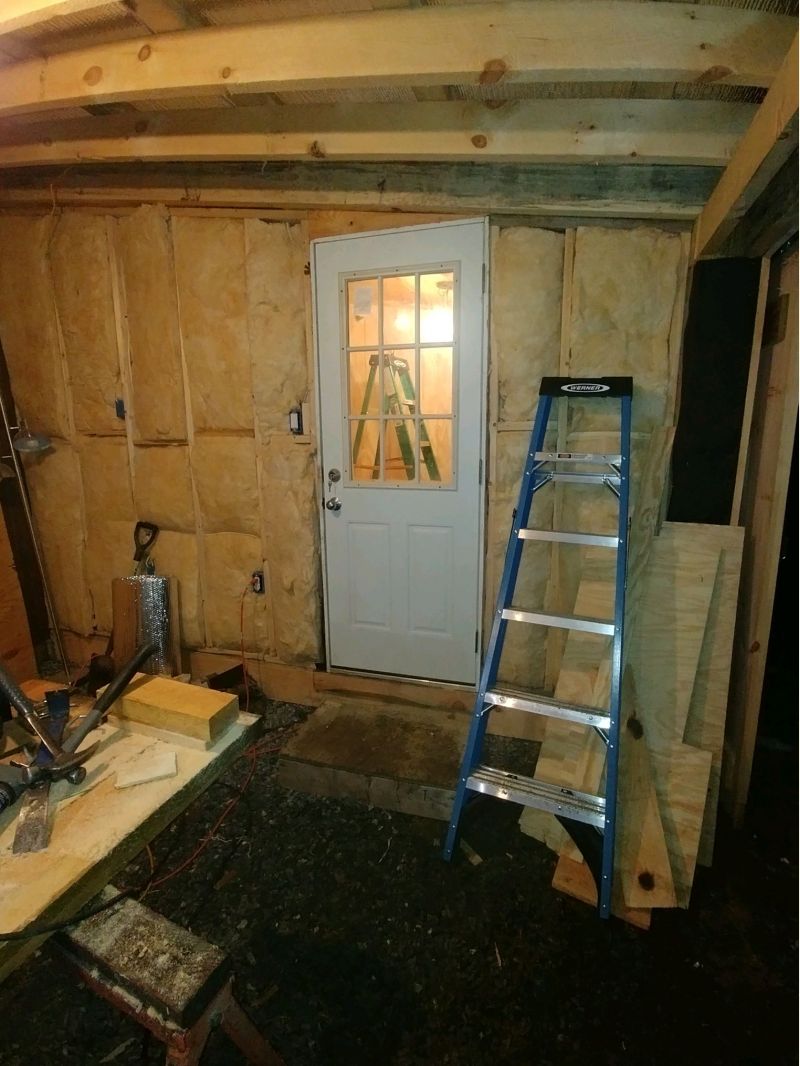

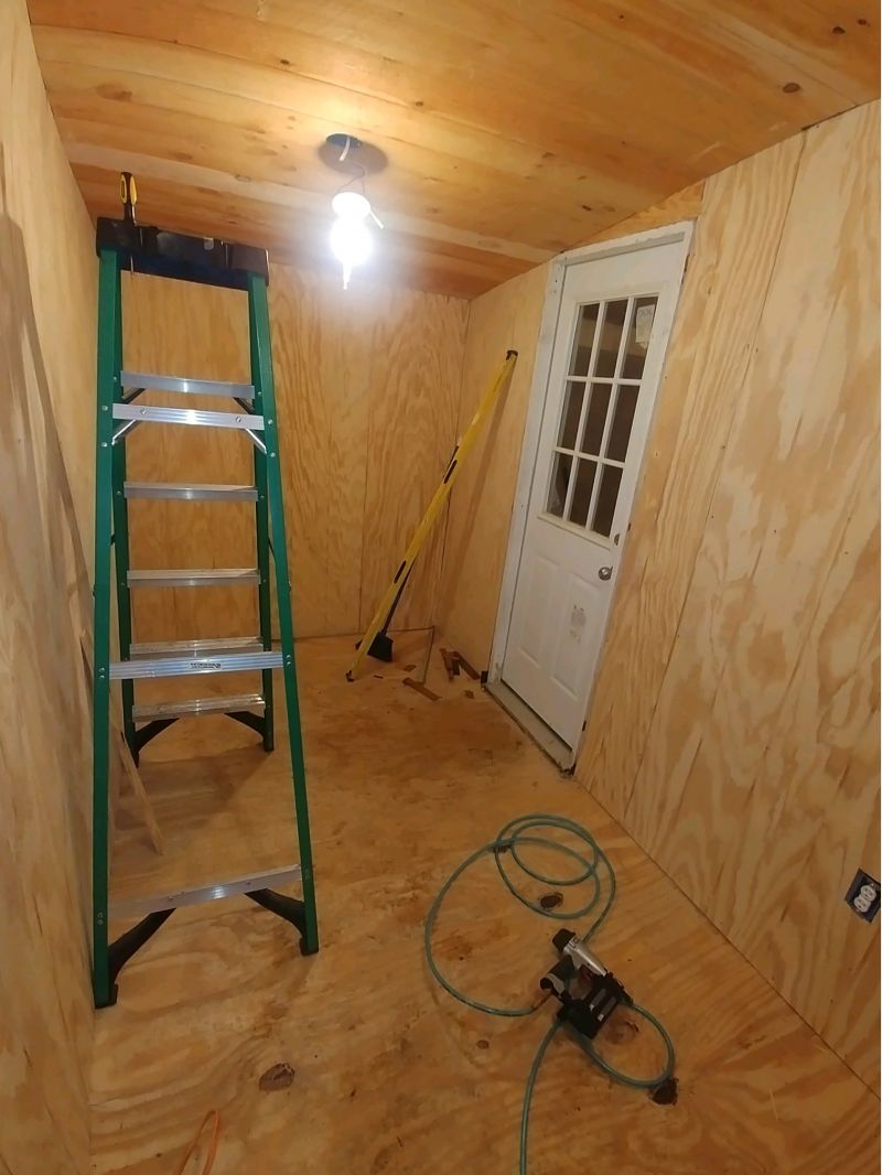

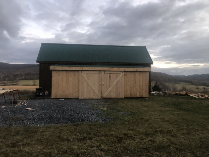

Back up this weekend to hang the doors and start on the utility closet.

# Posted: 18 Jan 2021 08:30pm

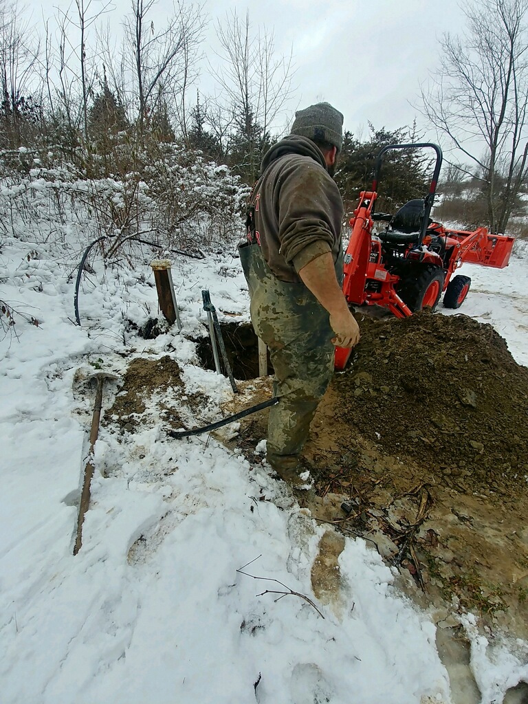

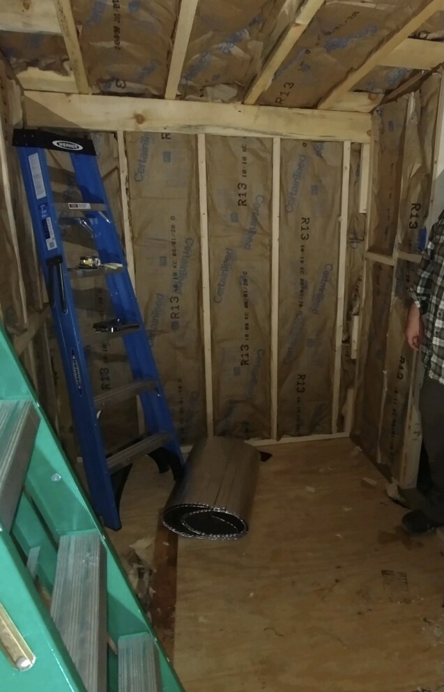

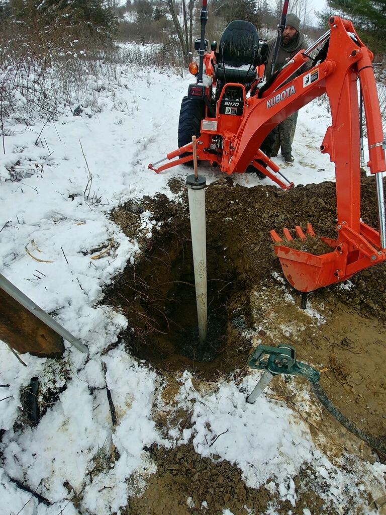

Spent a few days ant the cabin to work on the utility closet. Also added a curb stop valve to the well line to prevent the high static level in the well from pushing water up the pipe to the area where the pipe is not buried below the frost line.
Irrigation Guy
# Posted: 18 Jan 2021 08:31pm
Digging up the well line

# Posted: 19 Jan 2021 03:26pm
How are those curb stops to install? I thought about putting one in our water system in the future.

Thanks! I was on the fence about getting the backhoe because I have a mini excavator for work but having the hoe on-site when ever I need it breast towing the mini 4.5 hours.

# Posted: 19 Jan 2021 04:47pm
Quoting: Brettny
