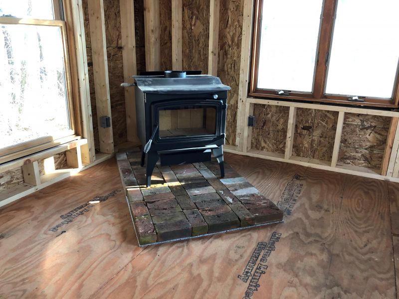

Sunday was a good weather day and I decided to change out the wood stove I had originally planned on using with one found on sale at Menards. I preferred having the glass front. Weather permitting, I'll move onto cutting the hole through the roof for the chimney.

Oops, here is a pic.
# Posted: 11 Jan 2021 11:11
Nice. I see we have the same interior decorator. ![](https://www.small-cabin.com/forum/img/smilies/grin.gif)
I also have, and like the glass door. I'm hoping this year with several cords of seasoned oak it will stay cleaner than the crap wood I scrape off my property.
# Posted: 11 Jan 2021 14:08
That stove base looks really good.
rpe
# Posted: 11 Jan 2021 14:13
Looks good! I'm just in the midst of replacing the glass in mine. Not sure why it cracked, but mid-trip last week, we noticed a crack top to bottom. Got new glass and gasket kits now. I really like the glass front. It adds ambience, and allows easy monitoring of what's going on inside the firebox!
# Posted: 11 Jan 2021 14:16
Mine is cracked too, I chalked it up to forcing it on a piece of wood but don't remember doing so.
Did you get a special piece of glass?

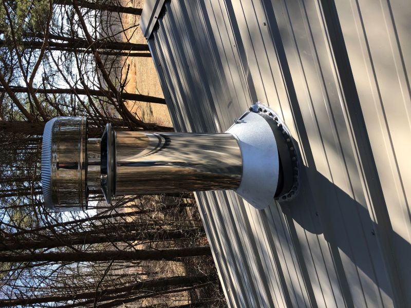

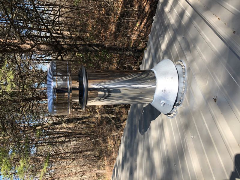

Finally got the chimney installed and hope to use the wood stove before the weather warms up.

Sorry. I tried to correct the orientation. I'm not sure why it rotated from the original.

You are in Ohio and subject to Snow and will likely use that stove in the cold weather with snow on the roof. I strongly suggest you install a Snowguard or Deflector for the Chimney Pipe. You would be surprised how much harm even 4" of snow-ice can cause when sliding down.
Google images for "Chimney Snow Guard". Believe me when I say it is a smart thing to add to ANY roof that gets snowed on.
Attached is a DIY design I was provided by SuperVent.
willywilly2020
# Posted: 11 Mar 2021 18:00
Okay so I literally messed this up last year - you can learn from my failure! I did just what you did, and a the first decent snow load ripped open my metal boot, and pulled my whole chimney awry. Woodstove lifted off the floor and all! I was lucky the whole thing didn't come down and that I didn't burn down my cabin.
I had to ski in a bunch of supplies and do a painful repair of the boot before I could install the braces. It was not fun.
I installed these chimney support braces: https://www.northlineexpress.com/5-to-8-dia-adjustable-roof-guys-kit-jurgk-1-5478.htm l?utm_source=googlepepla&utm_medium=adwords&id=&gclid=Cj0KCQiAnKeCBhDPARIsAFDTLTJwqqq c2aE16O3Av-eqxGlt0KBg4KLJfgDTBhRPIErcO1l_uBAln6MaAmaBEALw_wcB.
They've carried me through the past three months of epic snow, and maybe next year I'll install a diverter/cricket. There are a bunch of brands out there, you can just ask the woodstove store folks for their recommendations.
