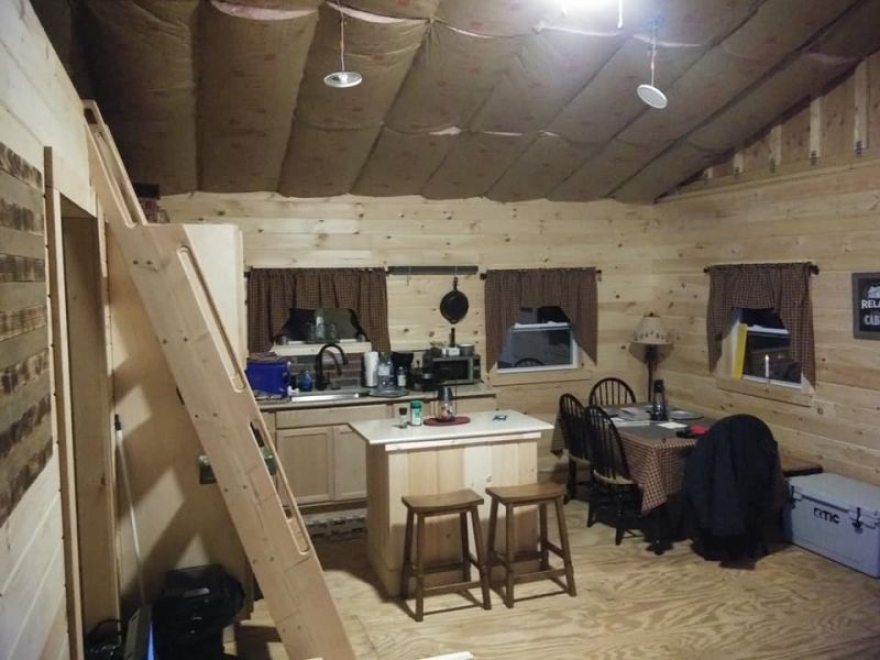

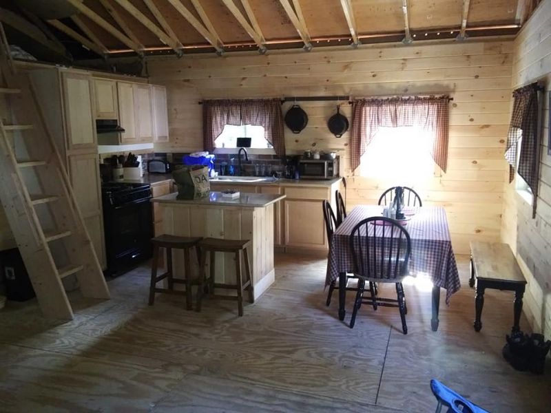

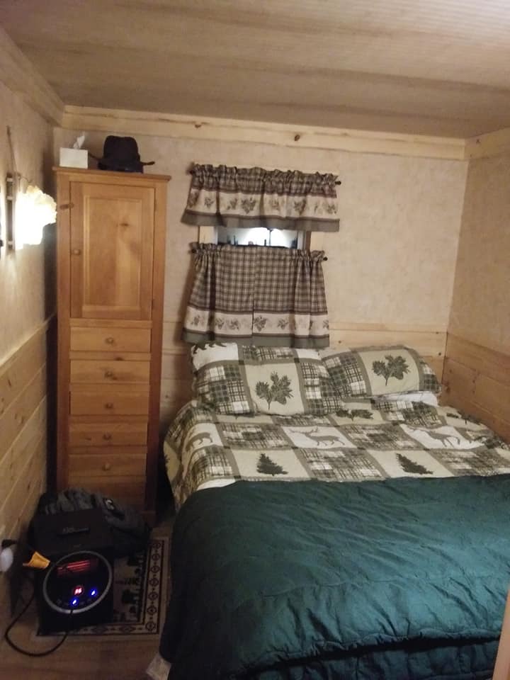

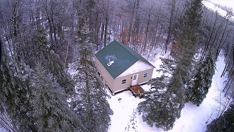

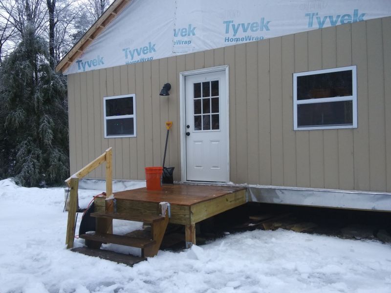

Haven't posted in a while. Cabin is coming a long great. 24x24 3 rooms and a loft. Slowed down the build during the winter. The question I have now is flooring. I wanted to put down wide plank flooring. But my sub-floor is not as flat as it should be. lol So thinking of putting down some water proof Vinyl Flooring. Or even glued down flooring to roll with my uneven floor. (I am not trying to fix the subfloor.) But as of now I am using the cabin only on the weekends. So being off grid there is no heat. What (if any) flooring is best for a uncontrolled heating and cooling environment? Thanks all. Here some pictures of the cabin as of now. Want to see how I built it? You can subscribe to my You tube channel.

I have had really good luck with $1.10 sqft flooring from a place called Ollies. I have had it in a rental house for 9yrs and looks damn good still. I used it 1yr ago on my unheated back porch with no foam underlayment. Its click lock flooring right on the sub floor. I dont like the squishy feeling of foam under the floor.
Are you getting some buckling where the subflooring sheets meet? Could you belt sand it down a bit?
The place looks great by the way. What pitch is the roof? Does snow stay on it?
# Posted: 15 Jan 2021 10:49am
Fwiw, my place, sc WI, has a 5 1/2:12 pitch metal roof and snow doesn't stay long on it.
Nickels
# Posted: 15 Jan 2021 12:07pm - Edited by: Nickels

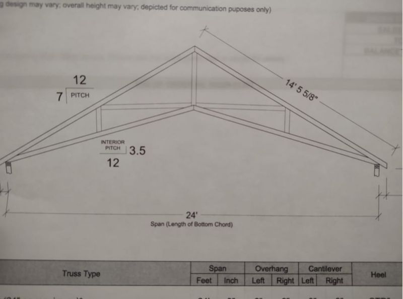

7/12 and it sheds snow great. Thanks for the information. No buckling just the center beam is up a little further then the others. Slight rise to the center of the cabin.

# Posted: 15 Jan 2021 12:17pm
Scissor trusses...those give you lots of head room and room for insulation.

# Posted: 15 Jan 2021 03:25pm
They sure do. Spring when I put the pine on the ceiling and skirting around the cabin. IM sure it will also make a big difference. This year we get the stove cranking and the cabin has reach 70degrees.

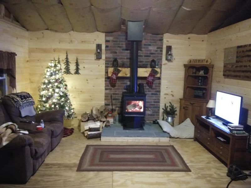

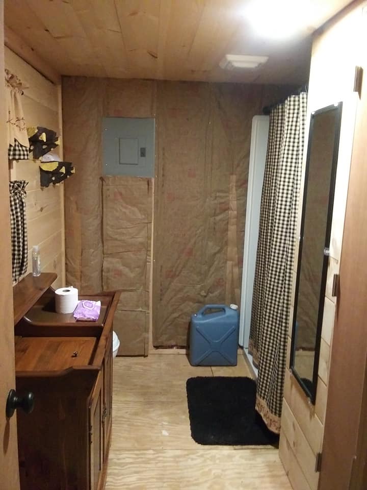

# Posted: 15 Jan 2021 03:33pm - Edited by: Nickels
Few more pictures.
