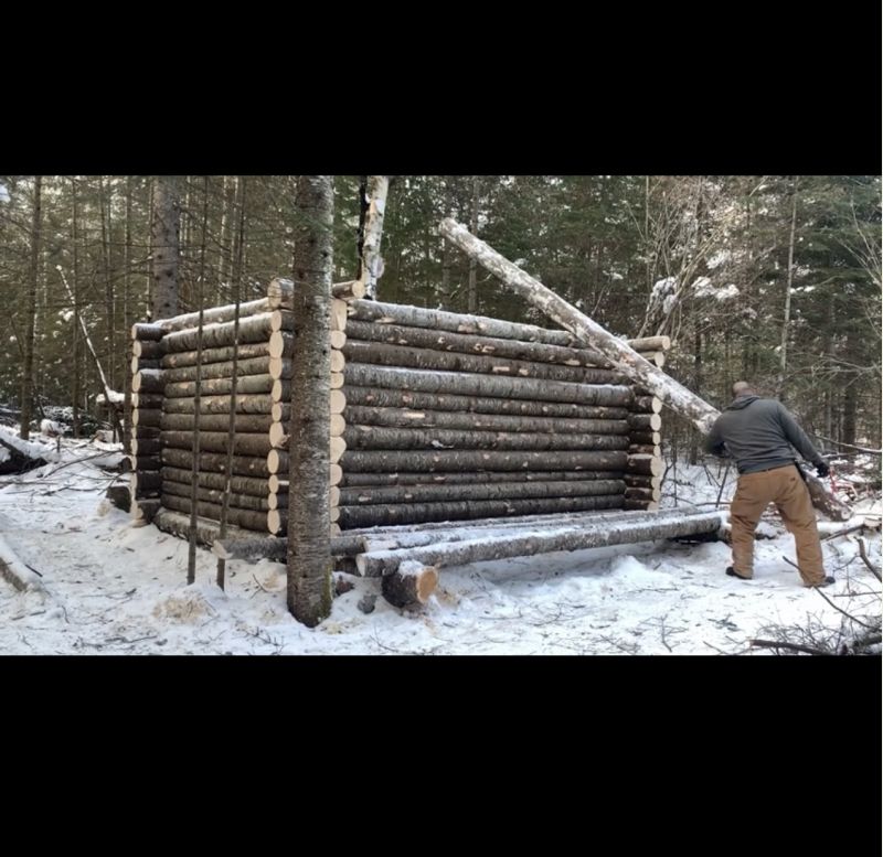

Hi Everyone,
I’m new here and currently building a small 12x14’ (including enclosed porch) cabin. All out of logs. All frame and structure (roof and floor) free hand milled with a chainsaw. I would like to post pics of my build for feedback and discussion.
Strong and Free

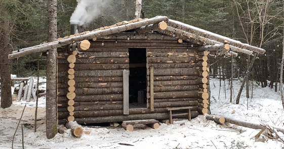

# Posted: 3 Mar 2021 08:01pm
This is the cabin
Cabin
Cabin

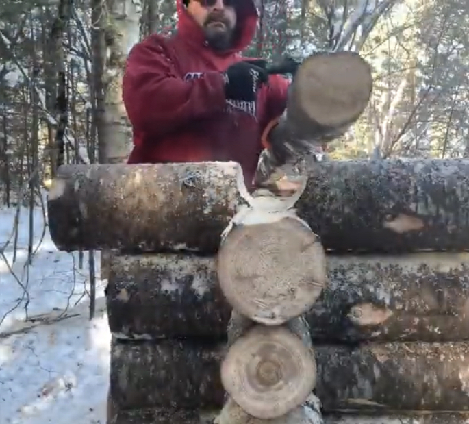

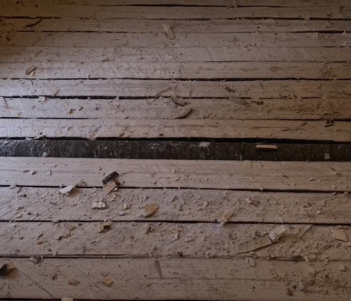

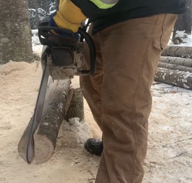

# Posted: 3 Mar 2021 08:07pm
This I how I free hand milled the floor planks
Free hand milling
Free hand milling
Floor planks
Floor planks

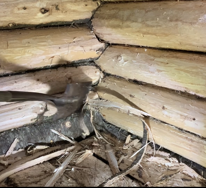

Strong and Free
# Posted: 3 Mar 2021 08:12pm
I just finished peeling the inside yesterday. On my next trip out to site I’ll be installing windows.
Last time I peel after building

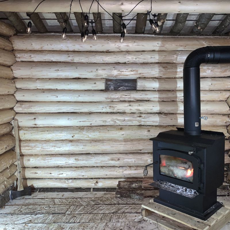

# Posted: 3 Mar 2021 08:16pm
Waayyy Kool!
Keep posting up, Im following
Btw, bet your stove would draft better if you got the stack up higher.
Strong and Free

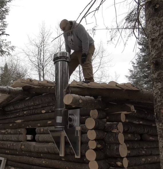

# Posted: 3 Mar 2021 08:26pm
Hi gcrank1,
Right on! I agree about the chimney I’ll be adding another section once I put the tin on (so I can bolt supports on top).
Short stack
Short stack

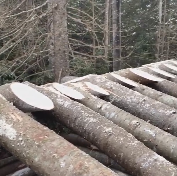

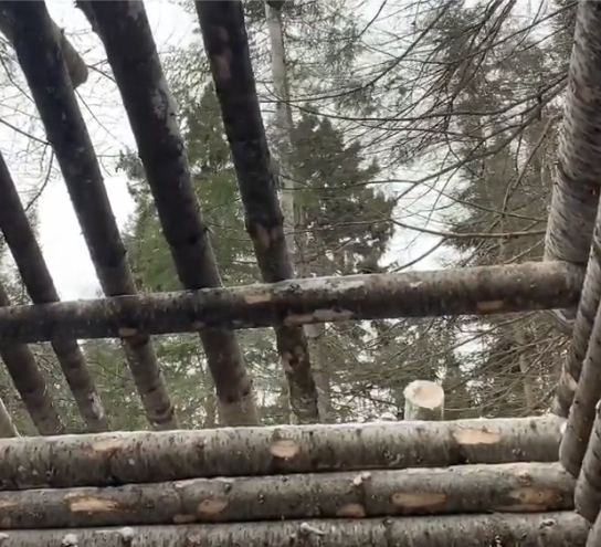

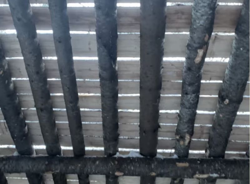

# Posted: 3 Mar 2021 08:35pm
Looking up you can see the bottoms of the half milled logs that I will strap and cover with tin. I plan to mill 2” thick planks for a ceiling in the hopes that will work as a thermal barrier to prevent condensation. This one I think might be a stretch anyone have experience with something like this I’m all ears?
Purlin, rafters, half log planks
Strong and Free
# Posted: 3 Mar 2021 08:38pm - Edited by: Strong and Free
Here is a pic of how I peeled the logs

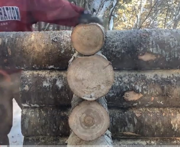

Strong and Free
# Posted: 3 Mar 2021 09:18pm
Thanks Irrigation Guy,
I’m also using an upside down saddle notch. I have found it faster to make and since I will have 3’ overhangs and wraparound covered walkway no rain will get the chance to seep into the (wrong way) notches.

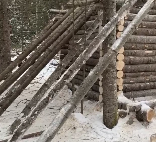

# Posted: 4 Mar 2021 05:39pm - Edited by: Strong and Free
That’s a great perspective. I think I’m an addict though. I’m not finished building this one and I’m already planning the next one.
Here are some pics that detail the rafters. Instead of butting the ends together I just staggered them. Wherever they aren’t square I’ll make sure the strapping is.

# Posted: 7 Mar 2021 02:55pm
You have a steady hand on that chain saw to be able to free hand boards. Great job.
Strong and Free
# Posted: 8 Mar 2021 06:34am
Thanks Bob,
They are far from perfect but it is pretty cool to be walking around on them now.
