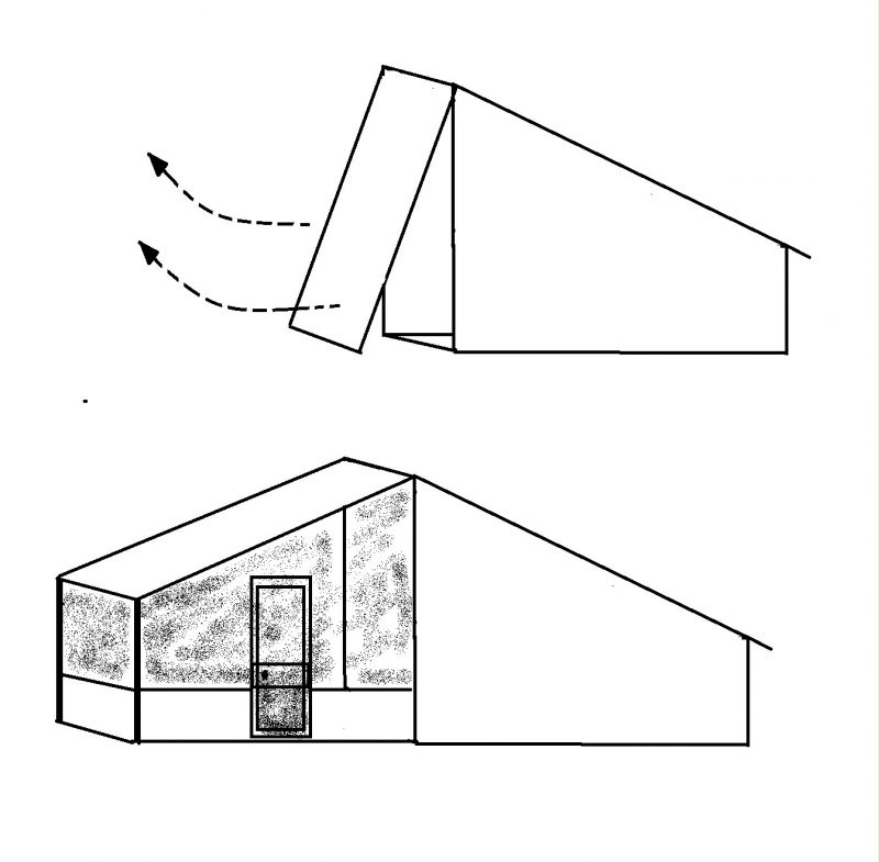

If economy, simplicity and speed are considerations, a simple lean-to (one pitch shed) has been popular.

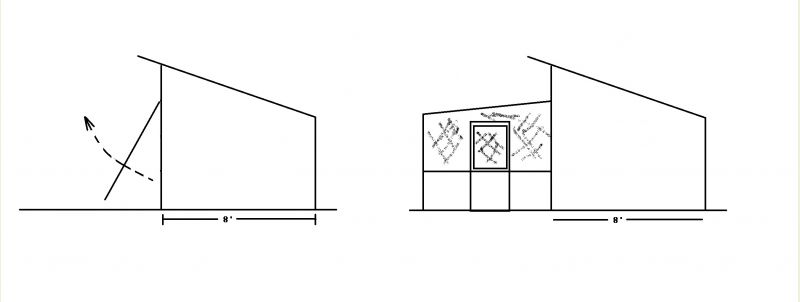

I've often considered a hinged wall for immediate duplication of space, and half walls with screen panels, and a rather secure lock up when not occupied.

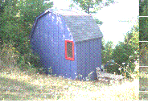

# Posted: 6 May 2011 01:52pm

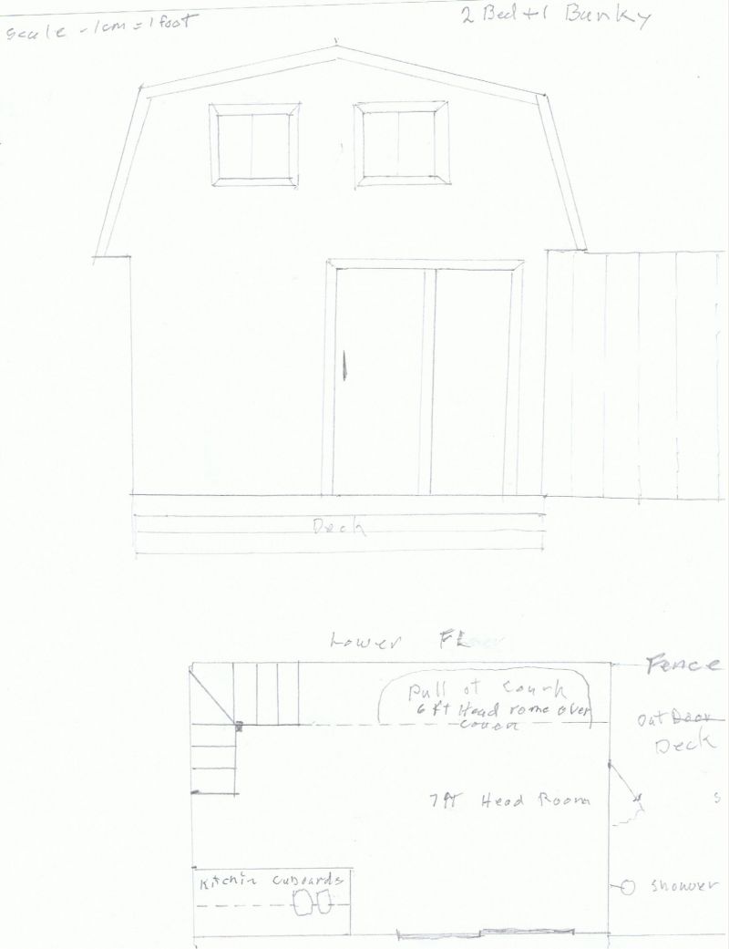

I think that one was 14 ft. high I do have some inside pics but they are at the cottage . We have since sold that cottage on lake huron and bought one on lake Erie . It sounds to me you have the same reasons for building as we did our kids and there kids used the bunky when we were staying in the main cottage . we just ran a extension cord and a hose to the bunky for hydro and water bunkys are not supposed to have permanent hook ups . the outside dementions were 8ft x 13ft 8 in.. the biggest advantage to that designe is the inside stairway [much safer for little kids]!!or grand kids in our case!! the main floor had a set of 60 in. ikea cubourds with a small doubble sink a microwave and a bar fridge and toaster. we had a bbq out side as you are not to have any flame inside a bunky. we heated it with a small electric heater and that worked well in the summer . it was a single skin building no insulation . that seemed to be ok for summer use in ontairo . that left room for a fold down table,, stools, and a fold out soffa we were alwase going to ad a out side jon and shower but we never got that finished. the stair way leeds to a small up stairs hall way of sorts above the couch below,were there is room to stand and dress . there is a centre wall up stairs that seperates the two sleeping lofts, a curtain in the hall for privacy. Each sleeping loft is 60 in x 80 in big enough for a queen size bed . both rooms have their own window for ventilation . there is room at the end of the hall for a small closit . I will get the inside pics when i go to the cottage nexts and post them here . you will need some help with building don't be afraid to ask here , lots of help here [just] ask

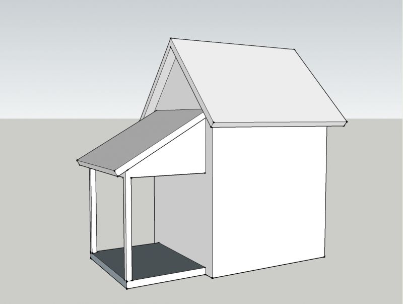

One idea I've had for maximizing the space is to add a porch with a shed roof and ceiling, so that there is a small attic space between the ceiling and roof. Keep that attic open to the second floor/loft of the bunkie and put a built-in bed there.

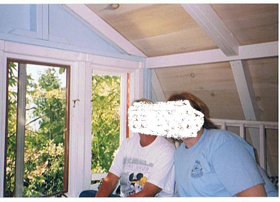

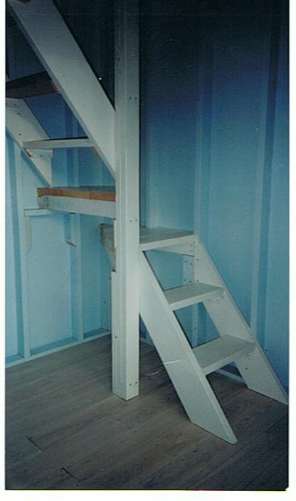

# Posted: 12 Jun 2011 11:29pm

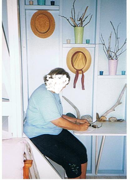

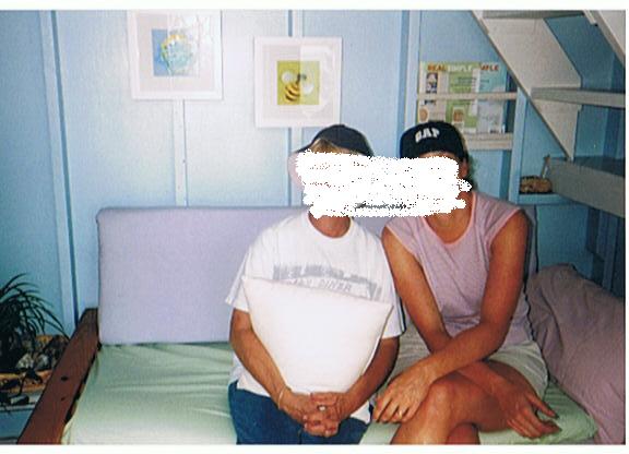

Here are some inside pics of that 2 loft bunky can't find any of the kitchen , sorry took so long !Have you made any progress with a plan??
right loft
right loft
stairway inside
stairway inside
down stairs foldout futon
foldout table
foldout table

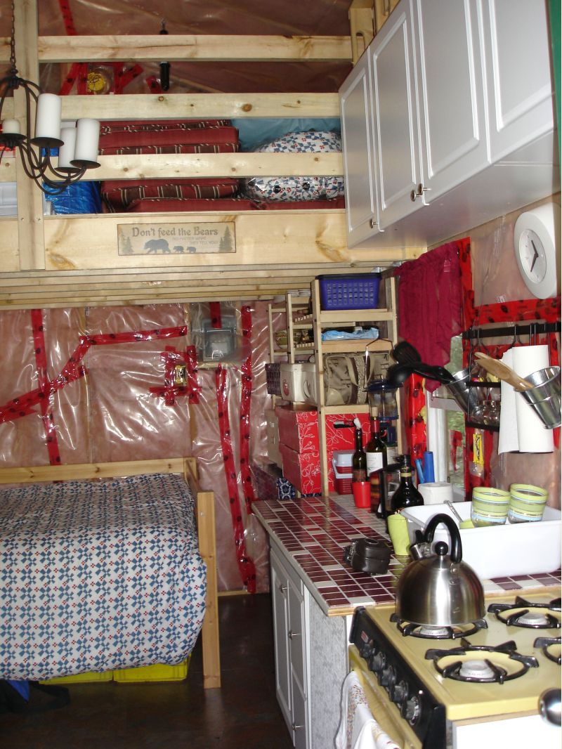

# Posted: 15 Jun 2011 09:34pm

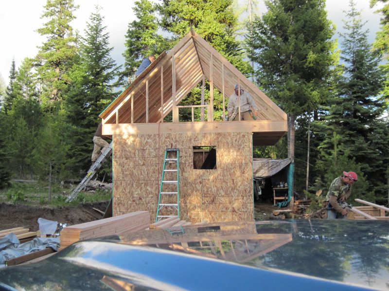

This is a 10x16.
It started as a rona shed kit. We added 3 feet pony walls at the top, added a loft which is 77 inches deep to allow us to install a trundle bed for the kiddies.
the shed kit was about 1300.00. We just bought interior tongue and grove pine paneling to finish it off and I will send you a pic when we finish the inside in a couple of weeks:)
