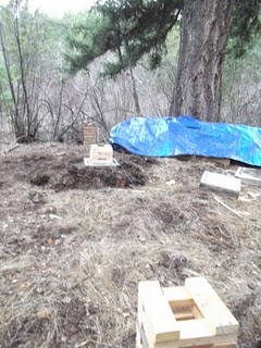

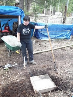

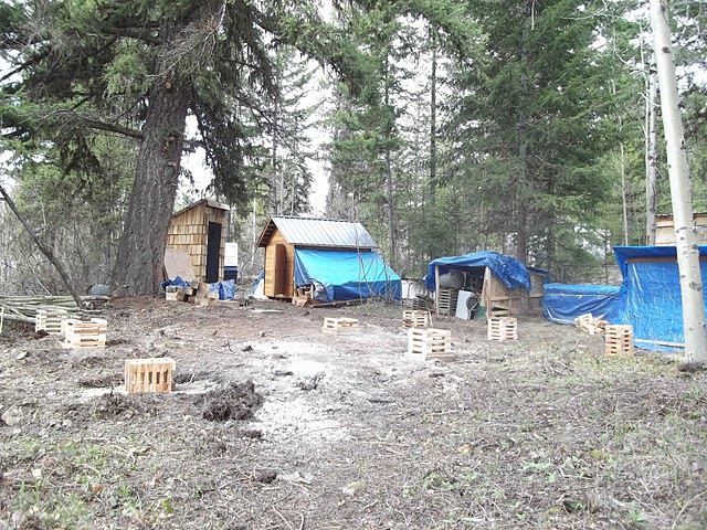

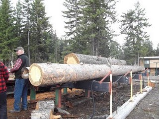

Ok... so we've sorted out our foundation issues. We are prepping for three log skids to come onto the lot this coming weekend. Plus... we are doing some post and piers for our deck area.
The skids need to be off the ground and on blocks. So we have 9 concrete "tiles" 20x20x4 dug down to solid ground... mostly shale on the building lot. We put the tiles in the ground and built up post to be level with each other. We only got three done last weekend, and they still need some leveling, but now we know what we're doing it will go faster. Our friend is going to cut the skids from us at his mill and deliver them this Sunday.. hope we're ready!!

So the timbers didnt arrive as planned... I forget we are working on "Kennedy Lake" time.. In retrospect it was probably a good thing because it took us way longer to level everything. Hopefully they will be there when we go up this coming weekend. ( I paid for them ahead of time to help grease the wheels..lol)
We have a load of 2x10s being delivered on Saturday so we can get started on framing the floor.
