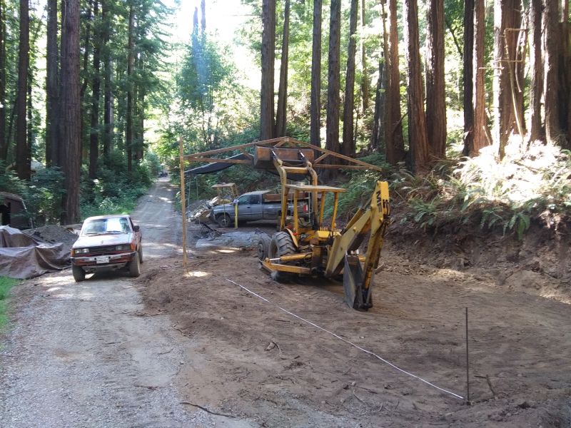

Actually more of a tractor port. I have the area leveled and mostly graded. Put one of the trusses in the air today for a look. Little close to my driveway but best I can do, and I can move the driveway over a few feet..
Got me thinking, could I build the roof - beams, trusses, perlins, metal roofing, on the ground (or maybe 2-3' up) and lift it onto the posts? Might be a little tricky but it sure would cut down on the lifting and ladder work. Anyone done anything like that?
# Posted: 24 Jun 2021 11:14pm
It all gets twice (or more) as heavy as you think pretty quick!
And after it goes bad in a lift and ya thunk it on the ground you will not be happy.
# Posted: 25 Jun 2021 06:13am
Build it where it's going to stay. If your loader lift to the top of the wall you could load all the trusses in the end. Get on the ladder and flip them up while attaching perlins.
# Posted: 25 Jun 2021 08:05am
Thanks guys. Yeah I have been mulling over how I would lift it and get it in place and it seems too risky. Oh well just a thought. Putting up the panels working on perlins is going to be tougher than plywood. And you can't walk on a metal roof over just perlins I don't think. $80 for a sheet of plywood right now..

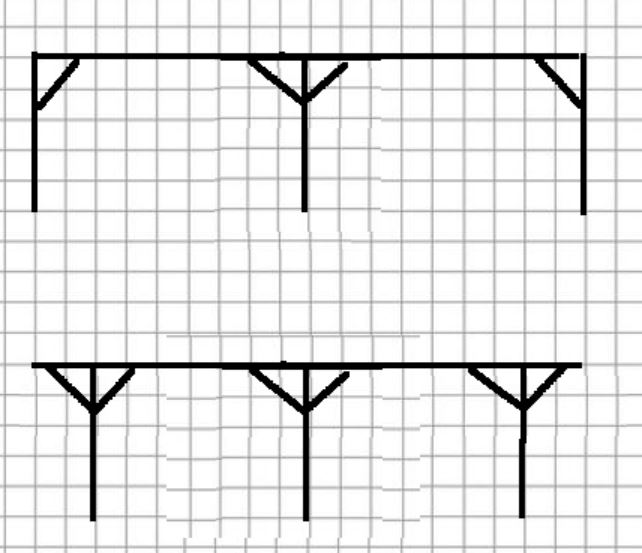

Next thing I'm considering is the placement of the outer posts. If I move them in it helps the load on the beams, but I don't see any carport/gazebos done this way. Outside of load carrying concerns, is there any reason not to?
# Posted: 25 Jun 2021 10:30am
I wouldnt put the posts on the ends. I would bring them in a bit. It will help protect the post.
# Posted: 25 Jun 2021 12:04pm

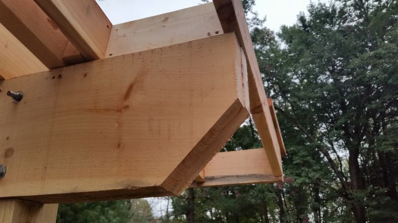

Good idea. I also like how the post is notched, I will do that too.

Next step for me now is to put a French drain along the hillside (right side in top photo). Already roughed out the trench with the backhoe. Bed of gravel, some perforated pipe wrapped in fabric, gravel on top. Did the same at my cabin, water has never gotten under it.
# Posted: 26 Jun 2021 05:51am
Swales work just as good if not better than a french drain and dont have a costly pipe to clog.
# Posted: 26 Jun 2021 10:56am
Glad you mentioned that. At my cabin I also dug the ditch before construction, but didn't put the French drain in until later, and it was a real pain as the ladders had to sit in the gulley while doing the siding and roof. I needed that space to walk on afterward, it's the main path to the back of the cabin, so the French drain went in.
I won't need that access this time (easy walk around on the other side), so a gulley is fine. I'll just leave the dirt there now for ladder work and scoop it out later. Thanks Brett, I really appreciate the input.
