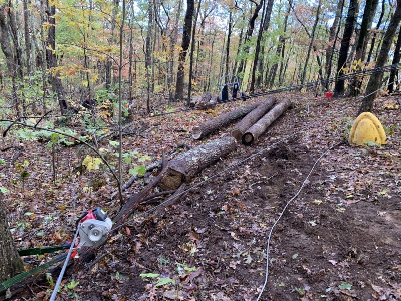

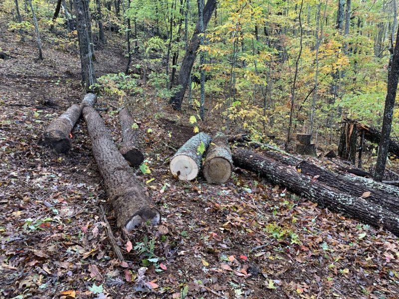

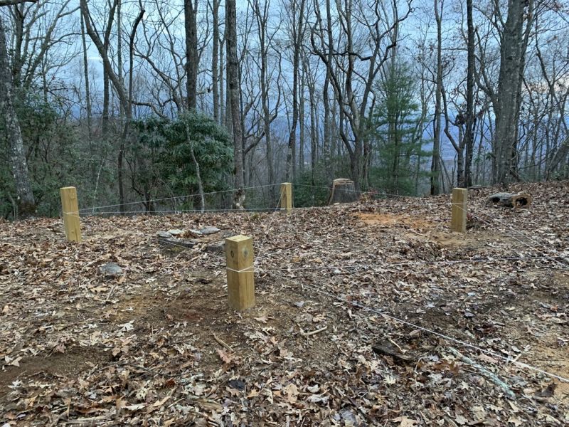

Made some progress on the cabin over the summer and fall. Detailed updates on my blog.
Highlights include:
- Water access
- Milling the first boards
- Harvesting timber for the build
- Skidding logs
- More skidding
- Camp improvements
- Setting the post-and-pier foundation
I also posted a video montage from tree felling on YouTube
Happy new year!

You've made progress this year-great. Traditional cabins made with round logs used either a saddle notch or steeple notch while those with the dove tail were squared with a broad ax and adze. It is easier to cut the dove tails on a flattened surface.
Scribed log building was not common in the Appalachians from the cabin examples I have seen. It is easier with a chain saw, but would have been very difficult if the scribes were being done with hand tools.
How will you splice the logs for the 20 foot side or do you have 20 foot logs?

# Posted: 31 Dec 2021 09:19am
@BobW I'm planning to square logs and use a half dovetail joint. I have quite a few twenty foot logs, but if not I was thinking to splice using rebar for reinforcement.
