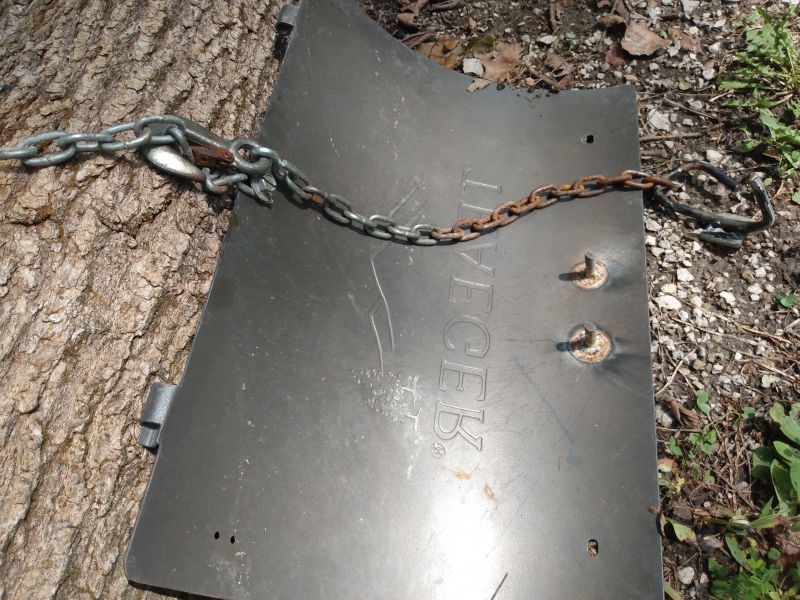

Made up a skid Pan to keep logs from gouging/digging ruts. Used a Traeger grill lid, some bolts, and old trailer safety chains.![Pan Pan](https://www.small-cabin.com/forum/shared_files/uploaded/10702/147652_1.jpg) Pan

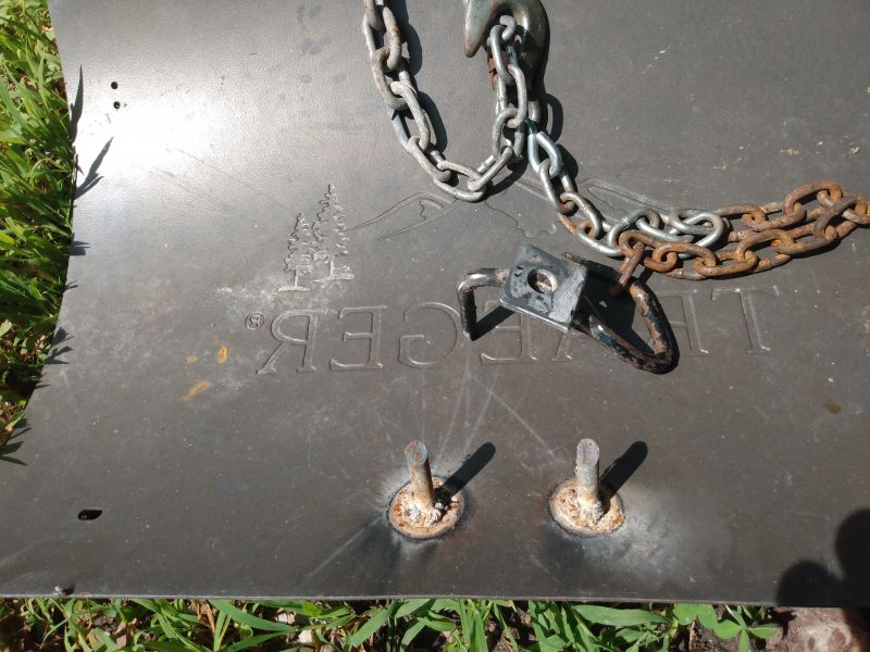

| ![Pan spikes and hammer in cleat Pan spikes and hammer in cleat](https://www.small-cabin.com/forum/shared_files/uploaded/10702/147652_2.jpg) Pan spikes and hammer in cleat

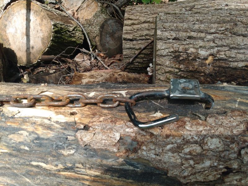

| ![Hammer cleat Hammer cleat](https://www.small-cabin.com/forum/shared_files/uploaded/10702/147652_3.jpg) Hammer cleat

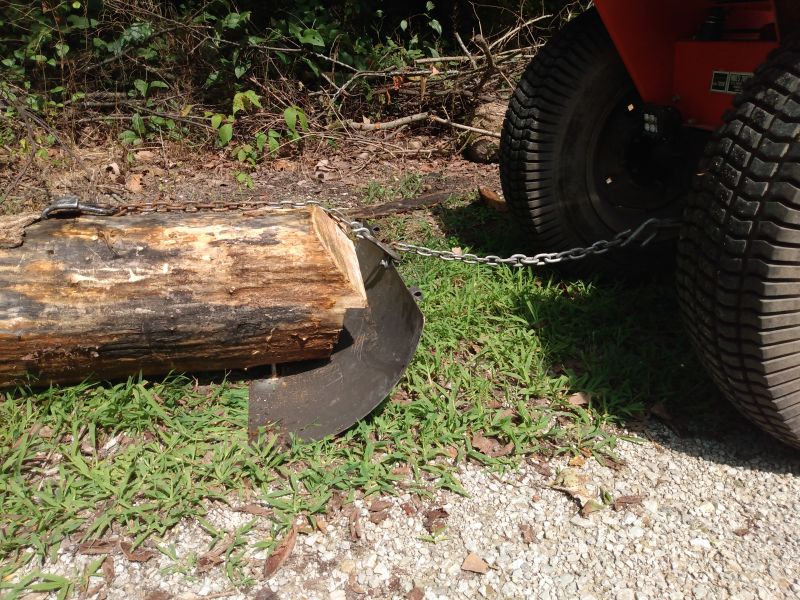

| ![Hook and go Hook and go](https://www.small-cabin.com/forum/shared_files/uploaded/10702/147652_4.jpg) Hook and go

Good idea. Might have to make one of those
# Posted: 13 Aug 2021 19:12
Nice! I like the hammer cleat.... I usually just wrap a chain around and pull. That or the winch cable. My winch cable is hear toast so not being too careful with it of late. That hammer cleat looks like the ticket! Might have to make one of those!

All my attempts at this usually resulted in the log rolling upside down somewhere along the line. Then the skid was on top and not doing any good. Since I was often on the sketchy edge of what an ATV could pull, I usually had the throttle mashed.
One time the log flipped and then caught a root and brought the whole shebang to an instant stop. I slammed into the handle bars so hard that it knocked the breath out of me. So, there I was, by myself at a remote cabin rolling around in the brush desperately trying to breath. The air came in eventually and I didn't die, but boy, did that hurt.
