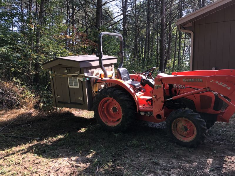

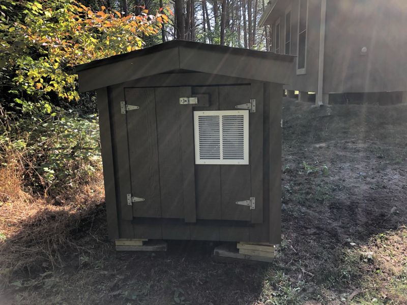

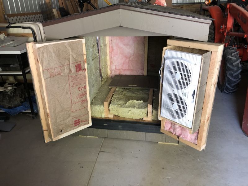

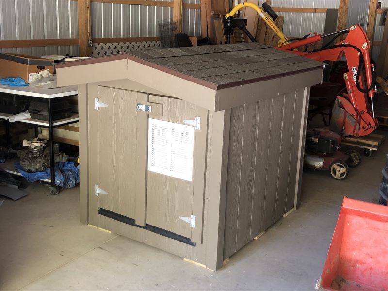

With left over materials from building the cabin, I decided to build a shed to house a small inverter generator that would not only protect it from the weather, but also keep it as quiet as possible. It was easier to build it in the barn then haul it up to the cabin in the woods. The generator is a Wen inverter type with 1800 running watts and an eco-mode (quiet/efficiency mode). It's not pictured, but will set on the sliding shelf inside. Also, I still have to run wiring over to it, as well as the ground. For now, I'm going to get by with an extension cord.

Just make sure you get enough air movement to keep it cool. I don't have a fan on mine but 5 ~10" x ~14" vents, upper/lower and one in the floor under the generator (HF 3500 Predator ), in the summer I need to leave the door open... actually I leave it open anytime I'm running it except winter. The fan is a good idea.
# Posted: 12 Oct 2021 11:57am
Nice little shed. I plan on building an insulated box around the generator and have a fan blowing across it when it running. Louvered door flap to open when running for hot air to exhaust.
