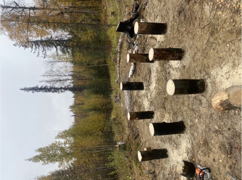

 |  Foundation posts

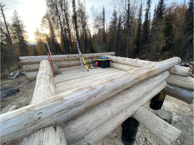

 |  A few logs up

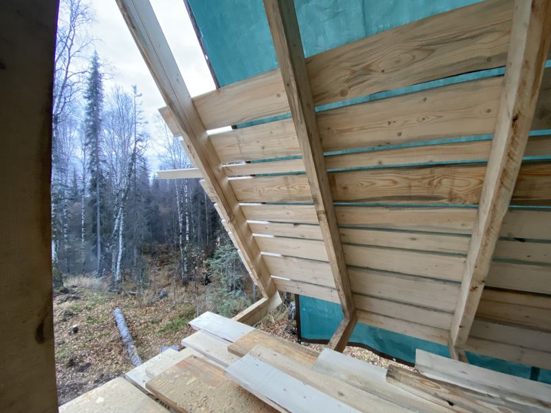

 |  Roof rafters

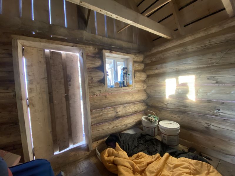

 |  Door and window
