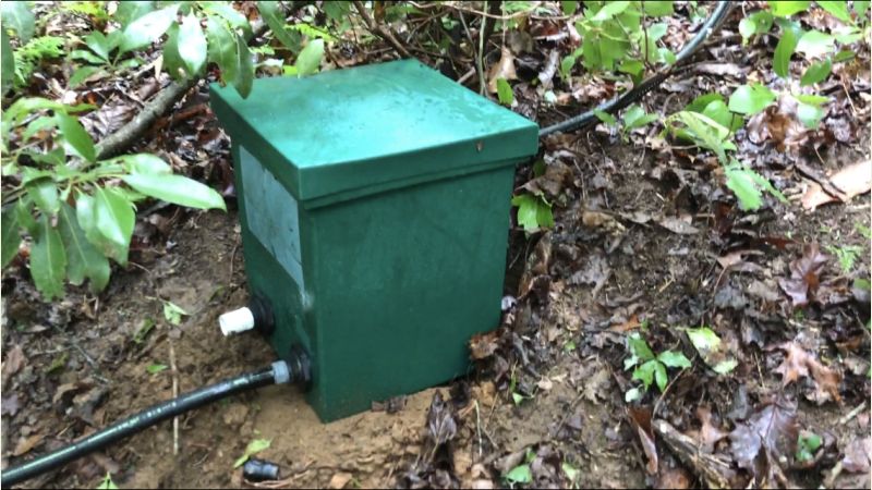

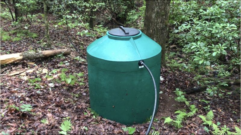

This YouTube video documents the process I used to develop a spring water supply for our off grid property.
It may not look like much but the spring supplies 720 gallons of water per day...year round. It is gravity fed. No need for pumps of any kind.
275 Gallon Storage Tank
Spring Box
Spring Box

MikeJB
# Posted: 16 Dec 2021 10:06pm
Quoting: DaveBell
Thanks Mike!!!
My pleasure...

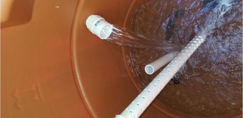

A gravity feed spring would be awesome. Ours is down hill so 1-2x a year I pump directly from our spring box up our hill to a 275gal water tank. Its seasonal too, dosnt run in the heat of the summer.
I used a pickle barrel for a spring box. The vertical pipe is the overflow, the one with the holes goes to a .5hp jet pump. In this pic it's running about 6gpm.

# Posted: 17 Dec 2021 09:44am
Yes I run my jet pump off a generator. I got the 120v version and it was about $100 on home depot. 35min of generator run time gives me 275gal of water. It runs 65ft vertically through 300-400ft of 1in black poly.
The trick to trouble free jet pump starting is make the jet pump be below the incoming water level. In my case its elevation is just below the water level of the spring box. Originally I had the pump sucking from a stream and 100ft of black poly. Took 45min to prime the thing even with a foot valve. No foot valve and no priming needed now.

Great setup! What is your climate zone (if you don't mind me asking) and do you dismantle any of it during the winter? We are in a cold winter climate so everything we have done is super temporary and taken down every trip.
MikeJB
# Posted: 19 Dec 2021 07:27am
Quoting: moneypitfeeder
We are in Zone 6A. It does get into the teens. When we are on-site and expect a hard freeze or when we leave the property for any length of time, I close a brass ball valve located at the outlet on the storage tank and open the spigot at the other end of the poly pipe which empties the tubing.
The tank will not freeze...too much water plus there is a constant flow of water through the spring box and storage tank....keeping the water in the tank moving and above freezing. There is an overflow outlet on the tank that returns unused water to the creek.
