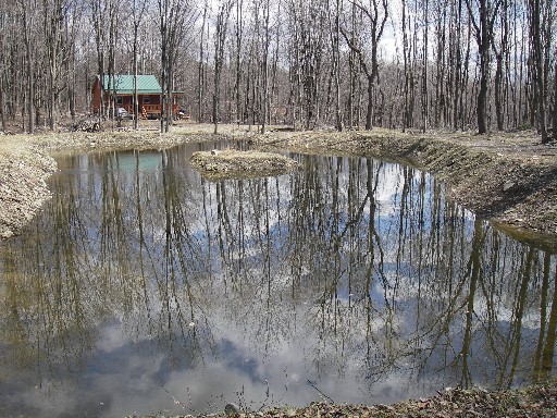

Finally got around to posting some pics. Here's one of my pond project near completion after the spring thaw.

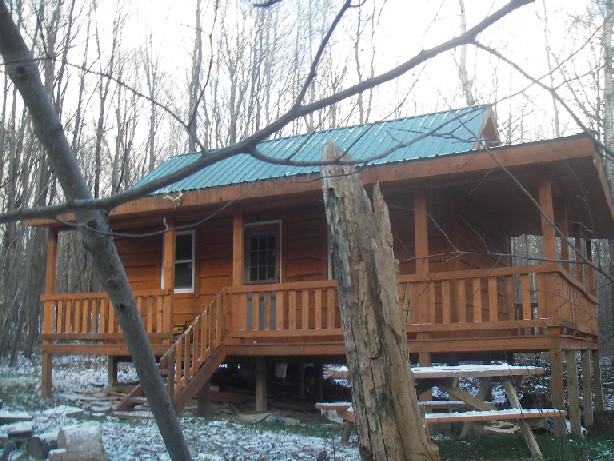

And one up close of the cabin, last November, during the first snow. Note that the wrap around deck makes it look a lot bigger than it really is.

No fish yet. Not long after that picture was taken, I had to repair a MAJOR leak in the dam after all the water leaked out. The creek that feeds it is seasonal, so no water till this Fall. My property is high elevation causing the temps to be at least 10 degrees F cooler than the surrounding area, so I'm hoping the water should stay cool enough in the Summer to allow a few rainbow trout to survive. The pond is only 4 feet deep with a couple of deep spots at around 8 feet, so we'll see. At any rate, that half acre pond has been a labor of love to say the least.

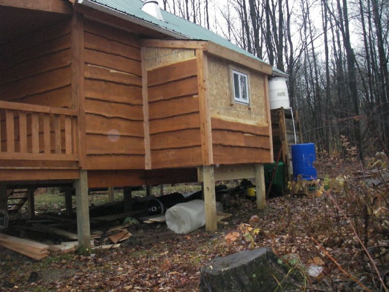

Hi Vince P - What type of siding is on your cabin? It looks like it could be rough sawn strips taken directly from trees? Is that right? How was it to install and finish? Are you happy with it so far? I really like the look of it and am considering using something like that on my cabin.
Thanks
Vince P
# Posted: 7 Mar 2009 12:46am
Quoting: Walnut What type of siding is on your cabin? That siding is what's known as Adirondack siding and is essentially what you said: slabs of rough cut, directly from Fir or Spruce trees with the bark still left on. I looks like wavy boards and I think it adds just enough rusticity. I had planned to originally do log siding, but I'm happy with this as it is somewhat unique, but still looks great. Here's a pic while the building was still going on and before staining.

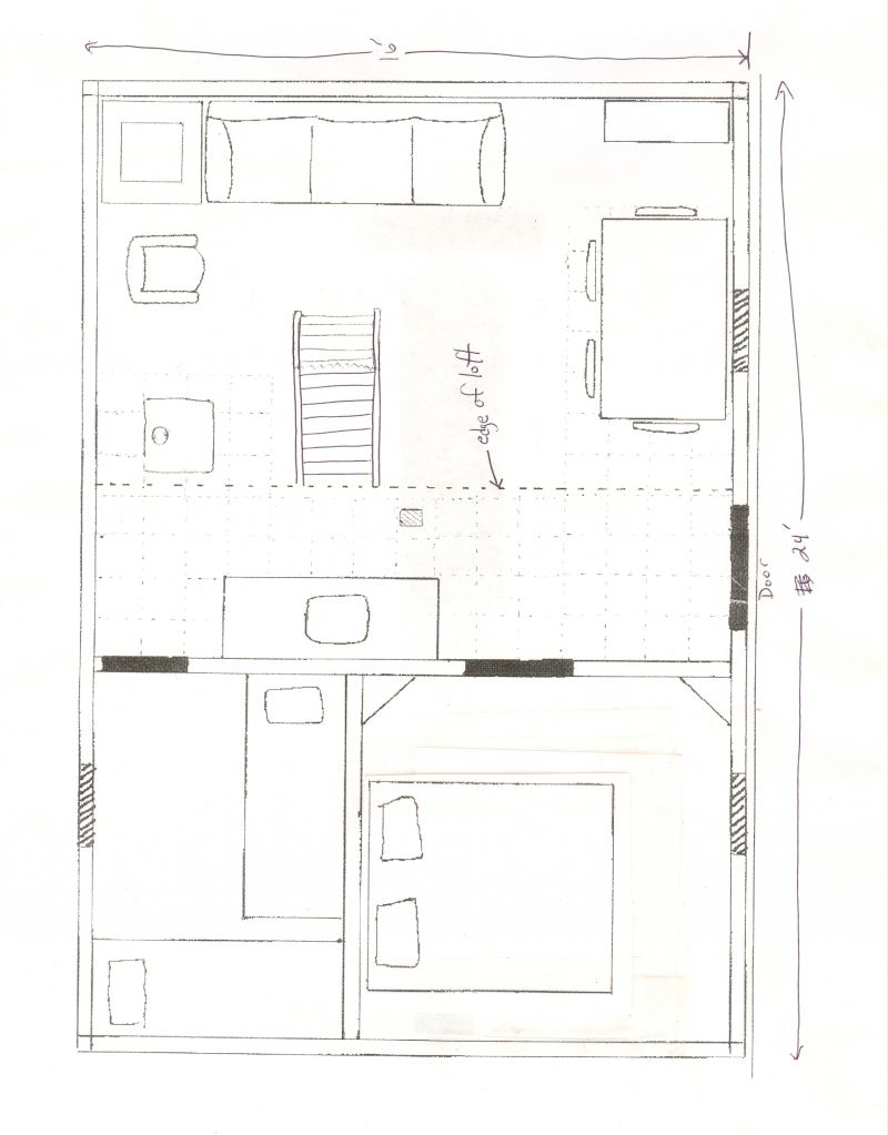

Quoting: Walnut I'd love to see some pics of the cabin interior if you have any. Here's the floor plan I was using, which doesn't show the deck.

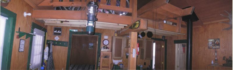

Also, here is a panaoramic view of the 14x15 main room. I stitched this together from 3 pictures. Note that this is a wrap around panoramic image that makes thing look appear larger than reality.
The unfinished door next to the stovepipe leads to a bathroom addition currently in progress. I enjoy the outhouse, but in mid-winter it makes big difference...see photos below.
Vince Floor Plan

Looks great Vince. Love the decor. With three daughters I congratulate you for getting this far without an inside bathroom. I'm sure that is a welcome addition.

Vince - can you tell me about your footings. Looks like treated posts in the ground, but are they 4x4, how deep and what is the spacing? Did you use a cement footing at the bottom. Beautiful place. I like the siding and might copy you. Thanks.
Jerry
Vince P
# Posted: 12 Mar 2009 10:14pm - Edited by: Vince P
Quoting: Jerry Vince - can you tell me about your footings. Looks like treated posts in the ground, but are they 4x4, how deep and what is the spacing? Did you use a cement footing at the bottom. The footings are 6x6 pressure treated, three or more feet into the ground with no cement. As for the spacing, under the cabin: the posts are three rows, eight feet apart with the posts in the rows 12 feet apart. The deck posts add another course of posts to the three rows, plus another row, for a total of 16 posts. If my description is confusing, just say so, I can draw you a diagram. The posts from the deck to the roof are 6x4 and the high side of the cabin is 5' off the ground... which is why they might look thinner in the picture. I'm planning to build a storage area under there this summer.

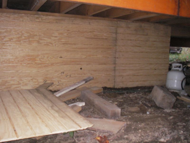

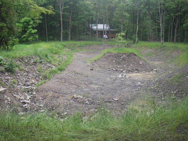

Here's some of the latest photos of my project. The pond is holding water at last. After 2.5 years, I think it's time to just relax when I visit the cabin rather than work. Pond leak repaired and filled
|  Under cabin storage area

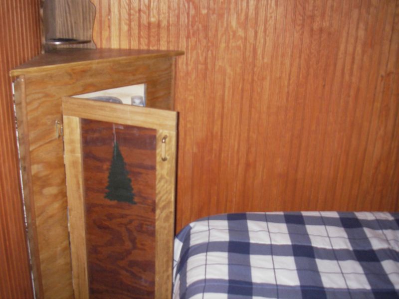

Quoting: flatwater In small bedrooms my wife and I discovered a four drawer file cabnets work real well for either side of the bed and will hold more cloths then most dressers. You can paint them in a number of ways. You can get them used for little or nothing Or you could build a couple of these corner units like I did. The challenge was to build each one using only one sheet of plywood and some scraps glued together for the top. I have very little room on either side of the bed, so corner units were the way to go.
