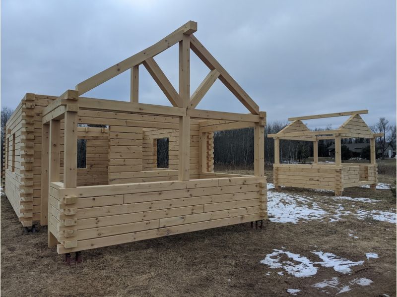

I'll spare you the not-very-long backstory but I went from not having land or intending to build a cabin to changing those plans on a total whim last October (I'm married... you can figure it out).
In early December I found this listed for sale about 90 minutes away from the property (300 miles from "home"). A long drive and a cold, snowy visit later and I had agreed to buy this (it's 16ish by 32ish) and also the little building in the back to tack on as a bed or TV room.
I set about getting permits and 3 months later almost everything I'd paid for showed up. It seems the builder "forgot" to include some pretty crucial logs (which he promised to make good on... before he flaked out and disappeared).

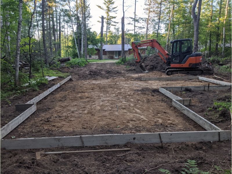

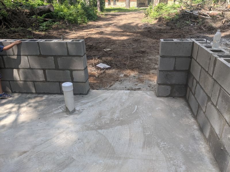

Anyhow, I'm not much for hot weather and bugs so over the summer I hired an excavator for the foundation and by the end of July I had an insulated slab with 32 inches of blocks on which to build. The plan was to get going in mid September and have the cabin dried in by the end of October.
I'll update when I post from here on out, but for now I'll just say we're LONG past October, we're still working on a roof, but I'd rather be up on that roof in 5 degrees and wind than in the July humidity with bugs...
And that's where we're at now. Two roof overhangs and an end truss to build and get up, then about 40% of the plywood to still put up on the roof (I've done the majority of it myself... which took some figuring out). Then we can get a roof on and get to where we were trying to be in October.

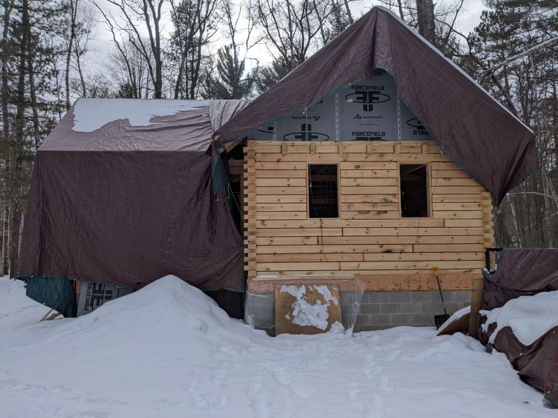

Update... or lack thereof. Ran up to check on the tarps. Shook the snow off. And that's where we're at.

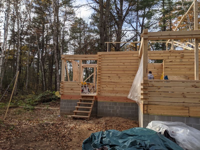

I was under the impression that something was supposed to be done for insulating/sealing while assembling the courses?
MJH
# Posted: 17 Jan 2022 07:01pm
Each course will have backer rod put into it, then some insulation (chinking then backer rod on both sides with insulation between). That will all come after I stain it, which I'll get to as soon as I get the roof done.

What is the thickness of the wall timbers?
MJH
# Posted: 17 Jan 2022 08:50pm
Quoting: ICC
They are 6x6.

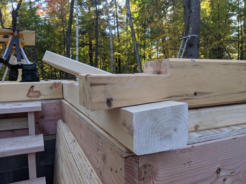

Is this going to be for part-time use or full-time? If part-time use is planned does that include winter? I ask because the 6" thickness of the timbers is getting to the point where the wood mass begins to be a thermal mass. Your location is north enough that this may make heating a structure that has been sitting unheated and very cold take longer than expected.
It is difficult to tell from the photos. Are those corner joints full dovetails where the angles do fully resist lateral movement in all horizontal directions? Do you know what sort of a jig system was used to cut them?

It's a weekend cabin. Without saying much more I can tell you that it's permitted as an *unheated* dwelling (renewable heat source, ie. wood stove, is fine) but I'm aware that I won't be walking in on a friday night, putting a log in the stove and having a comfortable and warm place. I've got thoughts on how I'll deal with that.
I'll see if I can find a closer shot of the corners. Technically I thin it's a half dovetail. Logs are definitely prevented from sliding inward but I suppose could push out if enough force was put on them.
They were chainsaw cut with a jig that looks similar to these: https://logdovetailjig.com/

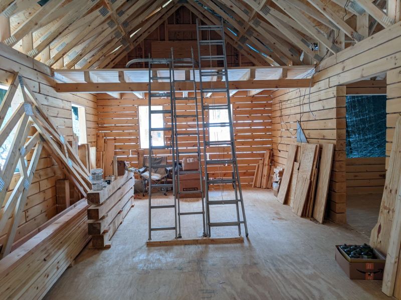

It's an 18 inch energy heal on the trusses. The ceiling is going to be spray foamed then have as much insulation packed in as possible. I also oversized the floor joists for insulation as well.
Every time I'm up there struggling on something I think about how much further along I'd be if I had stick-framed the cabin, but in the end we'll have something that looks unlike anything else in the area and should be a fantastic spot for the family to hang out.

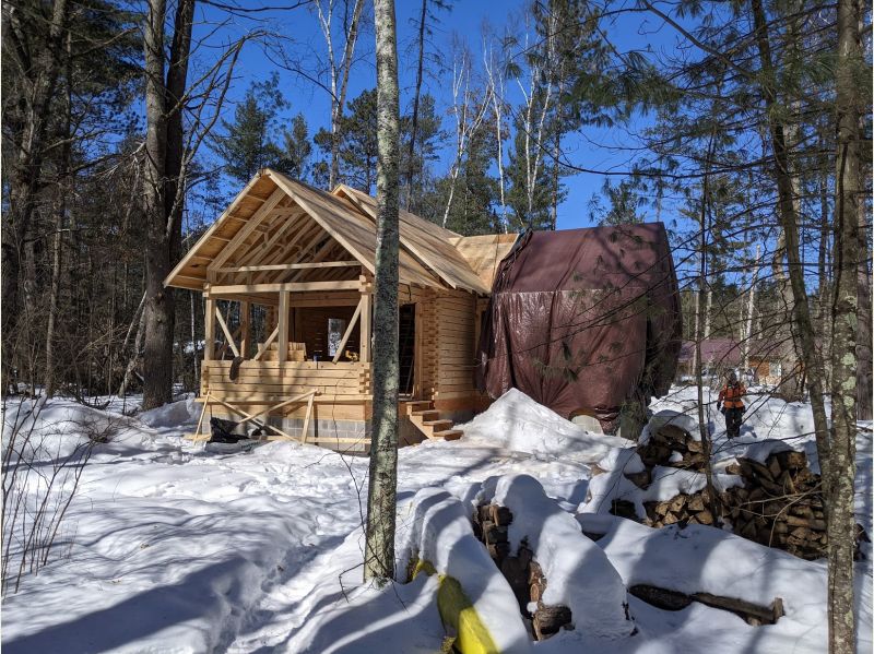

After a long 5 days with the help of 2 others whom I cannot thank enough, we finally have the last end truss up and the plywood on the roof. This roof has been a monster project. Feels good to have it looking like a cabin.
That plywood was heavy.

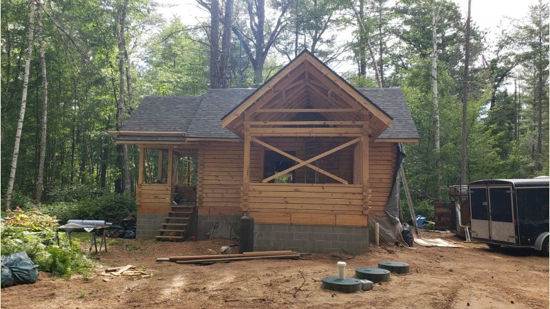

# Posted: 21 Jun 2022 05:06pm
Sometimes it feels like this will never get done. Pretty good progress the last few days, though.
We've got some shingles up, and a well!

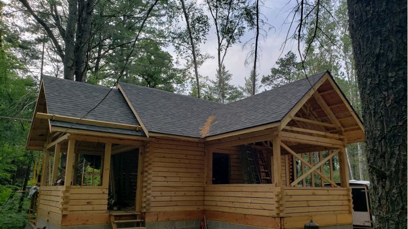

MJH

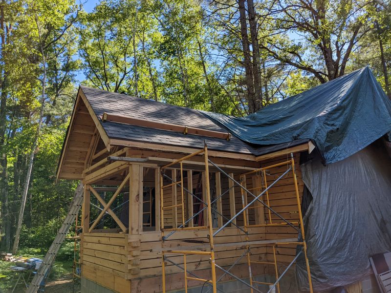

# Posted: 26 Jun 2022 09:56pm
If we're not careful this might get finished some day.
The roof is almost done.

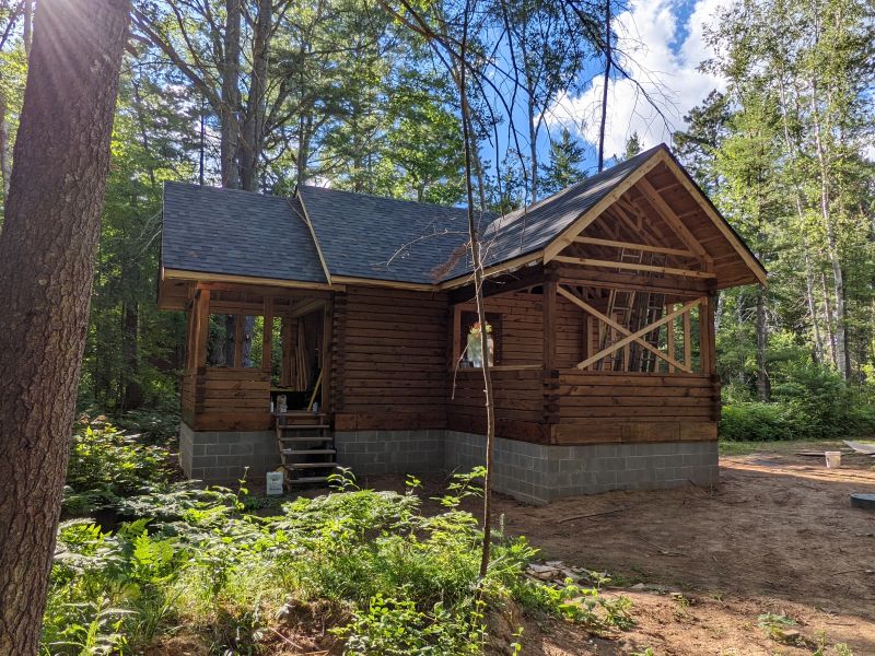

# Posted: 26 Jul 2022 11:18pm - Edited by: MJH
A year of progress (sorta.. didn't really start building until the end of september).
MJH
# Posted: 26 Jul 2022 11:20pm
Quoting: MJH
And the pics I mean to attach.
