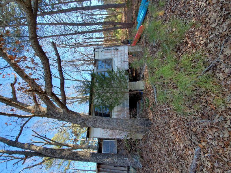

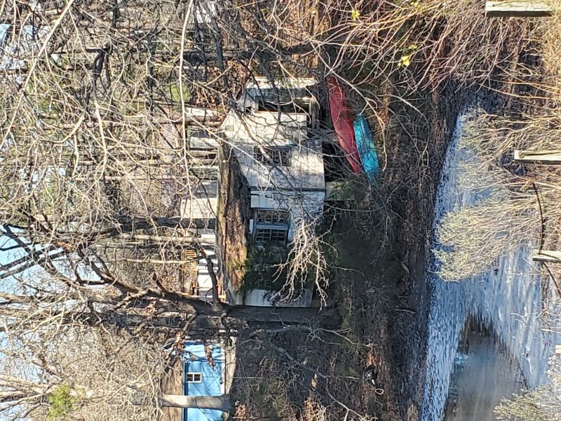

Hi all. We bought a waterfront property in the Northern Neck of Virginia and it came with a bonus (but totally junk) old cabin that is inside of the RPA zone (100 ft from waterfront). It's about 580 sf and 25' from the waterfront. I got verbal approval from the county guys yesterday that I can rebuild it provided that it's the same size, and in the same footprint. I have some ideas in mind for it; Off-grid, solar panels, solar well pump plus hand pump, possibly composting toilet and corresponding grey water system, LP tanks and kitchen stove, wood-burning stove. It's on a hillside so it would have to be on a pier and beam foundation, which I'm thinking should be sonotube piers with at least 8x8 posts and maybe LVL beams.
I put in an email to the VA Dept of Health to ask about options on the well and septic since the RPA situation is a unique circumstance, but hadn't heard back yet.
I would appreciate any advice or recommendations from anyone that has Virginia-specific experience with well and septic options at a waterfront location, and/or Virginia-specific experience with off-grid rules/regs. TIA!

Sad to say, solar doesnt look like an option with all those trees. Even just a little shading on panels can render them pretty ineffective.

Hi NorthRick. The county guys told me to pull off the grandfathering I would have to have engineered plans (even though I'll be doing the hammer-swinging). I'd definitely want to do new concrete piers so it'll be a ground-up deal. The house is completely rotten.

gcrank1, haha thanks. I've been brainstorming ideas for it for months! The county guys did give verbal approval to remove the big trees that are around it because they are completely in the way for demo/construction (I would have to "replace" them with some other vegetation. Not sure how far back I can get approval to clear for proper solar panel operation, but it seems they would work with me based on the first visit. It would be a minimalist set up anyway (LED lights, minimal outlets, etc).
