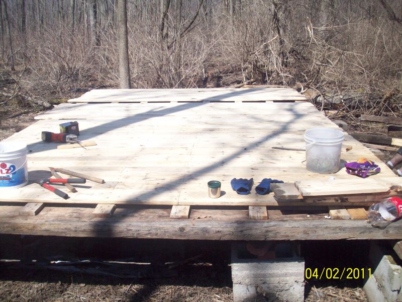

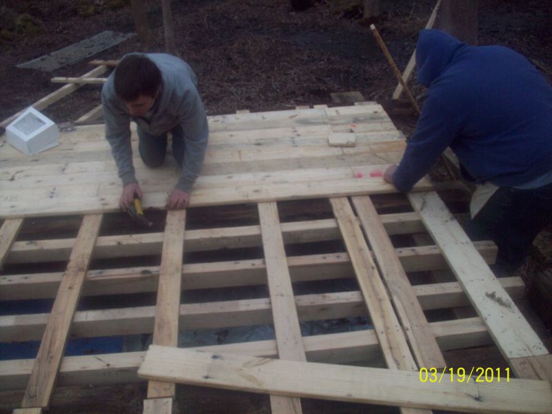

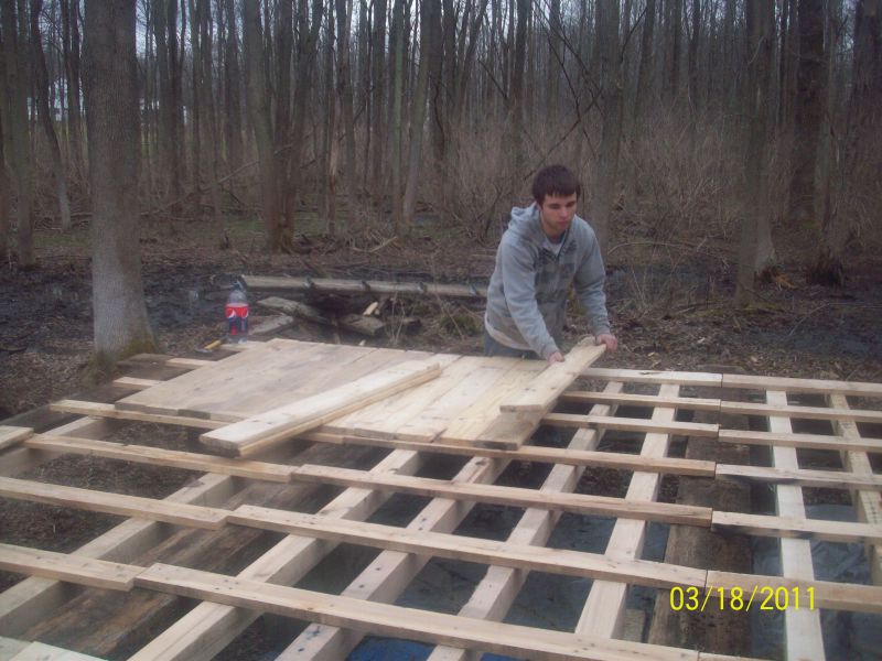

So we have wood but we have to disassemble each pallet and stockpile the wood until we get enough wood to start. Our original plan was for a 10 by 10 with a loft so we could stay perfectly legal. Well that didnt work out. It grew to 10 by 16. which makes a whirl of a difference. Right now it is sitting on cinderblocks. The area where the cabin is wetland. So we will jack it up if need be and place shims. We took old reclaimed 2 by 12 barn beams and made a a very sturdy outer perimeter and added cross beams. Then we took 4 pallets and layed them next to each other on top of the beams and nailed them down. an instant floor that is rock solid. Next we put down the flooring. A bunch of the pallets had 4 foot deck boards so we staggered the boards to make a nice pattern. We may sand it down and stain it or polyurethane it.(i like the all natural look myself)
over the next few weeks we stockpiled more and more wood until we had enough to do all the walls. Up to this point we have zero dollars invested. A few weekends invested but no money.

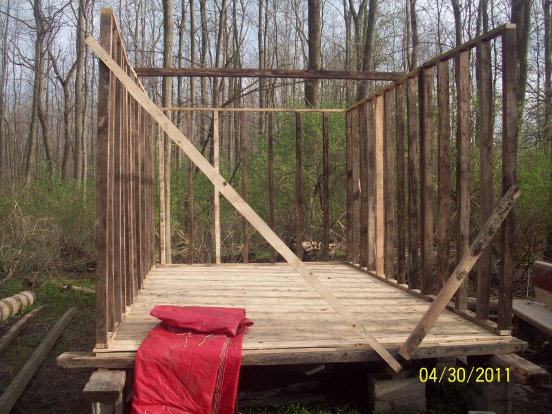

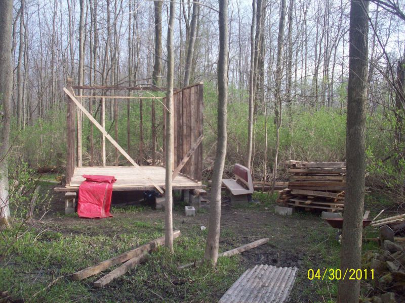

At this point the only thing stopping us from finishing the cabin is the weather!! It rained and rained and rained. We stopped working on the cabin to build raised wooden walkways through the woods so we didnt create mud holes. The place were we have the cabin we have to walk everything back. Its about a thousand feet back into the woods. So eveything that we bring in we have to bring out at the end of the day. Wheelbarrows helped until it got too muddy. The raised walkways where a welcome addition it makes things so much easier. We have the three walls done and just waiting for the weather to get better.

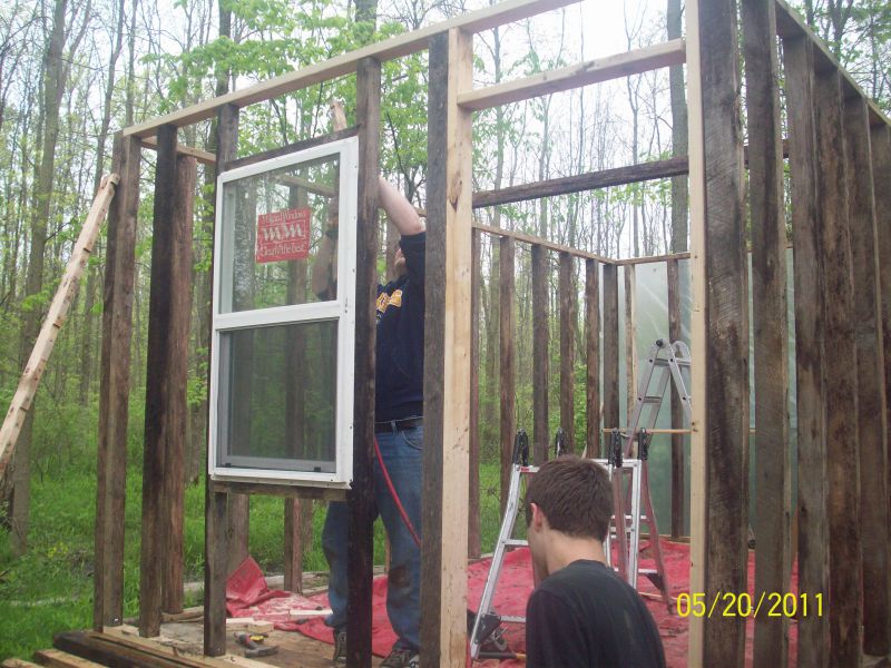

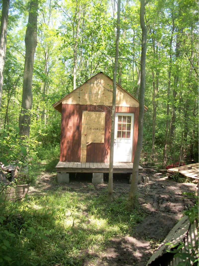

Every day last week i was checking the weather to see how the weather would be on the weekend i would check 3 different websites everyday and turn to the weather channel and they all forecasted rain for the weekend and then thursday comes around and then said partly cloudy NO RAIN on Saturday/21. I called my brother I called my dad it was Game Time!. My brother and I went on Friday and set up the camp.(AKA doing all the hard work lol) and my Dad would come out Saturday. Saturday we got a lot accomplished. We finished the front wall. We put in all the rafters. My brother and i were going to tear apart more pallet wood and use that for the exteroir wall. But my Dad had a surprise for us. He said "hey lets go to Homedepot and get some OSB board and I'll pay for it". He said the magic words "i'll pay for it"ok so up to this point we had zero invested so our grand total is now up to $165.62 I'm not counted the $400 dollar chainsaw that he told my Mother that he needed for the "Cabin" lol . The cabin will have 3 used windows. 1 was an extra brand new window that my dad had. I asked where he got it he said " from the basement, I bought it many years ago just in case the other one broke". A door that laying around. and 2 windows(not installed yet) from a Habitat for Humanity resale store. The windows where $20 Each. so our grand total is $205.62 dollars. So now I'm up to present day.

We did some more work on the cabin to protect it from the upcoming rain. We have covered the front and back peaks with tarps that way water wont get in. and we laid down a layer of tar paper until we can shingle on part of the roof this week. I have got 5 bundles of shingles and 2/3rds roll of felt for free from a friend. So i will do one side and when i get more shingles i will finish the other side. Yes one side of the roof will be a different color then the other. OH Well people in the airplanes that fly above me will know I'm Polish lol.

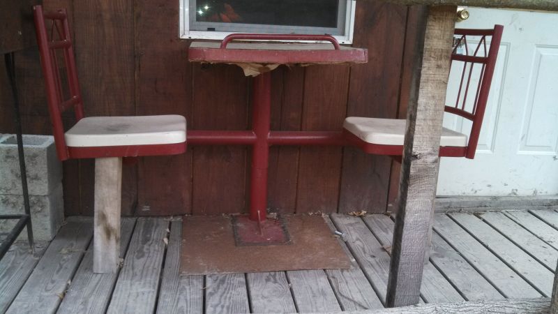

The inside is coming along. A Tim Horton's near us was remodeling and they were throwing out all the old seats and benches sooo.. Of course I grabbed from a dumpster (2) 8 Ft Bench seats and (2) 2 seats and a table combos.

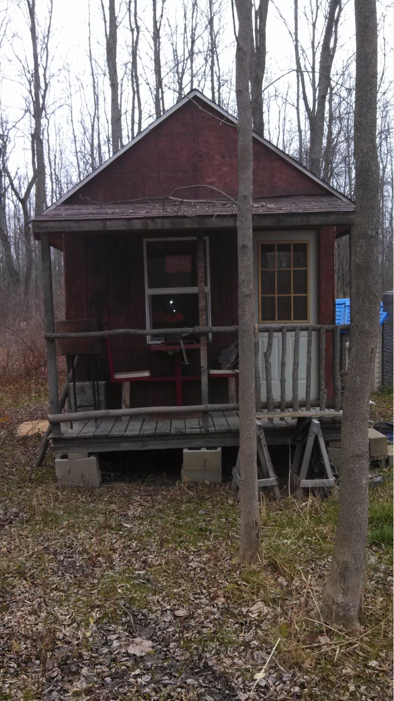

So we spend our first night in the cabin! It felt so good. We had a roaring fire and sat on the porch.

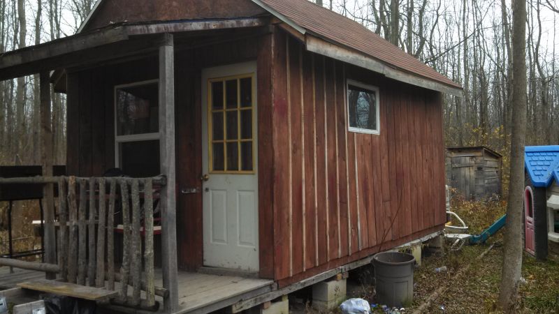

Since the last time we have done a lot to the cabin. We installed another window on the right side. We put a porch on. Closed up the eaves. The one wall inside is completely insulated the other three will stay uninsulated until we now there aren't any leaks.The front is stained but that is still a work in progress. We are about 90 percent done. Slowly but surely!

We have made a lot of progress in the last couple years. When i started building this cabin I had one daughter. Now i have 3 daughters. The size is still perfect with the addition of bunkbeds however i thinks its time to finish the loft or expand a lil bit. This years improvements was insulating the sleeping portion of the cabin and we are the process of installing a wood stove. We used a Mr. Heater propane heater which worked great.
