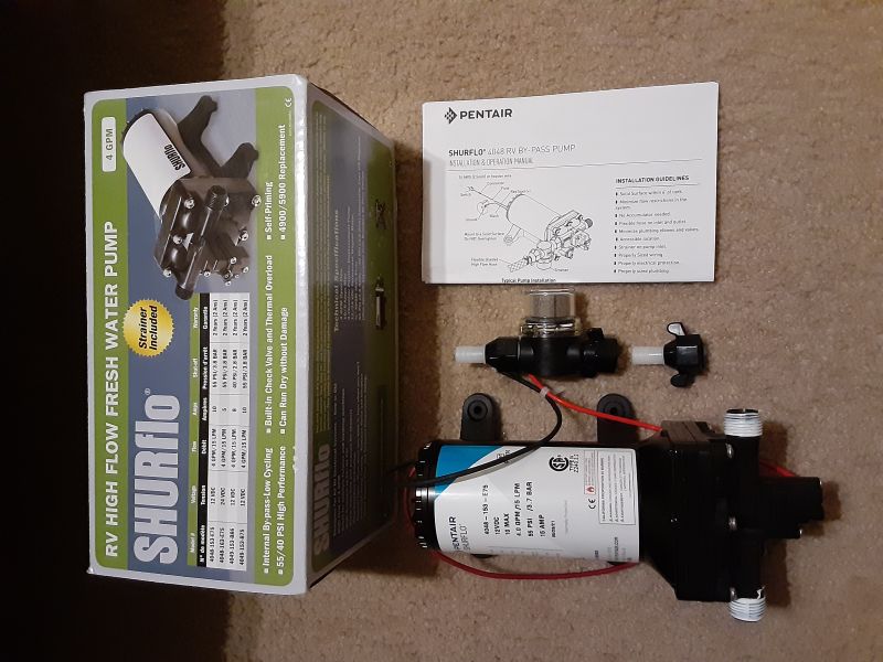

So, what I have extra is a barely-used Shurflo 4048 High Flow 4.0 GPM pump. If anybody wants it, I'll sell it for a reasonable discounted price. The cheapest I could find it was on Amazon for $187.99 (I paid a lot more for it from Camping World). It'll come with the strainer, 2 fittings, manual, and original box. The pump is perfectly fine, I just don't need it now.
Pump
Pump
