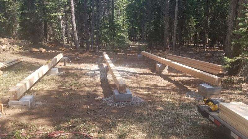

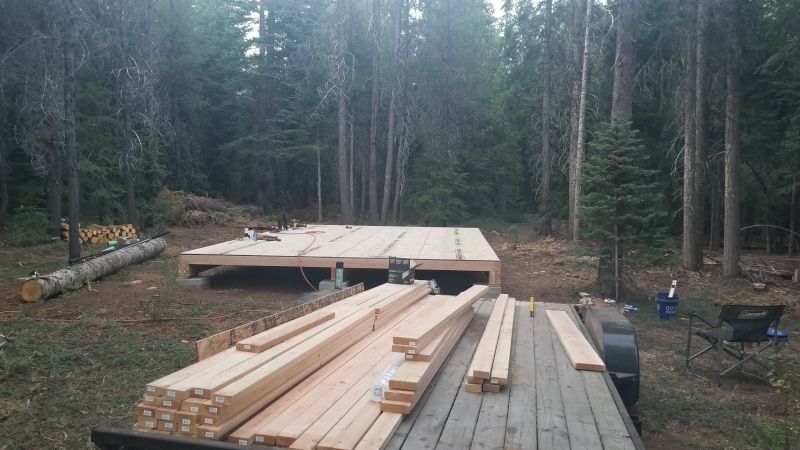

Started my cabin construction this last weekend. Very exciting and tons of work. Just wanted to share.
Irrigation Guy
# Posted: 31 Aug 2022 06:14am
Looks like a good start!

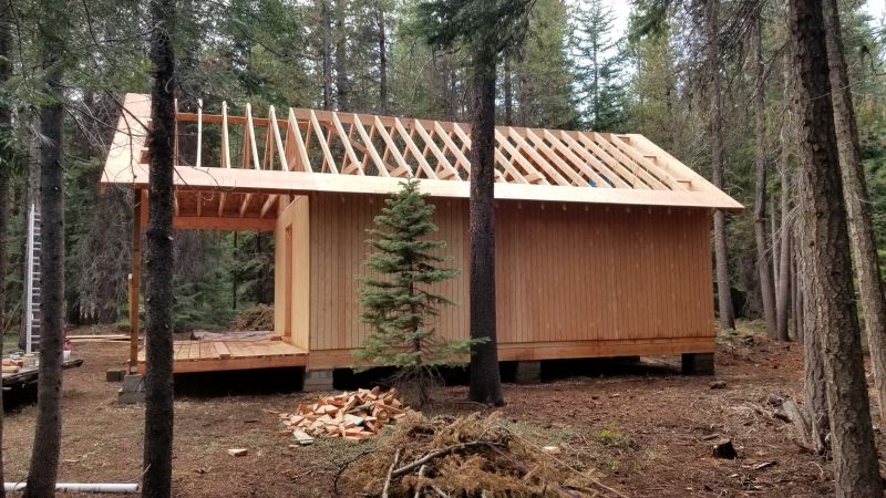

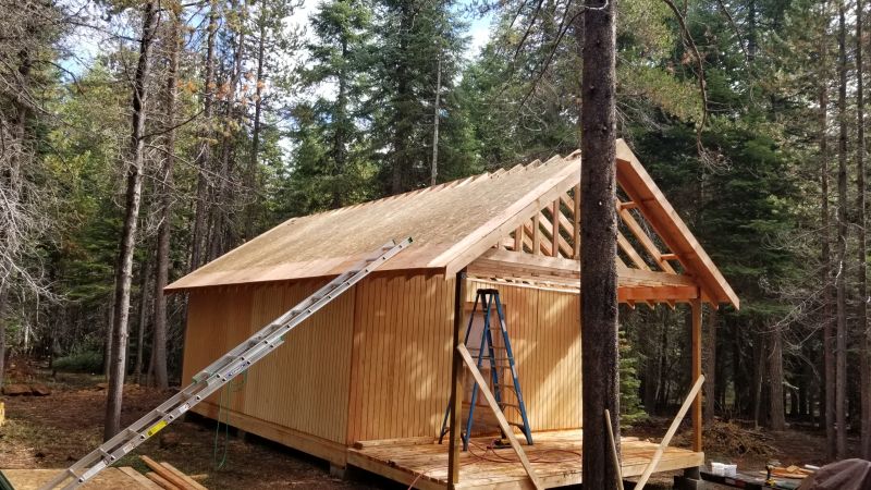

The wife and I got to steal away for Labor day and well, labor.
Made some progress, all the walls are up. 1 interior support wall and the loft floor joists. Forgot to get a picture with all 4 walls up. I'm taking next week off and have some help for a couple days so we'll see how far we get.

Looks great! I am curious, why did you use CDX ply on the outer course, and OSB for the remainder of the roof sheathing?
Link44
# Posted: 20 Sep 2022 09:39pm
Thank you. The plywood looks nicer to look up at under the overhang but the osb is 1/2 as much money. Around here that is common practice for houses.

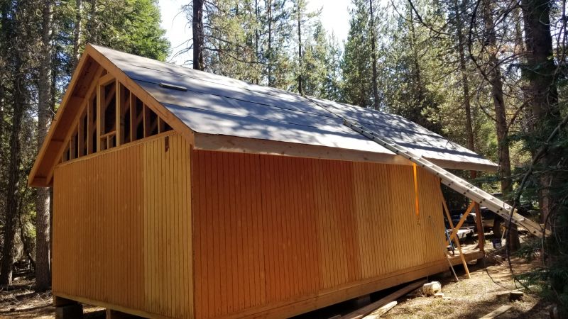

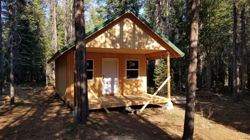

# Posted: 2 Oct 2022 11:49pm
Well, another fairly productive long weekend. Sided the front gable end, put up the facia and started putting up the porch ceiling. Finished sheeting the roof and got most of the metal roof on when we just had to pack up for home. Be back next weekend. Getting it dried in is taking way longer than I thought it would. The pitch came out at 8.25/12 and I can't seem to work without sliding down the roof . I have a secure mount and a teather but I ended up working mostly from an extension ladder laid out to match the roof pitch. Very slow going.
# Posted: 3 Oct 2022 01:05am
Link44, one of the nicest cabins I ever seen. Counting the T1-11, looks like 24' long, 16' wide? And 8'x16' porch? Keep the pics coming please. Are you going to install an outside air intake wood stove?
Link44
# Posted: 3 Oct 2022 11:52pm
DaveBell, Thank you. We are working hard to make it the best we can. Your eyes are spot on .
I am hoping to tuck a small wood stove into the left front corner as you're looking at it straight on. I have some old red bricks from a local building that was torn down to make a hearth with. That will most likely be next spring.

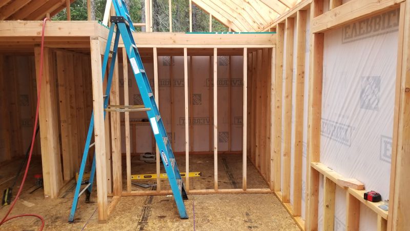

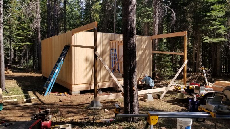

# Posted: 4 Oct 2022 12:11pm - Edited by: DaveBell
Picture 5, loft joists properly supported with independent (2nd) wall studs transferring load to foundation. Well done sir!
Link44
# Posted: 4 Oct 2022 08:25pm
Thanks! Eveything is 16oc. The rafters to the wall studs to the floor joists, they all stack in line. A framer told me he always wanted to see the path the load will take to the ground, wood on wood.

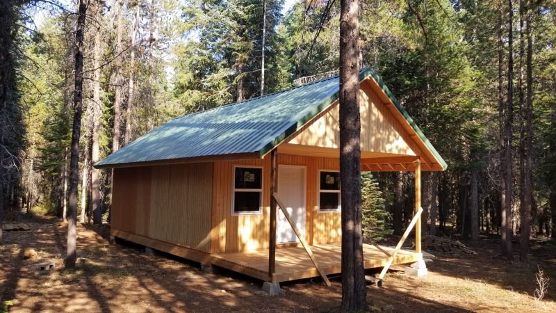

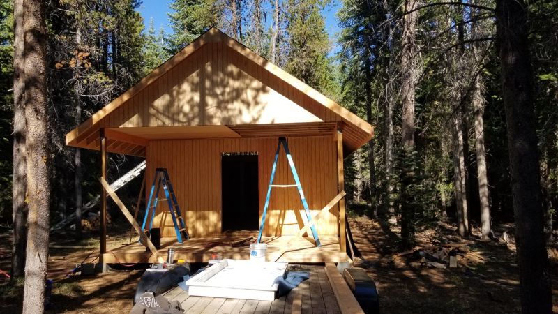

# Posted: 10 Oct 2022 11:35pm
Got the cabin dried in this weekend. The weather is holding out so next electrical, insulation and stairs if I'm lucky.
