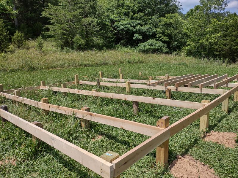

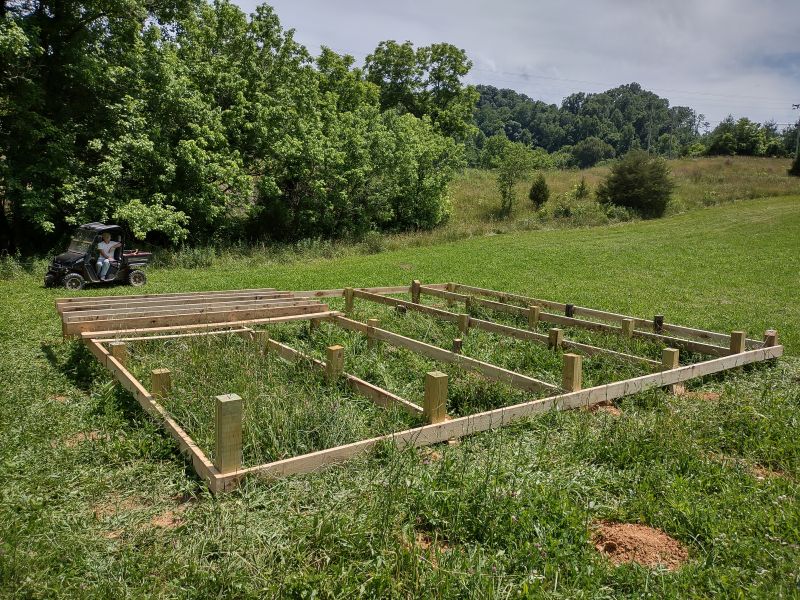

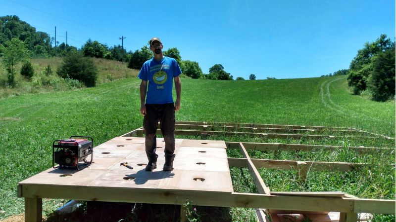

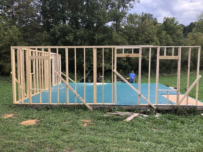

Here's pictures of the beginning,made a few mistakes but I'm learning everyday

It's coming along well. Looks like a beautiful spot.

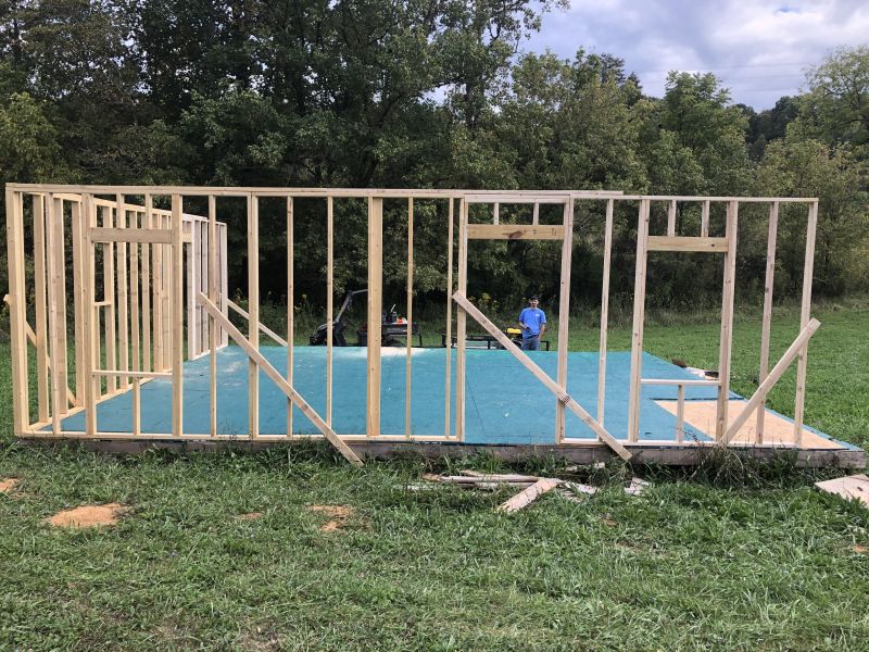

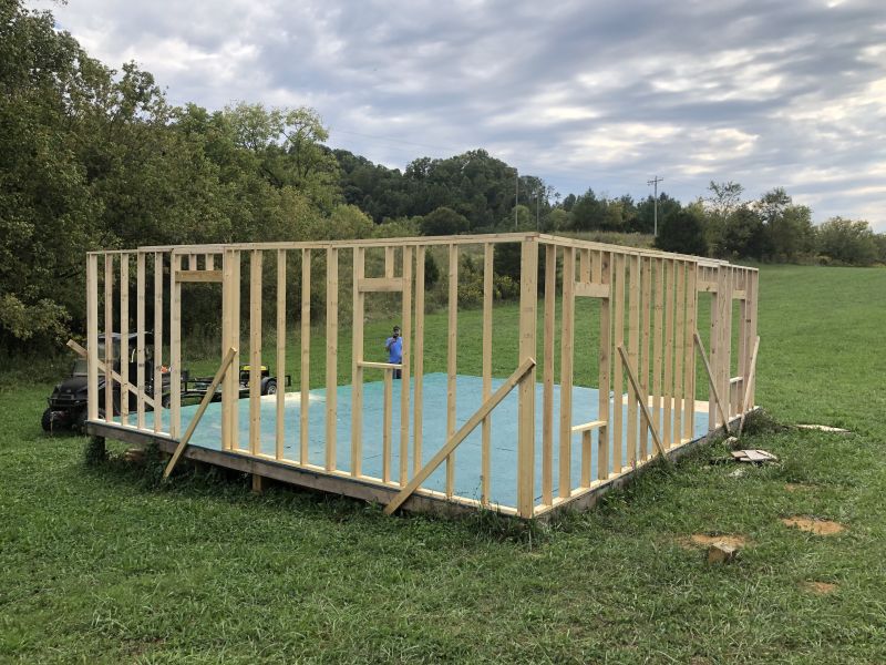

Do take a look at the headers above windows and doors. They normally sit on top of jack studs that carry the load down to the floor, assuming load-bearings walls that is.
# Posted: 26 Sep 2022 08:58pm
Even if the entire floor assembly, posts, joists and sub-floor sheets are pressure treated I see problems I do not want to get into unless you want me to.

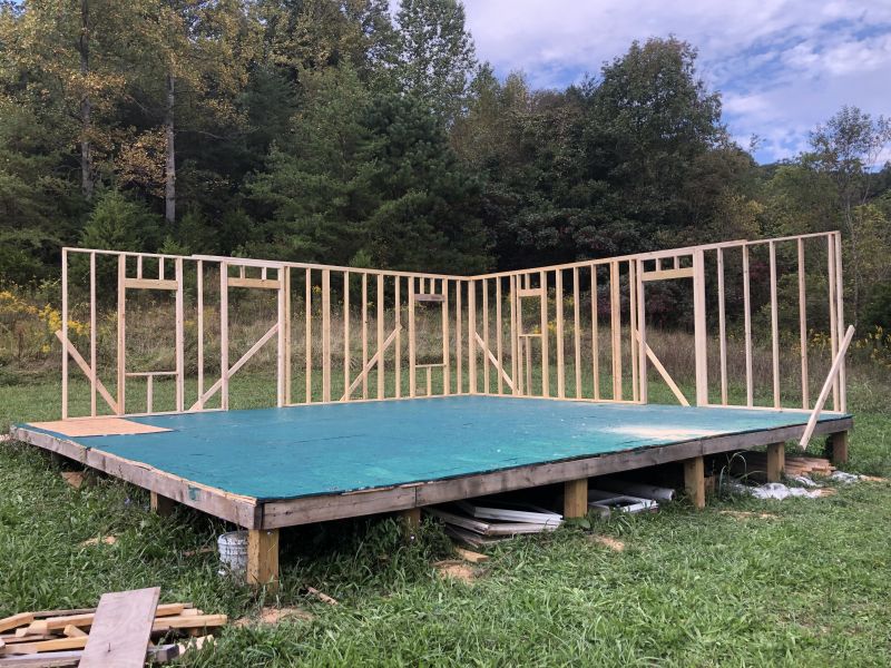

I just looked at the second set of pics. Looks like shear testing of nails is underway. Fortunately the ground is only inches away, ready to offer its support.
Jason - Lumber is expensive. I'd hold off on any further investment until you've had some professional assistance to review what's been built thus far. Also, check out the 'Larry Haun' framing videos on Youtube. He's a legend, and shows std stick framing building practices in great detail.

No jack studs on any of the window/door openings by the looks of it either.
Please take some time before you sink any more nails and watch a few framing videos. It's going to be way easier to fix now rather than later.

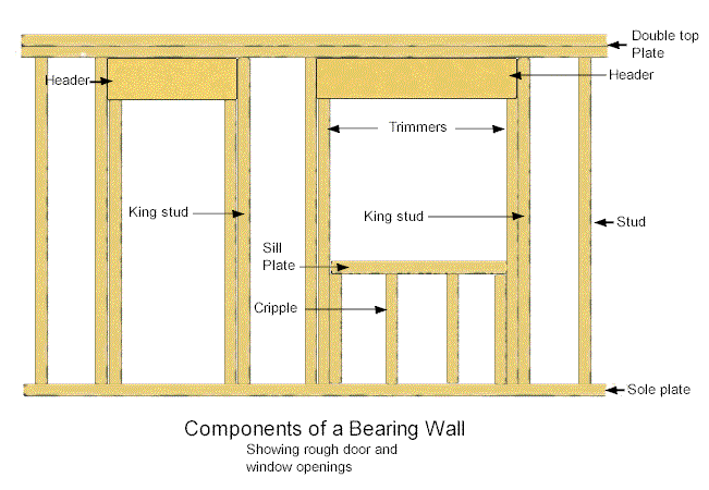

For the window and door openings. Notice how the jack stud is under the header and goes all the way down to the bottom plate of the wall. The strongest wood to wood connections are ones that dont rely on the fasteners. This also goes for the foundation posts. The posts should be notched to accept the floor beam/joist.

Digging out may be as bad or worse than leaving it as is. Removing soil makes a hole, a trench, a ditch or whatever we call it. That may be an great water collector. ???
Just because this is your first build does not mean you must make mistakes that will for cettain cause trouble that will very difficult to repair.
The folks who frequent this site are well meaning and are trying to save you from what are known fatal techniques.
I could see in the pictures that the 4x4 appear to be pressure treated; at least there was a tag that looked like the PT tags. Did you apply an approved preservative to the cut ends, especially the cut ends that are buried in the soil?
Depending on your location, assorted wood cellulose eating insects including termites may be getting ready for a feast. Not to mention assorted fungi, etc. which live on wood, moisture and a little warmth.
I understand budget constraints but building more than once, or in a manner that is virtually guaranteed to cost extra in the future seems to be poor economics.

I understand your situation, folks are just trying to keep you from having issues in the future. If it were me here are a couple things I would absolutely do.....
* Make sure you have lags on your connections to posts.
* Frame the headers properly with trimmers, if you haven't ordered windows then just shrink the size of them so you don't have to take any studs out.
* Install a large overhang on your roof to keep water away from your foundation.
* Kill all the vegetation around the building and put down some stone.
* Make sure the ground is graded so water doesn't run underneath your building.

Always build in compression, not sheer.
Your floor joists are in sheer loading.

Jason, the size of the post isnt what we are questioning, look how the rim joist/floor joist are hooked to those post. Are they screwed or nailed? All the entire weight of that house will be held in place by screws/nails. It might even collapse before you are even finished building it. But it WILL collapse. It will drop onto the grade.
Are those post on a footer? You could sister a 2X6 on the side of the post under all rim joist so the load goes through the wood to the footer.
Headers is actually the smaller issue and easier to correct. Now is the time to fix it, not later.

This reminds me of my first build, a large shed in the backyard of my first house to hold a dozen or so motorcycles. No headers, no jack studs.. 20 years later it was still standing, new owner tore it down, non-permitted. And yes, a century ago houses were done similar, and probably lasted the life of the builder.
That said, if you are going to go through the work of finishing the inside, electrical, plumbing etc., now is the time to correct the things mentioned above, most importantly to transfer the sheer to compression loading on the floor.
