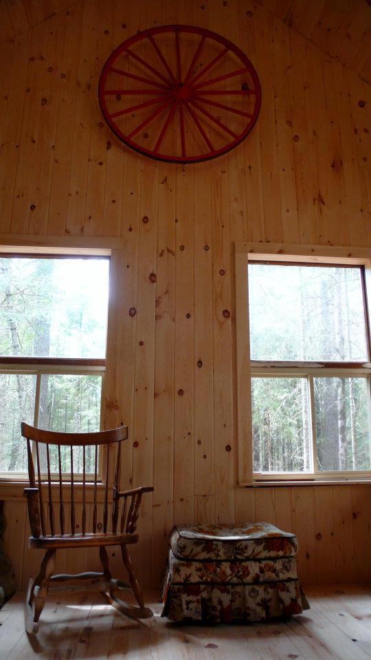

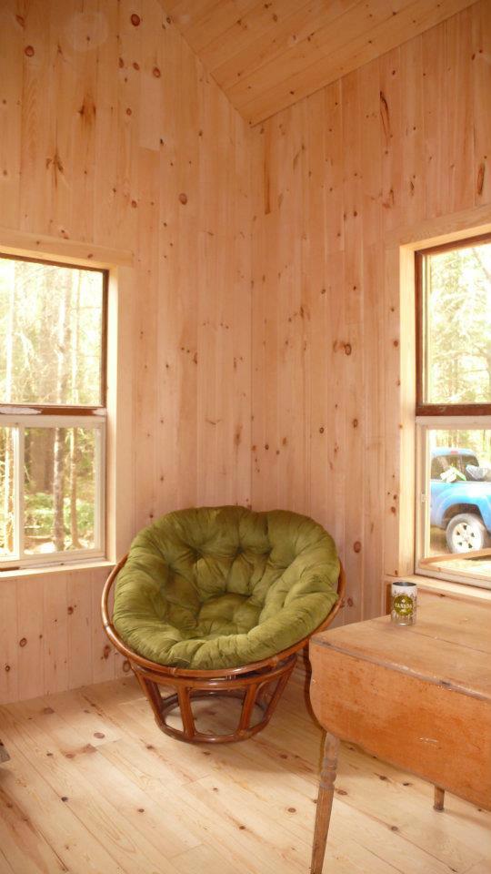

We decided to build a porch in the front and screen it in. Its great to get away from all the bugs.

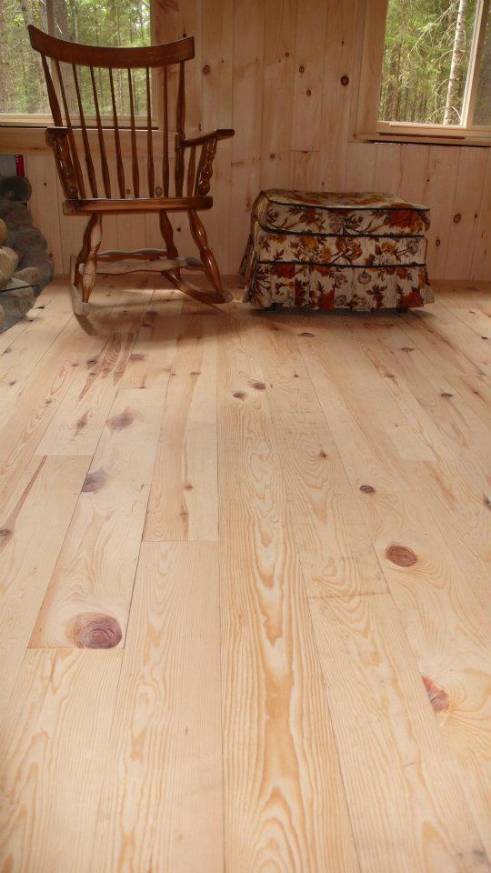

We also installed red pine hardwood floors. Just need to be stained.

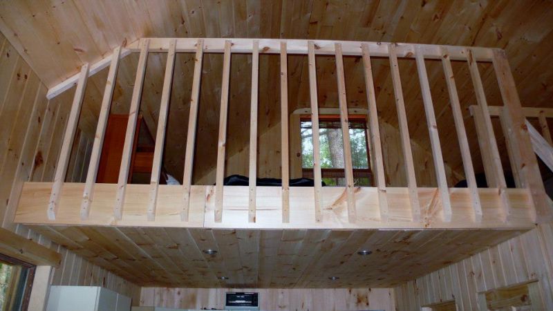

# Posted: 22 May 2012 01:31pm
Heres a few more

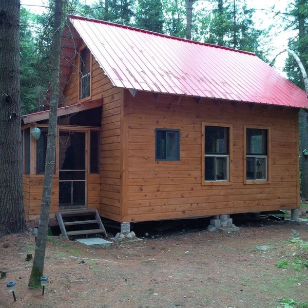

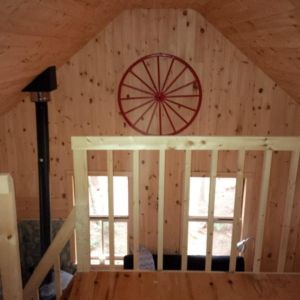

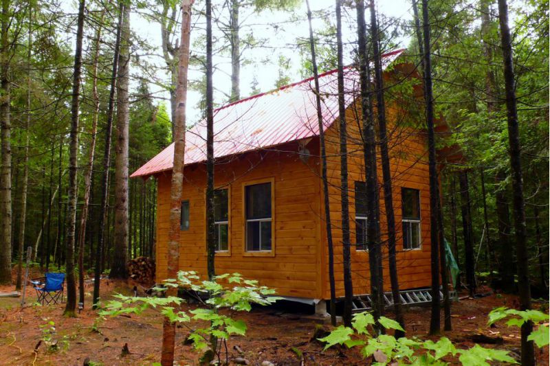

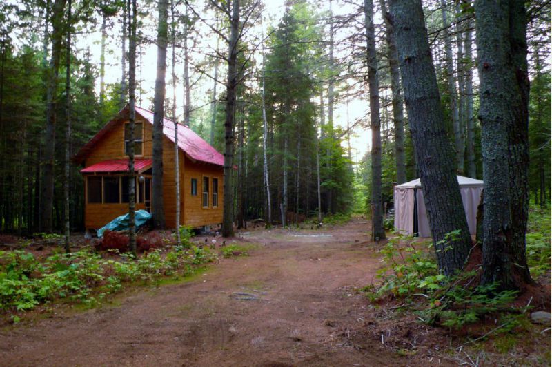

Its been a while, but I thought I'd update and post some new photos. Cabin is all finished!!

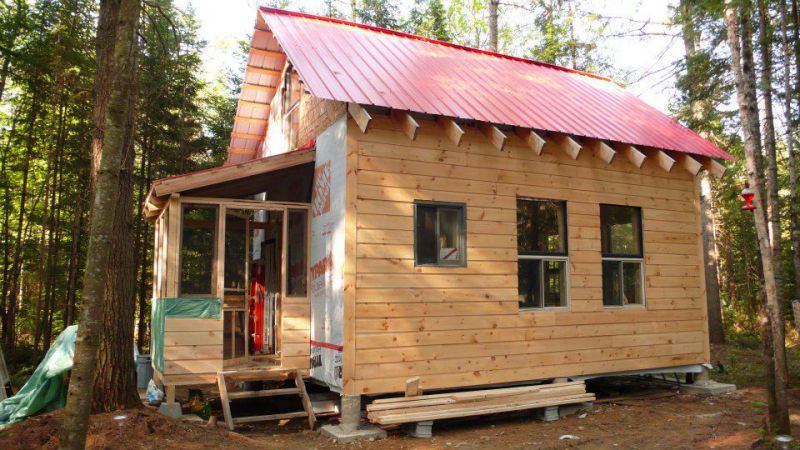

Hello fellow Quebecer !! We're almost neighbours !! I'm behind Danford lake and I'm a few minutes from the picanoc river which starts up around your area I think ? I'm starting to build in the spring and I originally was going to go 16x20 but I think I'm going 14x20 to save a few bucks ! How much did your tin cost you ? I'm thinking of going with Ondura asphalt 4x6 panels their 19.99$ a panel at lowes and seem like there easier to work with than tin , but I still haven't decided ? Your cabin looks great !!

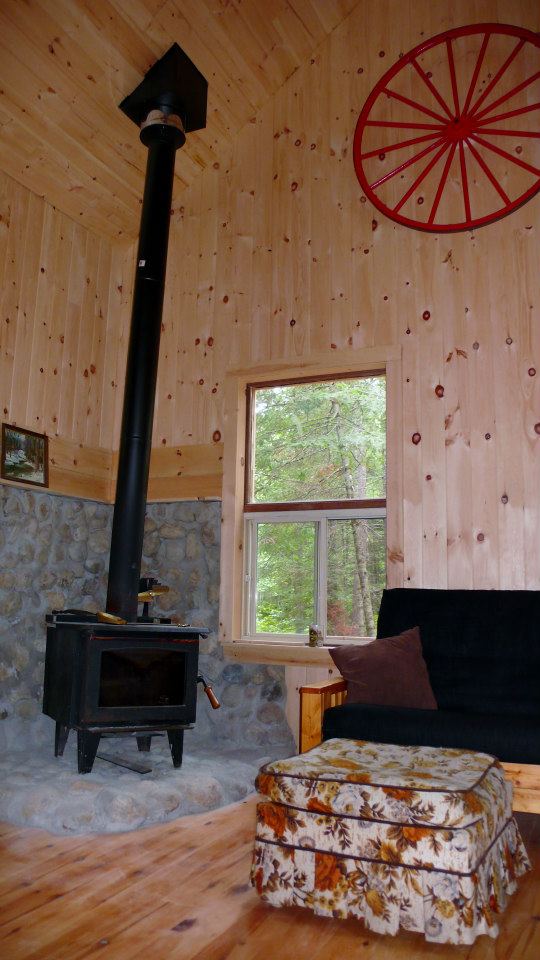

Looks like a little piece of heaven to me. I really love the wagon wheel on the wall. Beautiful place!!

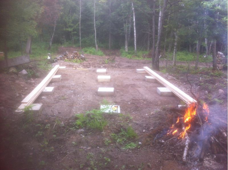

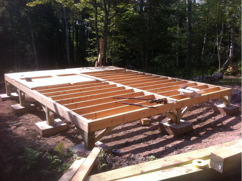

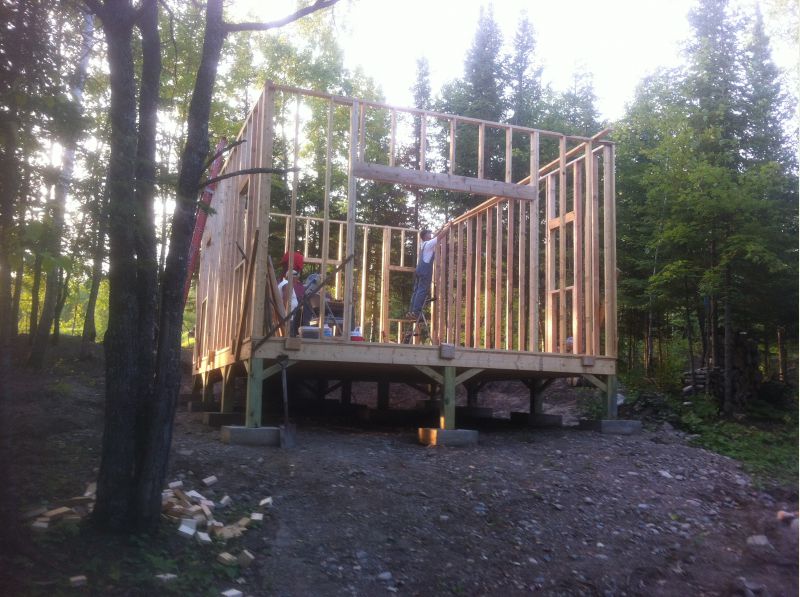

Very nice pictures mark, and great cabin. Looks like you work very fast! How deep did you put the footings? Or are they sitting on bedrock? The pictures really show the foundation process very simply, I am trying to figure it out in my head when I am ready to build.

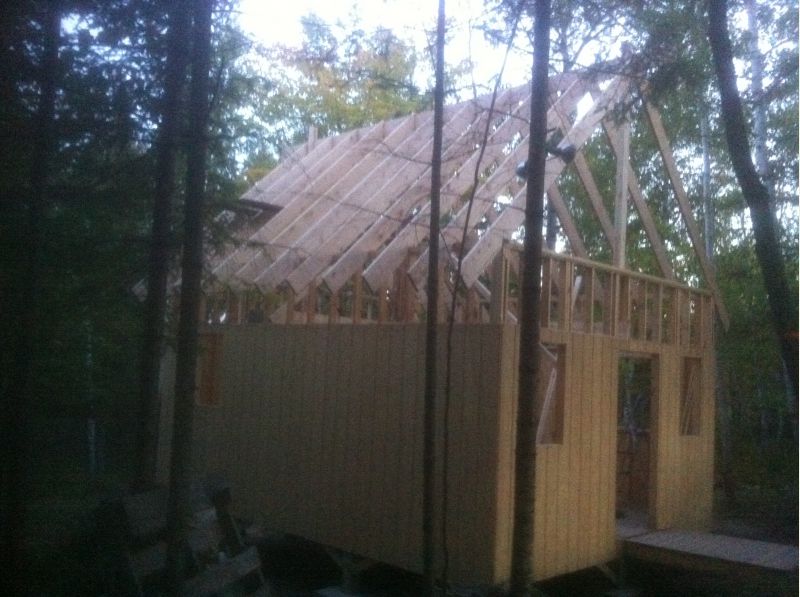

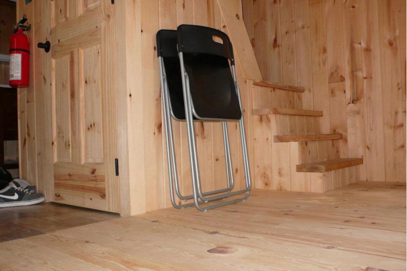

Great looking place. I see you have your walls with the vertical pine. Is it T&G? What did you do between your wall studs to attach the wood vertically?

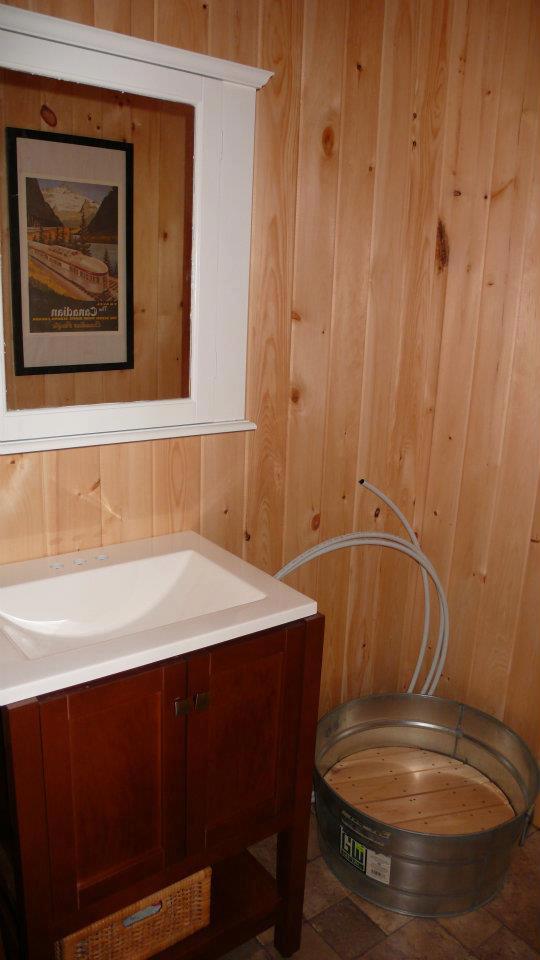

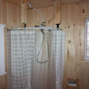

Thanks for all the pics. This is one beautiful cabin. Many years enjoyment ahead. Is that going to be a bucket shower in the bathroom?

I dont have a material list, but I did 3 built up beams out of 2x10's with joints in between them. The middle beam sits under the joints and the two end ones connect the joints.
I didn't dig cause the ground there is very gravel and all the neighbors cabins are the same and they said their cabins have never moved in 25 years so I did my foundation footings a foot in the ground. and then I put sonotubes one to 2 feet high.
For the roof, I used standard 2x10's by 16 feet and just cut the angles in them for my rafters, then I placed 2x4's horizantally every foot, then I placed the metal tin on.

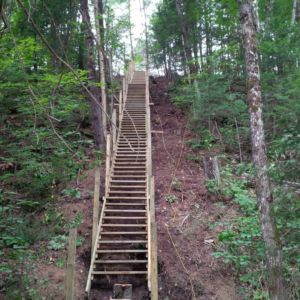

Built a massive staircase going down to the riverfront, counted 104 steps with one landing in the middle and a landing at the top.
Installed a water tower and all the plumbing inside the cabin. Bought a instant propane camping hot water tank, it works great, runs off a 20lb tank and I installed it on the outside of the cabin. I had it on medium and it was pretty hot. Its from ecotemp, Cost only 225 with shipping to canada.
