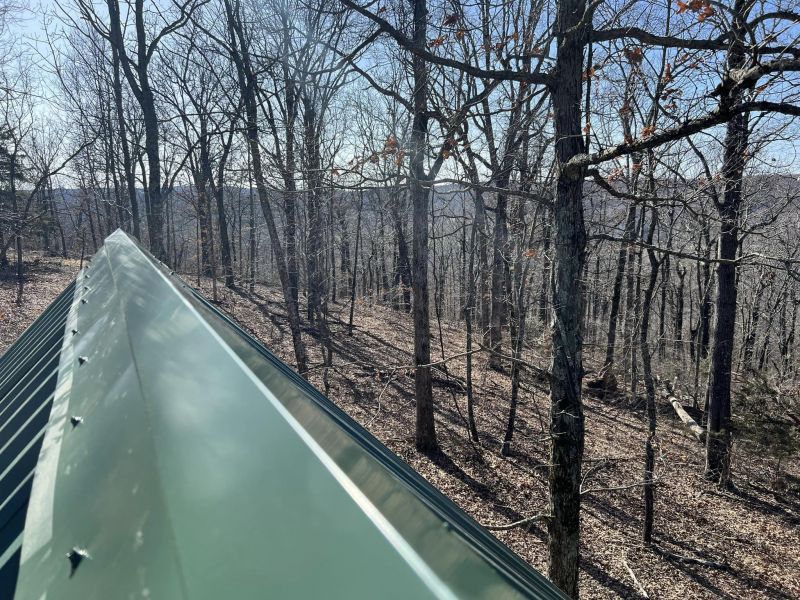

# Posted: 13 Jul 2023 09:17am
Roof deck and water proofing

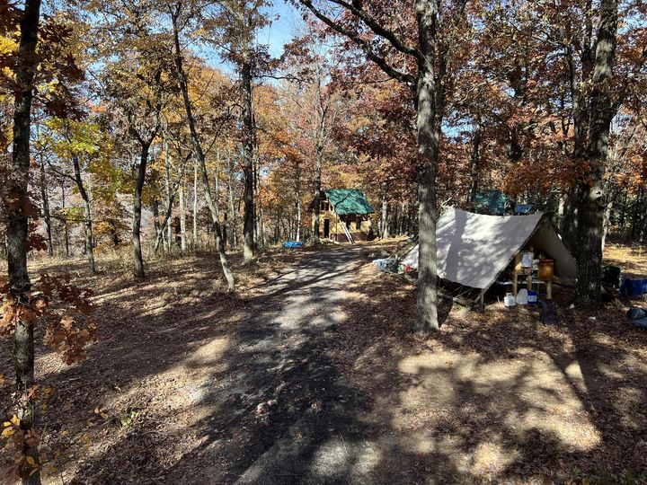

# Posted: 7 Dec 2023 11:35am
More Road and progress to date

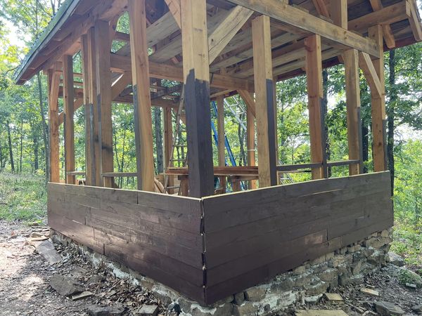

spencerin
# Posted: 7 Dec 2023 07:43pm
How deep does your stone foundation go? Any concern about front heave, shifting, cracking?
glburrows
# Posted: 8 Dec 2023 07:55am
I picked this location because there is a solid rock shelf that gave me a great place to put a foundation. I do not expect any problems from freezing but I do need to grout the joints. This was my first fieldstone foundation with mortar - there is plenty of room for improvement.

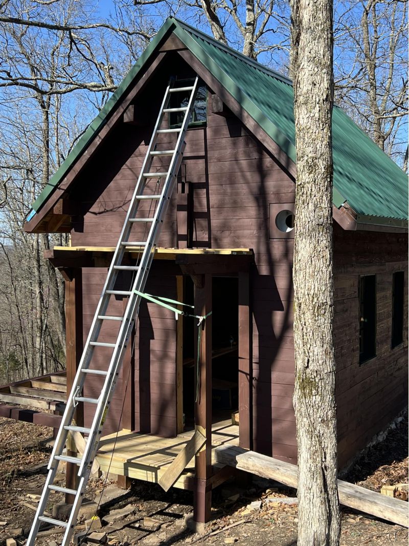

# Posted: 15 May 2024 02:31pm

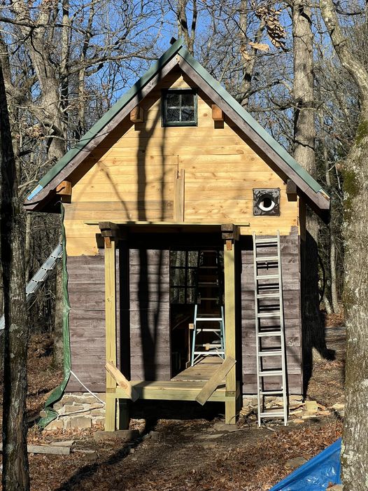

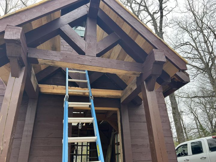

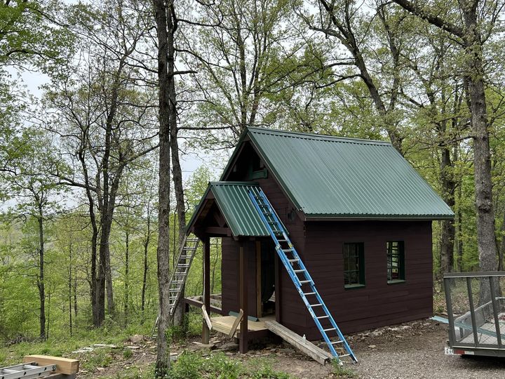

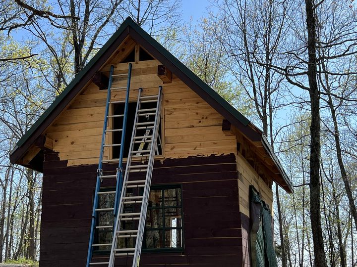

Entry Porch Construction
glburrows
# Posted: 15 May 2024 02:32pm
Completed porch roof and painting the north face
Grizzlyman
# Posted: 15 May 2024 10:36pm - Edited by: Grizzlyman
Looks great!… LOVE timber framing

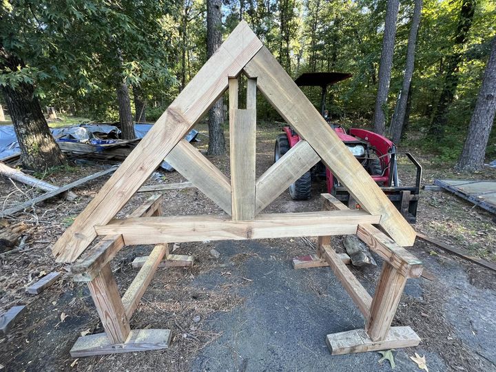

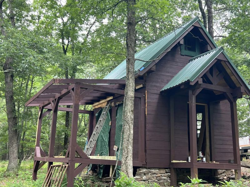

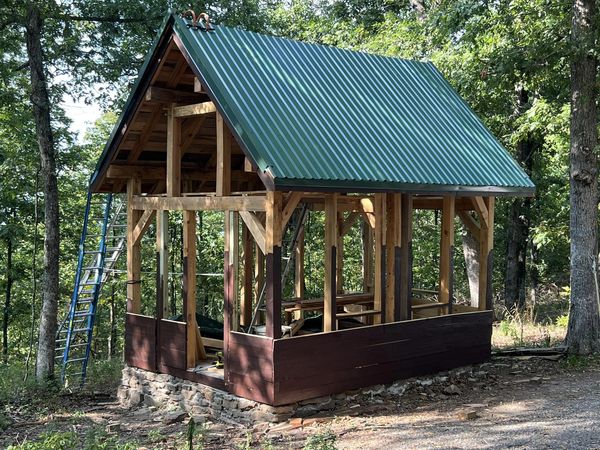

# Posted: 2 Jul 2024 03:59pm

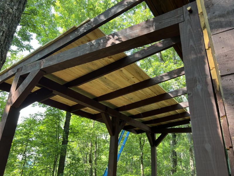

Back Porch Construction
glburrows
# Posted: 2 Jul 2024 04:00pm
Back Porch construction
Curly
# Posted: 2 Jul 2024 04:53pm
Do I see wood pins in some of those pictures, or have I had too much coffee? Your cabin is developing into a fantastic place. Congratulations!
glburrows
# Posted: 2 Jul 2024 05:12pm
It is a timber frame with mortise and tenon joints - all pegged together with oak pins

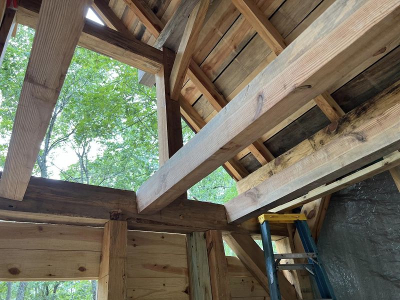

glburrows
# Posted: 2 Jul 2024 05:14pm
Porch and Interior Progress
Alaskajohn
# Posted: 6 Jul 2024 03:44pm
You do great work. I am learning a bit from studying your pics!

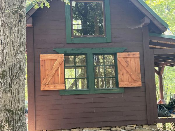

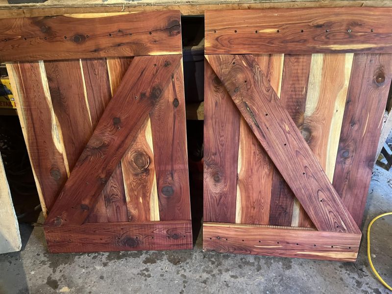

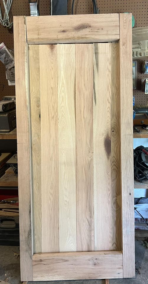

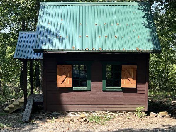

glburrows
# Posted: 26 Aug 2024 07:10pm
Shutters
