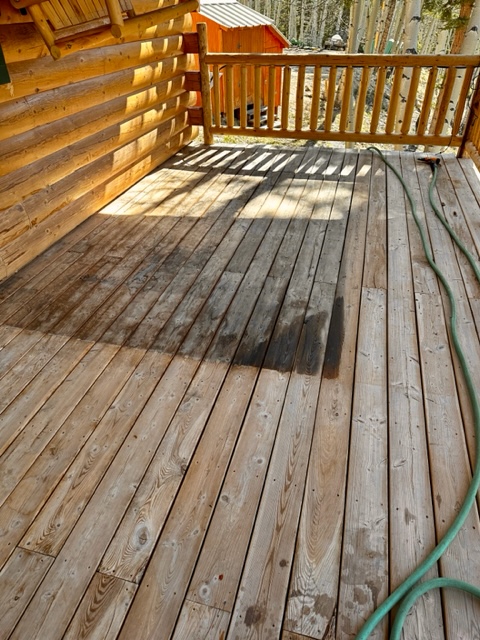

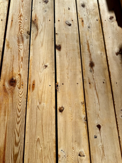

 I'm probably late to the game here... many of you likely know this.  Oxalic Acid.... it's a wonder cleaner!
 Our back deck though covered was grayed out really bad, looked ugly.  We want to stain it but it was so gray that just putting stain on it was not going to help it blend into the new wrap around deck wood. I was not looking forward to sanding a 10' x 26' deck!  Saw something on YouTube about using Oxalic Acid to clean and brighten the wood.  Of course on YouTube it looked great.... but does it really work?  I can now say yes!  It didn't make the wood new but this deck has been weathering for over 10 years and now the gray is gone.  I did two applications, the first basically sprayed it on with a garden sprayer, let it soak until it started to dry in spots, then hosed it off, no pressure washing.   The second coat I let it dry then hosed it off.  Definitely like the results and have no reservations about staining it once it dries thoroughly.
 BTW... Oxalic Acid is a natural,  plant based product so pretty environmentally friendly.   It's still Acid so treat it as such... gloves, eye protection and one of those those COVID masks.  Mix 1 2/3 cups Oxalic crystals to 1 gallon of hot water.  Hope this helps somebody!

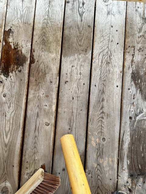

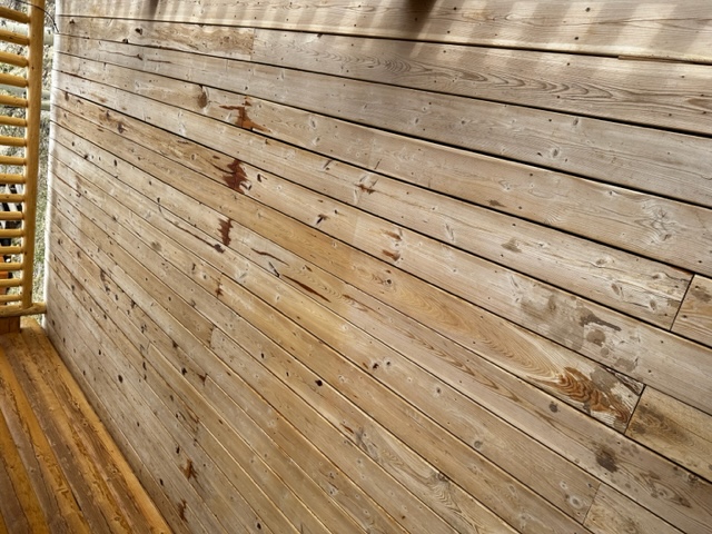

 I was amazed again this morning when I did the last section.  Now let it dry a couple days then stain.  Mid 50's here, low humidity and windy so it has dried fast already.
 Before and after on the last bit taken at the same place.
