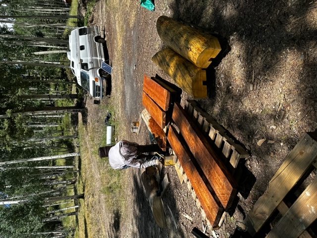

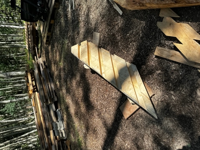

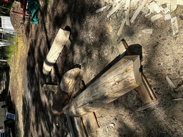

Got both stringers cut yesterday, kind of a puzzle! In the pictures the pointy end is the bottom. The slots are 2"x2" and the half round logs will have a corresponding 2" tenon that will slide into the mortise. First time I've done this design for stairs, have always notched them in, in the past... my notching skills have faded over the years! This felt like a safer, simpler design.

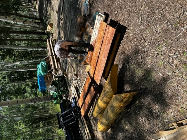

All the treads cut today and everything stained. Hopefully it all goes together tomorrow. I can see that the tenons aren't perpendicular on at least one of the treads... twist in the log... A little trimming will be in order I'm sure!

Nice treads. Cut on a mill or with a chainsaw? I sometimes have a heck of a time keeping the cut straight without rotating slightly if I cut with a hand-guided chainsaw.

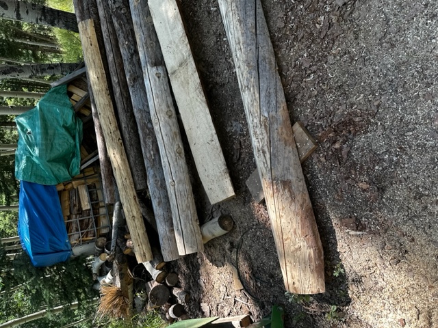

All but one tread were cut free hand with a chainsaw, hence possible twist, plus they have set since last fall. I had a local Amish mill cut the stringers.... 14" log with 5" slab cut off one side. I used one of the slabs. My shoulder is getting stronger after surgery in May but not ready for cutting logs in half!

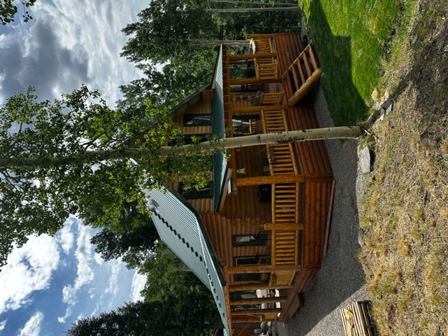

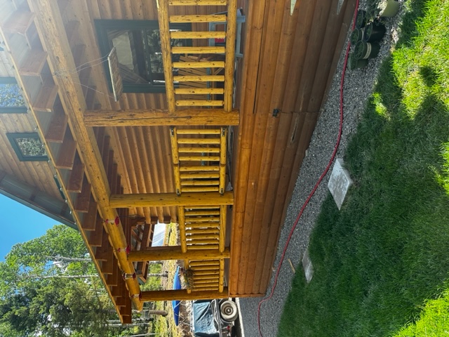

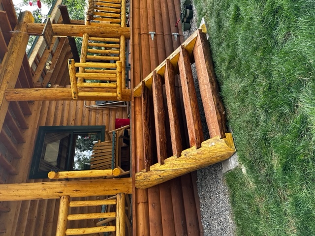

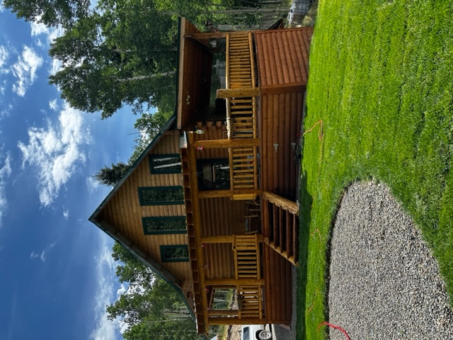

Final assembly this morning. It went surprisingly well and only needed a bit of trimming here and there on the tenons to slide into place. Surprised myself that my log working skills are still pretty good
Fastened through the log siding into the double 2 x rim joist. Three 10" Timberlok screws on each side. Treads just held down by 3.5" deck screws.
