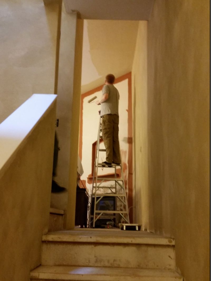

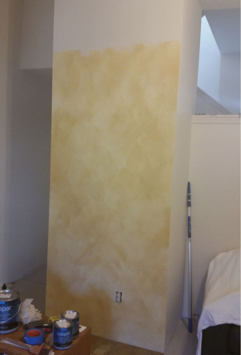

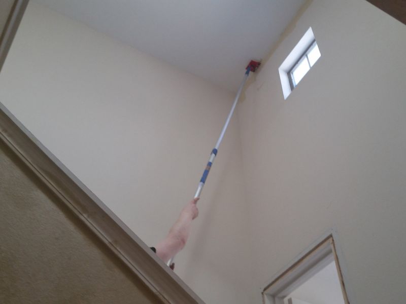

I have been working on a remodeling project with a family member. We are sharing the labor and so far have pulled the old carpeting and repainted a few rooms and hallways. It is a multistory home, so lots of stairs and some tall ceilings. Some of the walls are being finished in a "faux painting" style others in a contrasting solid color.

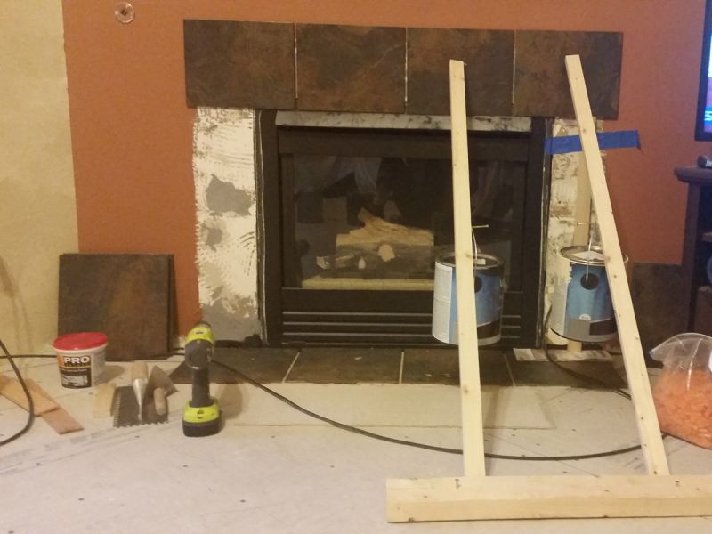

Two colors of 16x16 tile are being used on the floors. A dark tile is being used around the existing natural gas fireplace. We cut down some if the 16x16 to fit and be visually pleasing. I had to devise a method to be able to work across the top and then down the sides, a couple of tiles at a time. I am not a real 'tile person' but I have a tile saw and ingenuity, plus more time than a person working to make a living at tile work.

It's been a busy week. I forgot to mention that before we started painting walls and ceilings we ripped out carpeting and all the door and window trim as well as all the baseboard trim. We completed the painting of all the areas that are being renovated at this time; living room, dining room, entrance, stairwells, and hallways. The new tile around the fireplace was completed.

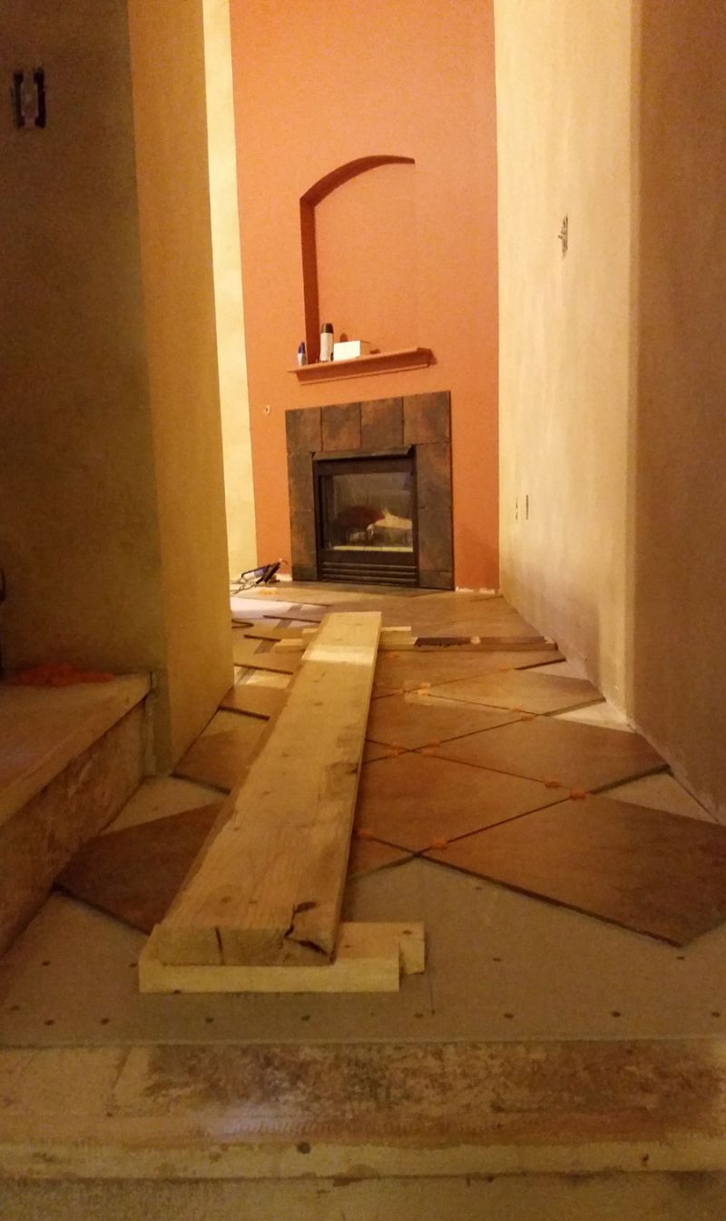

Then we moved on to floor tile. 16x16" and laid on a 45-degree diagonal. We are still living in the home as we work. It is a little inconvenient but we can manage. I would never do a renovation this way for anyone except myself or my immediate family.
The first image shows the completed fireplace tile in the background and a "walk-the-plank" over some freshly laid tile. (EDIT: I did something the forum software doesn't like, so disregard the first image. A correct version shows in the next post)

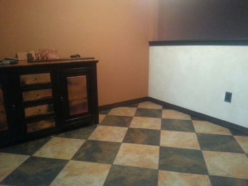

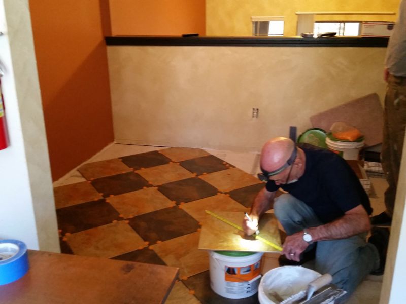

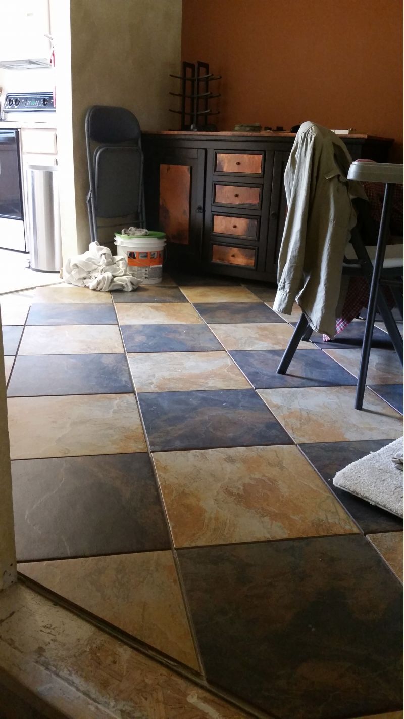

The second image is a trial layout of the dining area floor.

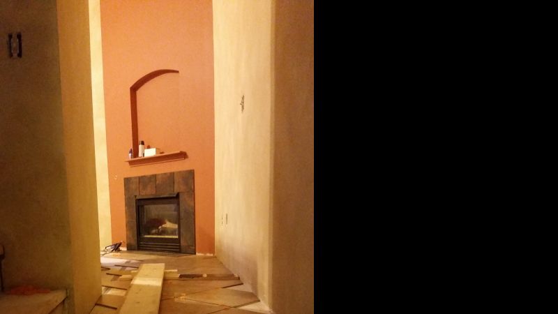

The third image is the same area with the first tiles installed. Neither of us are expert tile guys. Because of the many cuts the diagonal layout requires we decided to do the installation in a first, "from the center line out" pattern and complete the perimeter cut tiles on a second pass.

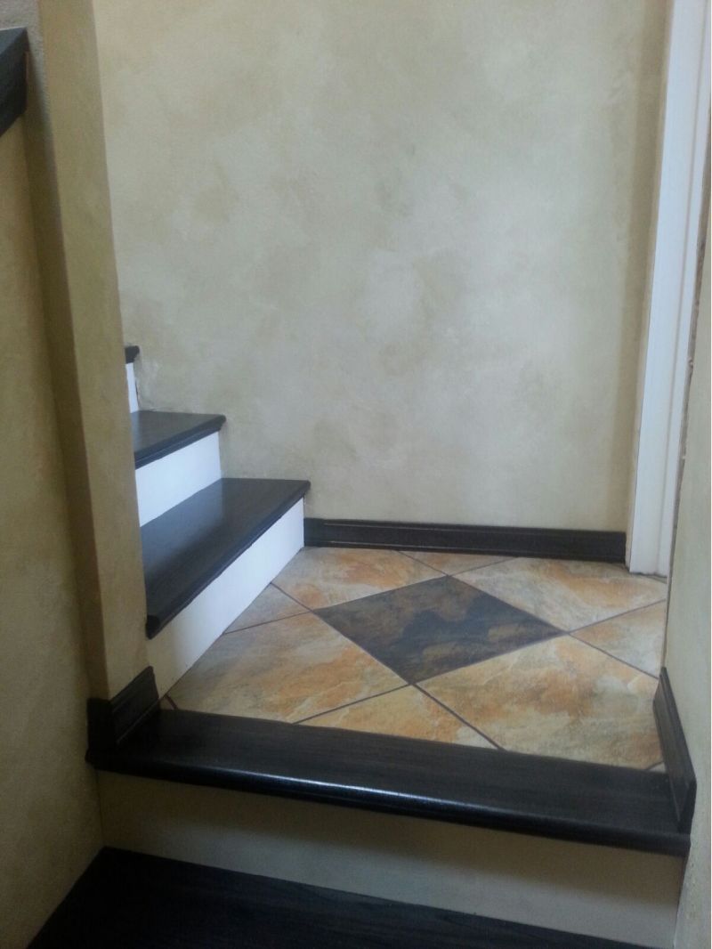

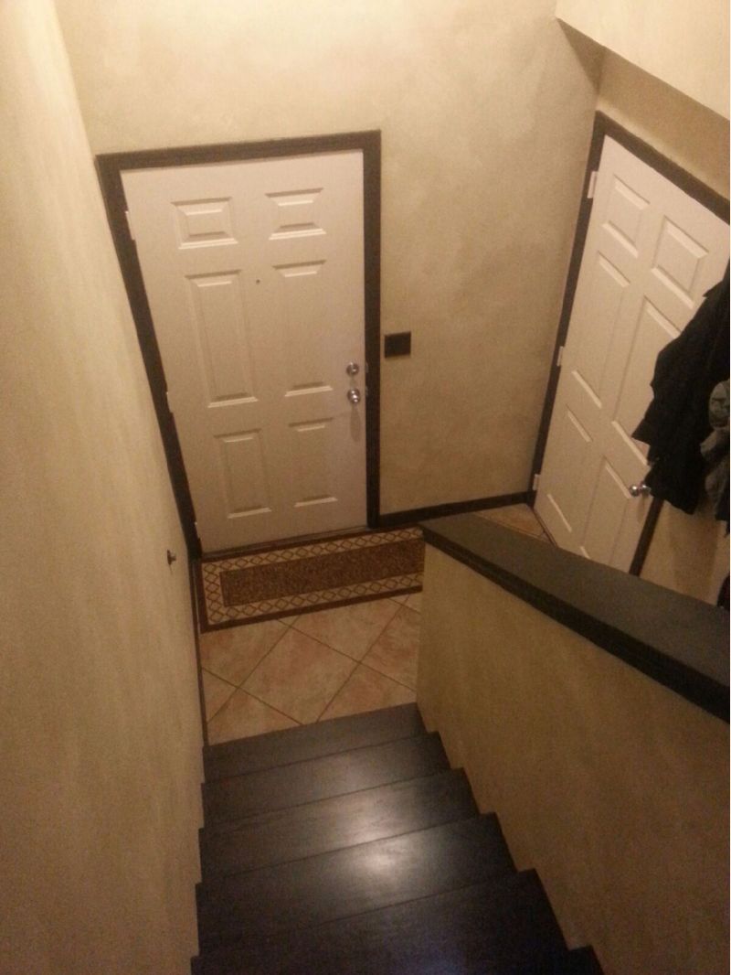

The fourth image is in the stairwell. The tile with the big blue tape X was to make it more obvious that the tile should not be stepped on. That tile was placed in the second pass, making it possible to still go up & down the stairs while the mortar for the first tiles set, and so on with subsequent tiles being laid.

# Posted: 3 Dec 2023 01:19pm
Grouting completed.

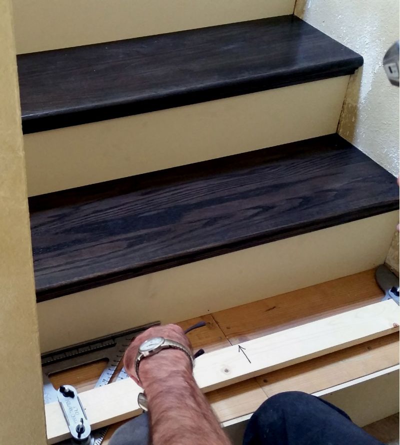

Oak stair treads stained and installed.
Oak base and door trims done.
-izzy
