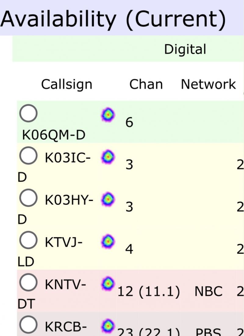

Quoting: darz5150
There are websites like TV fool,
Had a look at that. Wonderful, says I should get a few channels at the cabin and from where. Encouraging.

Well no luck at the cabin yesterday with the new antenna, despite TV fool saying I should get something. Going to try again today. In thi photo, you can just make out the antenna sitting on a 20’ pole outside the cabin. The picture is deceiving, the trees are actually 5 times taller than the pole. Not much luck getting around those but I could swear an antenna used to work before the fiber internet came along.
