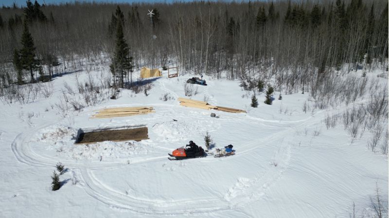

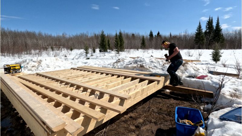

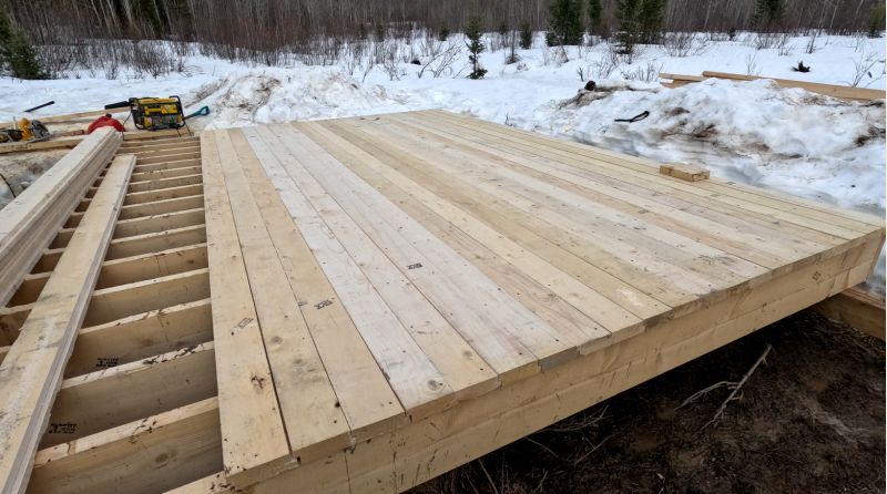

I am building a cabin in Northern Ontario, in the Arctic Watershed. I've been working for a couple years prepping the land for a build. I started hauling in lumber in 500lb loads with a snow machine, the easiest way to haul. I have river access in the summer. I have winter road access which is good for a snow machine. In the summer, I can go by ATV over the road but i may have to winch in the muskeg. Not ideal for hauling. Boat works best in summer, then I have to haul with my ATV from the river to the clearing. It is wild land. I moved a tractor in last spring when the snow was gone but the land was still pretty much frozen.
I am building with rough cut lumber from the mill. I spent an afternoon digging out the clearing from 3 feet of snow two weeks ago. I am starting with a modest cabin, the bears like to fool around with our stuff so the girlfriend would prefer more then a tent to sleep on the land. I build the floor out of rough 2x10 on 12 inch centers to cross the 12 foot span, then shiplaped 2x6s to run the 16 foot length and keep the wind and critters from coming up after the planks dry. I have attached some photos. I did a video of hauling the wood, and starting the build here if anyone is intrested in the process. It is an eight hour drive to my property so i work in two week stretches when i can get away. My plan is to get the outside done this year and as I do make more build episodes. Thanks for letting me join, I have been reading this forum for years, just didn't have anything to post until now. https://youtu.be/Wh8Aqccw-ko?si=21iqMTVkeuHrsOSW
Floor
Floor
Joists
Joists

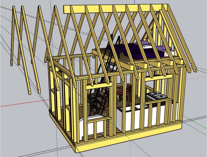

Plan
Plan
Aerial
Aerial

# Posted: 29 Apr 2025 11:09pm
Ime it seems to go faster after the deck is done
offgridengineer
# Posted: 30 Apr 2025 09:48am
I can see that, when I was hauling for a week I told the GF that I was eager to work on the fun stuff. After a few days laying the deck I realized I was not yet into the fun stuff, lots of care and consideration, and things don't move in a vertical direction very fast.
Looking forward to going back up in two weeks...

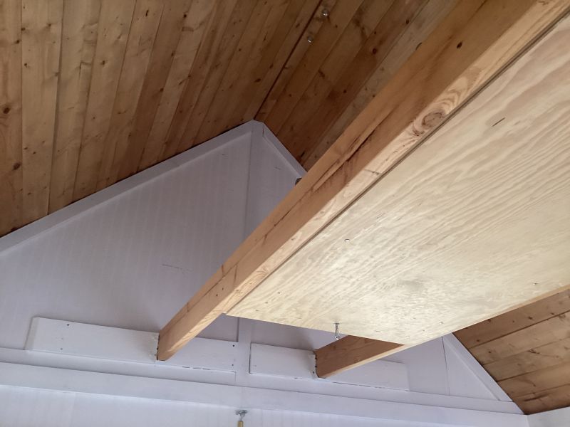

You’re not ready yet, but, consider a folding attic ladder for the loft. Gave me much more room inside the 12 x 18. Easy to operate for the ladies also.
I decided not to cut sinks into the countertops. Use washbasins for cleanup. Gives me a bit more counter space.

Good ideas, folding attic ladder usually goes through a hole right? The loft i'm planning is half, curious how you executed. Wash basins are a good idea, some people I see use a sink with bucket underneath, still have to drain the bucket.
# Posted: 30 Apr 2025 07:40pm
We opted for no sink too, never regretted it. The rectangular plastic wash basins are fine for us and store under the worktop on a shelf.

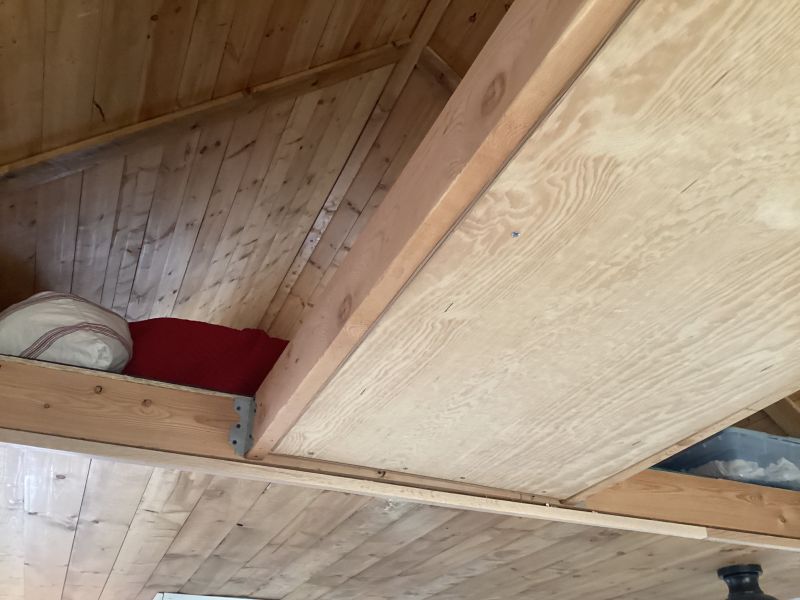

(2) 2X6 boards from end of loft to wall of cabin. The attic ladder fitted in between those 2X6’s. It can be done several ways. I just used metal hangers for those 2X6’s. Followed the directions and also still proclaim that YouTube is a great teacher. Have fun. After shoveling all that snow. It is a piece of cake.
frankpaige
# Posted: 1 May 2025 01:00pm
At the cabin this weekend. Just a couple of pictures to give you an idea of installation. At one time I had a ladder. Took up to much room. And this is so easy to put down and up.

lol, thanks for sharing this, photos helped. Its a good idea. Everything in my drawing is stuff from the sketchup library other then the wood.
How does the stairs feel? Good and stable if you have to go to the washroom at night?
frankpaige
# Posted: 1 May 2025 11:23pm
This is one of the items that has transitioned over time. Started with full length ladder. Too much trouble to move and in the way. Then. Cut in half. Still took too much effort to store. There are different levels of sturdiness advertised here in the states for attic doors. Went with the heaviest I could find. Nighttime activity? Same as a ladder.

Yeah, I kind of hate the of the ladder up to the top. I feel its not the most practical. Other options eat up floor space. I will think on it as time goes on.
I am planning on keeping the rafters open, laying 2x6 as the sheating, and then putting 2" foam on top with a metal roof. That way the inside stays rustic looking but still insulated. I will put tongue and groove on the walls probably. Has anyone done something similar with the roof?
# Posted: 3 May 2025 03:36pm
Be sure to use a waterproof membrane (better than 'tar paper' atop the 2x6's before the insulation.
You will need to run purlins on the insulation to fix the metal to.
Depending on your rafter spacing and snow load stuff Idk if you can use thinner planks on top than 2x.
