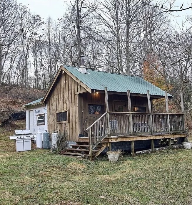

The end of April, 2025 brought my first big construction project at the cabin.

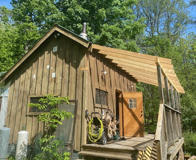

I had my little sister and my engineer dad come down from Michigan to help design my new porch roof and we made the first big improvement to the cabin. The porch was a priority so I would have a covered area to store tools and supplies while working on the rest of my projects, it has proved invaluable over the past year.
The original porch roof was more of an overhang and only extended over 4ft of my 8ft wide porch. I don't know who put it together, but it was braced incorrectly against the wall of the cabin and the main "beam" spanning the 20ft length of the overhand was two 10ft 6x6 hemlock beams scabbed together in the middle with a lap cut and just a couple screws. Interesting.

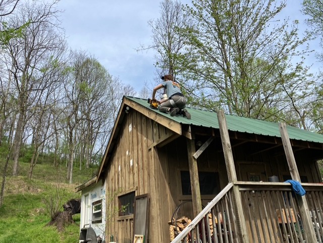

I strapped into my rock climbing harness and dangled off the top of the roof with a circular saw to cut the old metal roofing back (very precarious) then we deconstructed and took the old porch overhang completely off.
After some head scratching we agreed on a pitch, then built a header and wrestled it into place on top of pre-existing porch posts... I'm guessing the previous owner planned to extend the roof but never got around to it, the posts were left exposed to weather and were bent and wonky. We made them work for now, later on down the road I hope to cut them out and replace with tree trunks for a more rustic look.
Photos below.

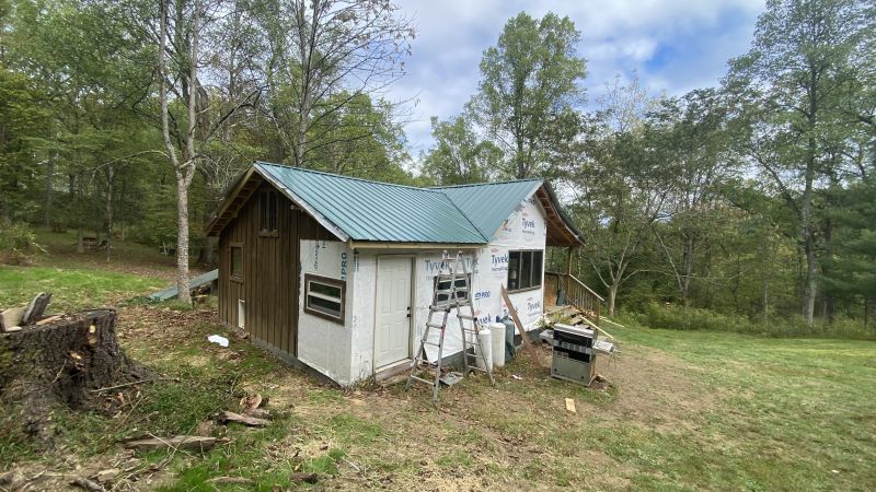

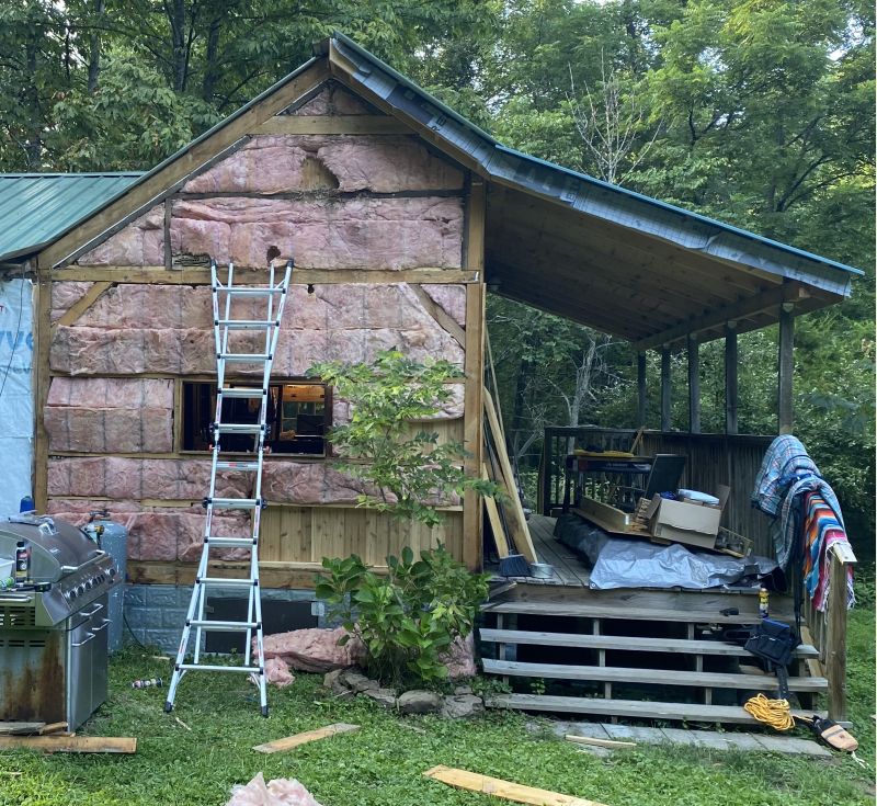

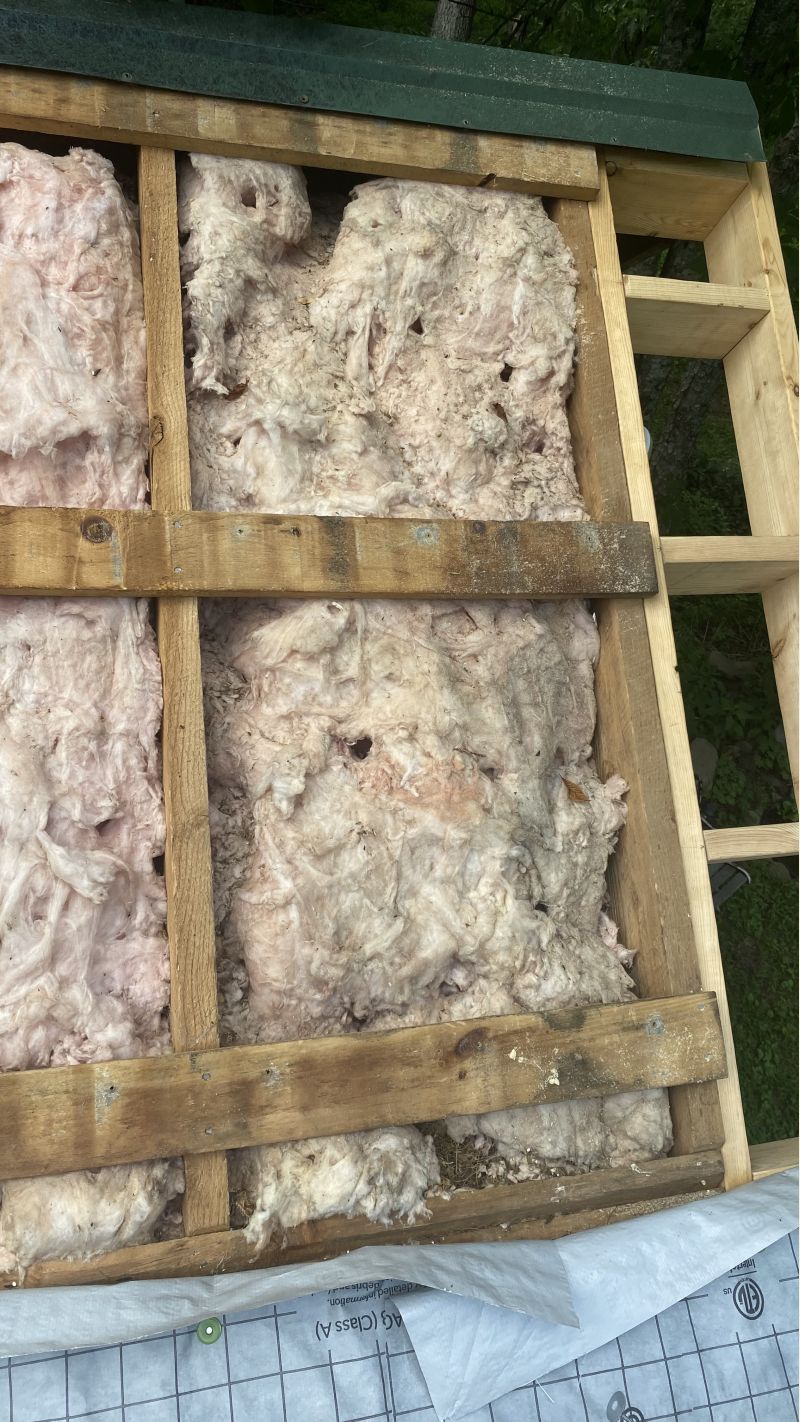

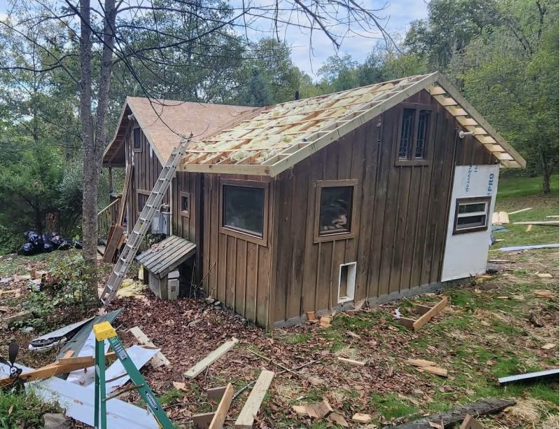

One spring afternoon walking around the back of the cabin I observed a 5-foot rat snake slithering up the siding and into the roof. The ensuing investigation revealed that my metal roof was simply screwed into furring strips on top of the rafters with no sheathing underneath, leaving my ceiling and insulation open to every critter in the county. And those critters had taken full advantage, the insulation was infested with mice and I found numerous bird nests and snake skins. There was an entire ecosystem up there! Naturally the roof took top priority and so began my least favorite but most rewarding project of 2025.
I started the project by myself after my partner helped me load sheathing and new roofing panels up onto the porch rafters and doing this kind of work alone is not something I would ever recommend. Roofing is some of the hardest work I have ever done and I immediately regretted my decision to work in the humid summer heat. I found myself waking before dawn to beat the temperatures and get as much knocked out before mid-day as I could. I was able to complete 1/3 of the roof by myself and managed to do it without falling through my ceiling and breaking my neck. I consider that a success. I saved the rest of the project for autumn when the temperatures were milder. My partner, brother, and I rallied and knocked it out together and in the end the entire roof was sheathed, protected with synthetic underlayment, every nook and cranny was sealed with rodent wire, and brand new roofing panels were installed on 2” furring strips. New gable ladders were also installed on 3 sides and the rotten, water damaged overhangs were repaired and rebuilt. We all agreed it was the first and last roof we ever want to put on!! Ha!

# Posted: 4 Jan 2026 11:42am
A few more photos
My trusty helper
My trusty helper
Mouse infested insulation I replaced

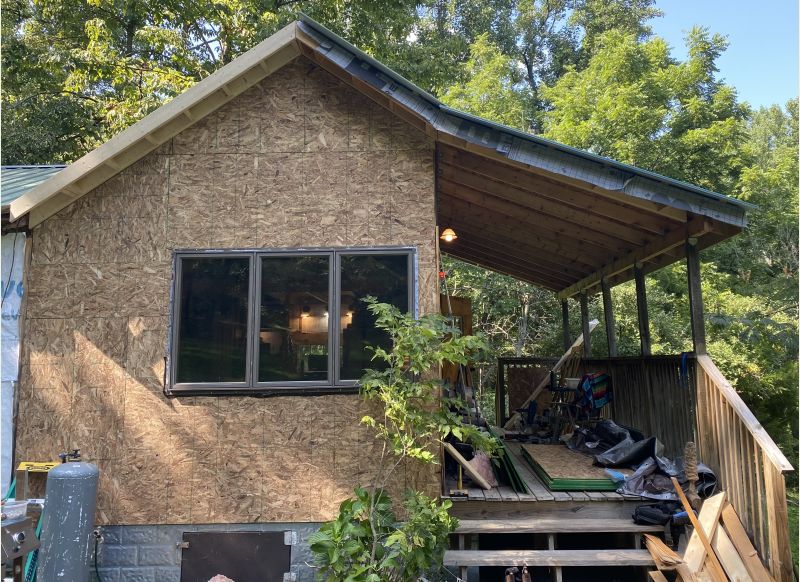

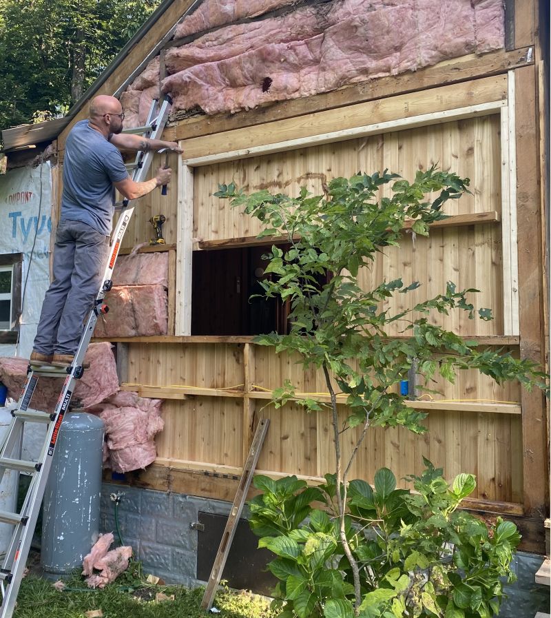

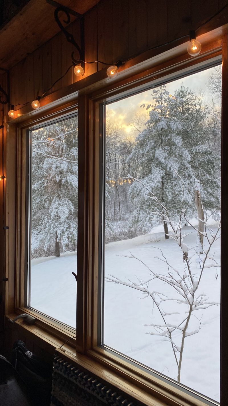

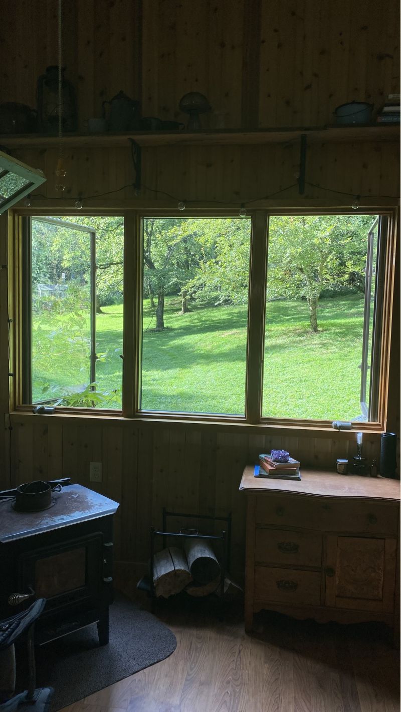

This one will be short and sweet… my favorite project since buying the cabin is my new living room window. The original cabin kit came with 2x4’ barn sash windows hung much too low for my personal taste. After scouring FB Marketplace, I found an amazing Andersen triple casement window in Morgantown a couple hours away and was able to get it for $200, a steal. Vinyl exterior, wood interior and 4x7’ of beautiful glass.
It was too heavy to install by myself so my neighbors came over and helped me. Here are some pics from that day. Note the post and beam construction of the cabin, visible with the siding off. Adding windows and doors has been a breeze since I don’t have to worry about wall studs.

Framing and header for new window
Ready for new window
There she is!
There she is!

And the view! Summer and winter.

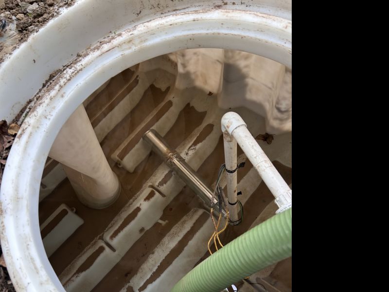

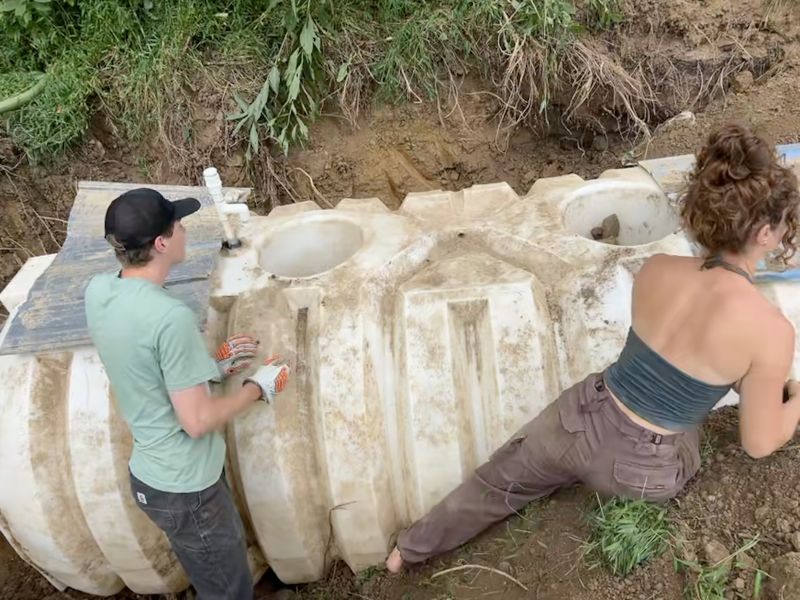

Long story short, not only was the well not producing, but my 1,200 gallon cistern was not holding water and was floating out of the ground where it was buried due to not being properly seated by the irreputable company that drilled the well. In August a neighbor brought his excavator over and worked at my property for 4 days unburying my cistern and re-seating it. He also worked on my driveway and flattened/graded the steep hillside directly behind my cabin. He did great work and was very affordable, I paid $2,000 for everything.
During the whole ordeal, we also discovered that the plumbing from the well to the cistern had come loose when the cistern floated and that is why it was only holding water up to a certain level and was sucking mud into the tank. That was a relatively easy fix, thank goodness. We washed and bleached the cistern then reinstalled and replumbed it.

Filling inner columns with rock to add anchor weight and prevent floating

# Posted: 7 Jan 2026 09:35am - Edited by: gcrank1
Fwiw, around here that kind of false statement from the real estate agent puts them liable for 'damages'; its a non-disclosure of issue thing.
Put up eve troughs to catch water from the whole roof, run that through a '1st flush diverter (you can diy, look online) and a decent filtering system into a 55 gal food grade plastic drum elevated a bit at the cabin. Pipe the overflow from that to your cistern. That way you will have a drum of water close by (that is all we have at our off-grid, dry cabin for utility water).
You may want to also look at what is necessary to 'develop' a spring with a spring box for a fall back supply, not to pipe in but to bucket in. We call that 'running water'....when you run out you run back to get some more
