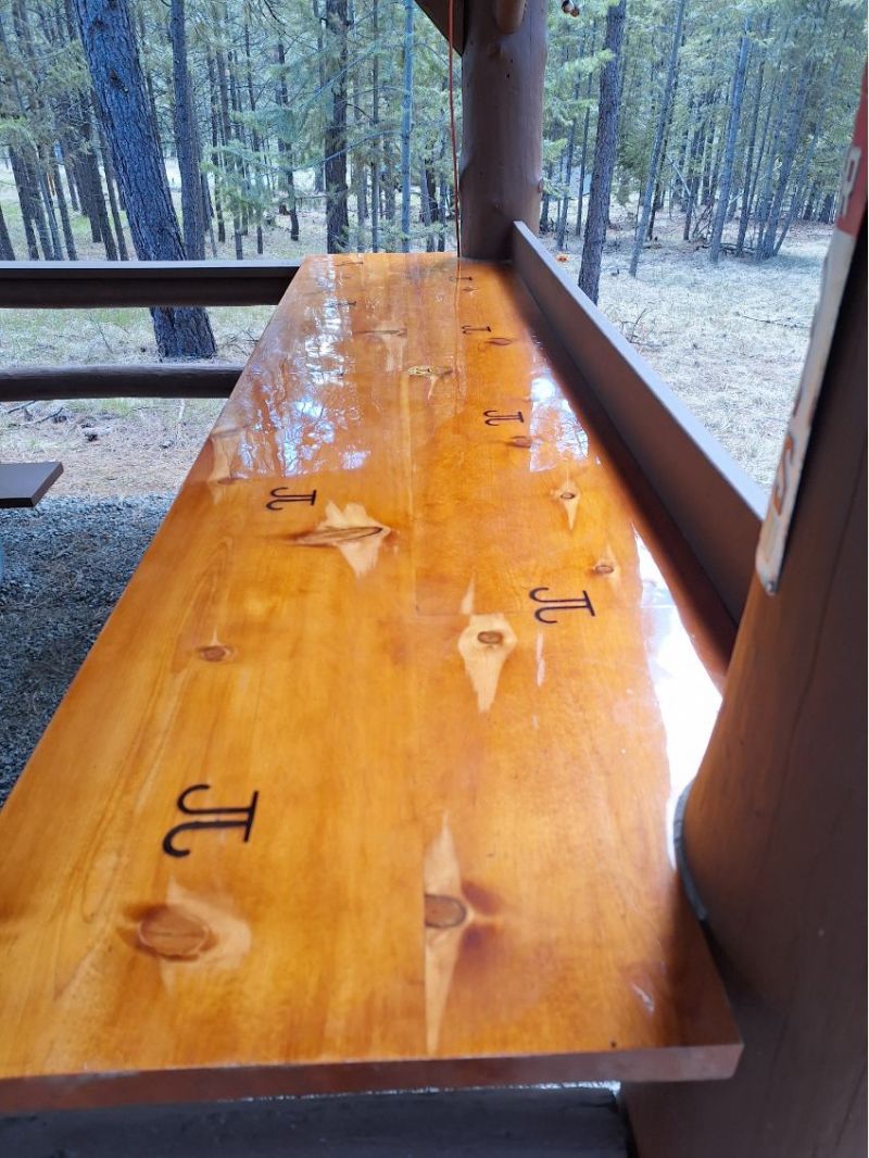

This was plain old growth boring ponderosa pine, looked almost white. I did nothing to it but put on stone coat, I added no color, glitter etc. Man did it pop with nice reddish looking color.

That does look good Toy! Which particular product from Stonecoat did you use?
# Posted: 4 Jun 2026 04:01pm - Edited by: toyota_mdt_tech
I used this stuff, 1/2 gallon
You can paint it before, add marbling, glitter, mica. You can pre paint the surface, or you can add color and glitter to the stone coat or add streaks after its laid down.
Watch youtube videos on the endless ways you can make gorgeous countertops, floors, table, furniture, vanity including sinks, add stickers, I have a JJ sticker dead center. Then I burnt in my brand and sealed it. I may have all the national part stickers next. I can go right over the top again. Need a propane torch and a chop brush.
