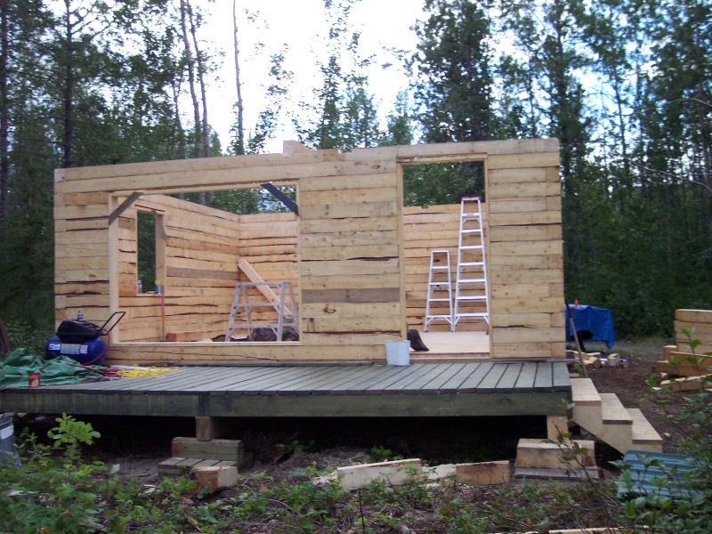

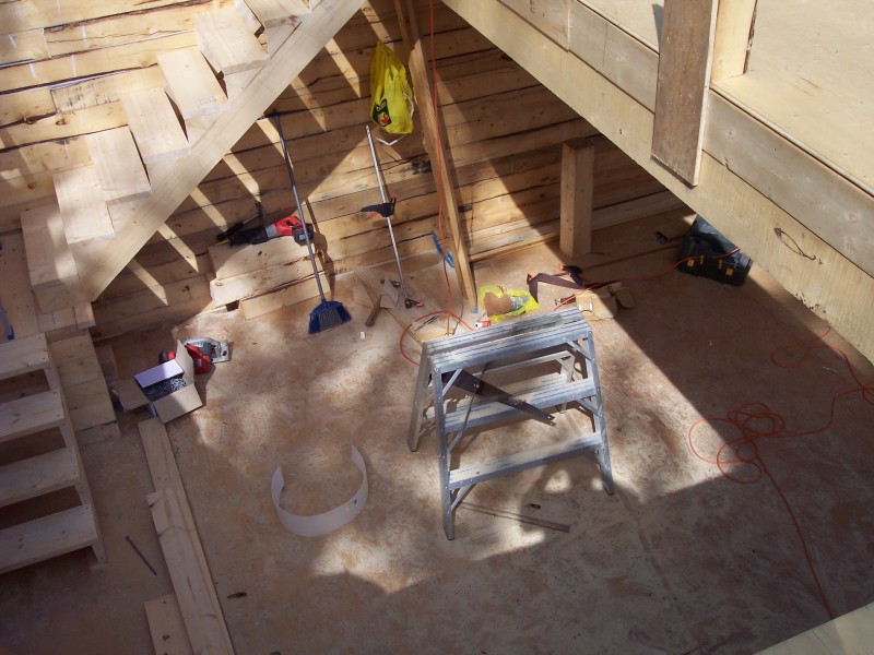

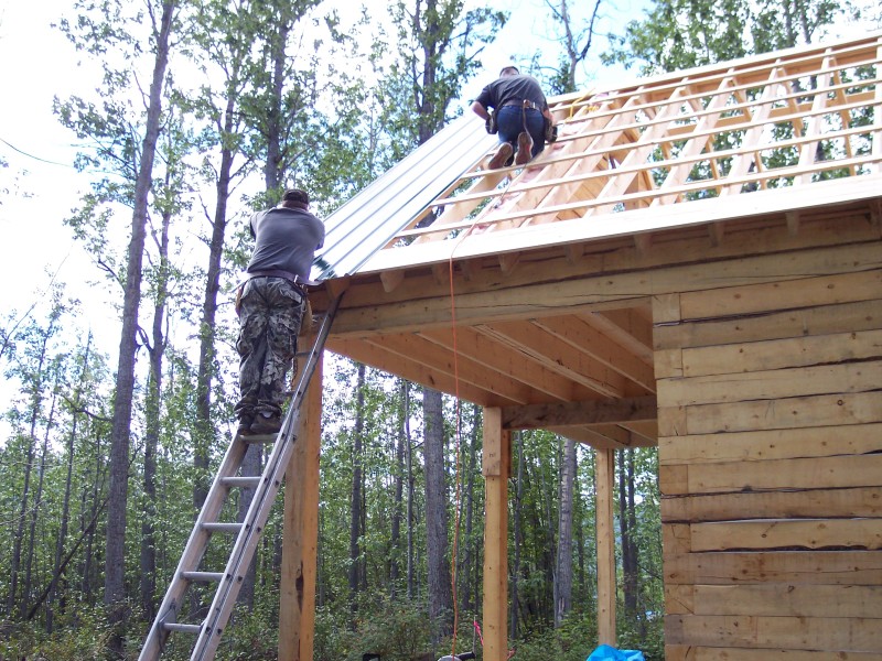

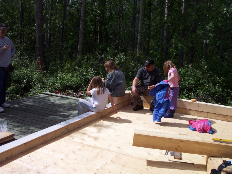

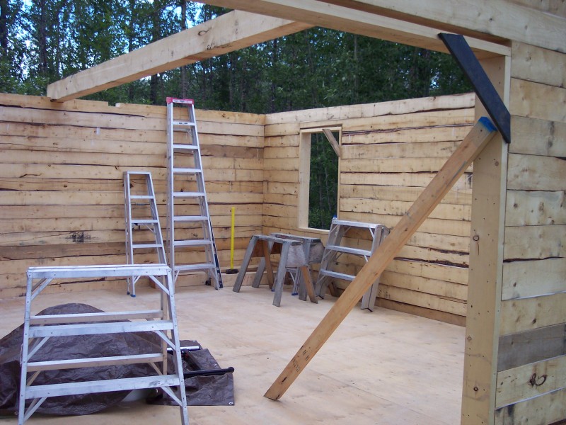

Here are a few pic of our 20x20 cabin we built last year at
Little Salmon Lake Yukon.
It is a 6"x6" log building with a metal roof.

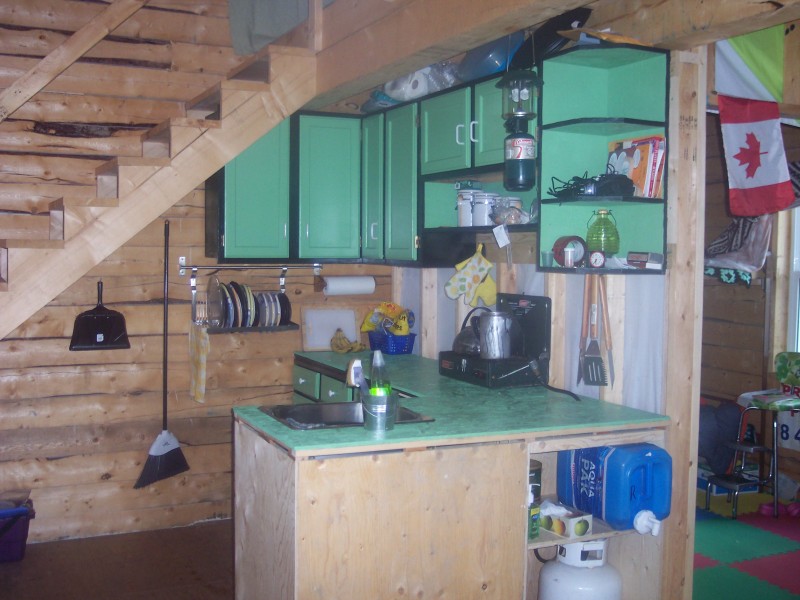

Yes it is heated with a wood stove.
Myself and my wife built it last summer with help from many friends.

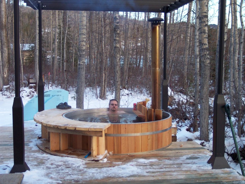

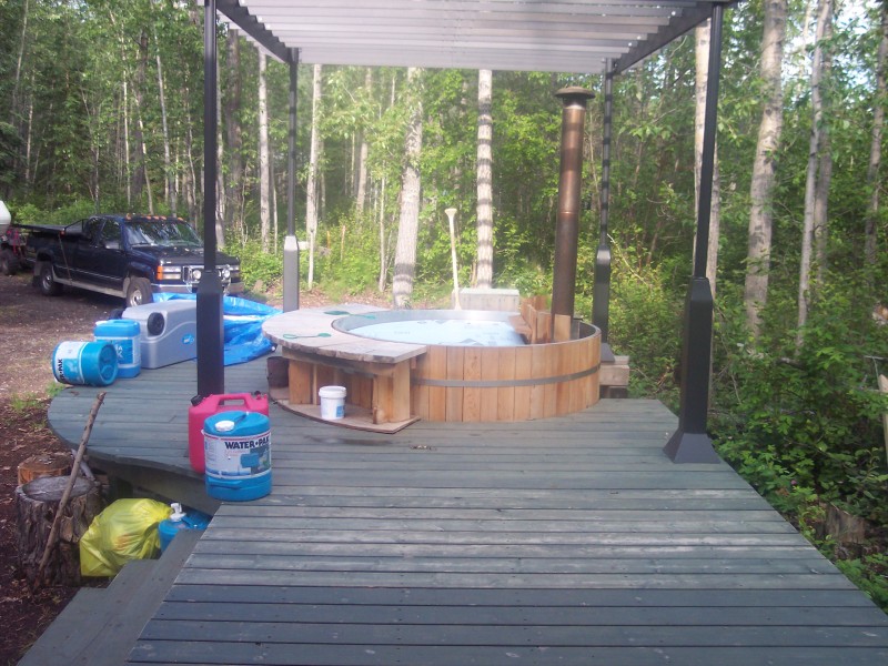

If took us about 5 months to complete. We worked most weekends and our 2 week summer vacation. We did pull a building permit but have yet to see a building inspector. So far we have invested about 17,000 into the building including a 4,000 wood fired hot tub.
I don't know what the exact r value of logs, but there is tons of info on the internet. I like the look of log and then you have no insulation, vapour barrier, and interior finish to buy.

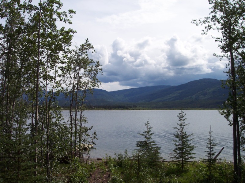

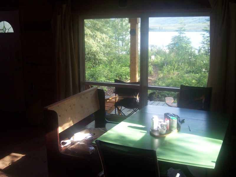

here are a few more pictures
hotwls13
# Posted: 16 Oct 2008 08:36pm
Wow! What a view!!
Thanks for the pics. :)

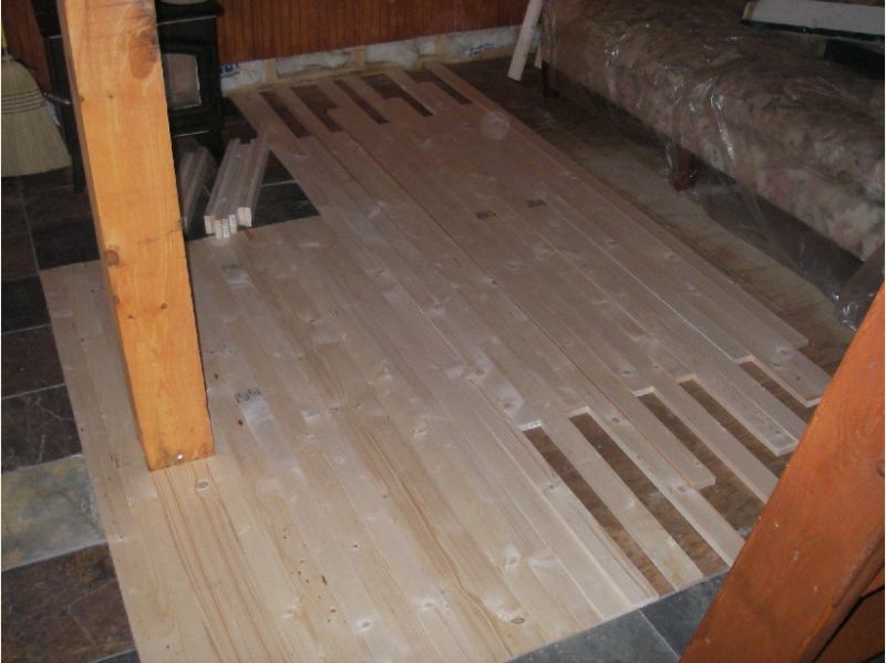

What did you decide for flooring?
Just an idea... I used 1x3 strapping nailed with wire brads, no sanding and 2 coats of Polyurethane. It's dirt cheap, looks great, but still rustic enough for a cabin. That part of the floor is warm compared to the part that I tiled with slate.
See photo of floor in progress from the summer of 07

the 1x3 strapping looks great. I would have to go through about 10 lifts of strapping to find enough that looks like that. We have not decided what to use yet but we are leaning towards 1x6 T&G pine flooring.

Yeah when i built my cabin i had so many guidelines to follow that i made sure to follow them all the way through. As i went through each step i was always told that if something wasn't installed properly or the way they required it to be they would come and remove it and make me start over. Where at my parents cabin not to far from me in a different county they aren't that strict on things at all. Oh and littlesalmon4, i see that you put those jams in to frame out for the windows. Did you use a circular saw or table saw to make slots for your screws or nails? That is needed so that when things expand and contract those slots would allow for that movement and wont pull your window this way or that?

The footing starts as compacted gravel. It is about 8" deep.
The pad is 24"x24". It is made out of 2"x8" PWF wood .
The 2"x8" is stacked and nailed 3 high.
My main beam is 3 layers of 2"x8" nailed together to make a beam.
The beam is supported in the middle at the 10' mark.
All foor joists are 2"x8"x10'.
The floor is screwed on the inside of the 6"x6"s so that no weight of the walls rests on the floor.

The second pic from your first post on this thread looks like your deck footings are supported be some kind of pallet? Is that correct?
littlesalmon4
# Posted: 22 Jun 2009 04:24pm
They are presure treated wood pads.
They are nailed together and are 24"x24".
They are a code acceptable means to provide a footing.
They are also used as footing pads for modular or mobile homes.

Nice job! I gotta get me one of those hot tubs!
