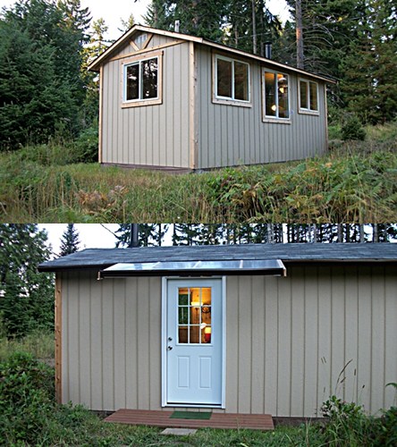

 Over a year before I decided to do another project I looked over my 2.5 acres to find the best over all place to build, it had to have equal sunlight  year round and had to have something interesting to look out on to, that accomplished I began to put plans together based on previous small home living experiences and acknowledging that I am truly a minimalist at heart and I don't want it to be the same as every other small house, it needs to break new ground.
 The theme of the entire project is "flexible space", nothing is built in, even the Kitchen is one unit... stove, fridge, storage and sink are a single  moveable unit making change easy and experience has taught me, the same every day in a small space is not good.
 Being my third "small home" this one is double the size of my last one measuring 10 by 20 feet using all things learned from the first and more.
 Walls are carpet material to hold heat and reduce cold transfer...(walls always feeling warm).
 Upper half of walls are made of tongue and groove knotty pine while the ceiling uses 10 inch knotty pine planking, all to absorb and hold heat while looking really nice and smelling great while adding thermal mass which I have found the lack of can make heating a small space difficult and more expensive than it needs to be.
 Even the Chimney is different, at the center of the peak rather than
 offset using a German made high temp Chimney bladder that weather seals the pipe (looks really good too) also a double insulated 2 inch clearance pipe which ends at a stout and ornate upgraded (double baffle) very efficient Box Stove.
 Insulation was based on location and known historical weather patterns precisely for my location, so I decided on using the new ECO Bat recycled insulation, R-19 in the walls and R-30 in the attic and R-12 foam sheeting inder the floor backed by a full coverage Tyvek blanket then all exposed under house is also sealed and thus far it is working well, winter will tell but I expect nothing dramatic.
 Electrical outlets are also unique...they come to the appliance and recoil back into the floor when not in use.
 All lighting fixtures are floor lamps using either CFL's or LED's or both.
 Windows are vinyl framed dual pane while the entry door is fiberglass exterior insulated.
 Backup power is provided by my amazing little Yamaha 1000 watt generator that will go 24 to 28 hours on a gallon of gas meeting all power requirements at 1/4 power output.
 Dual window shades are actually panels...black on one side and white on the other to allow additional heating or cooling (black facing out is for heat, white facing out is to cool).
 Bathroom and toilet are by Coleman with waste being handled by a 30 gallon peat moss based digester.
 The toughest challenge was to build an odorless cat potty box for my blind and deaf cat, that too has just been completed (thankfully)!
 Power use will be under 2 kwh a day, fact is in my large house I am
 already at 1.78 so it won't be hard to do.
 All in all, the total cost is just over ($5000.00) for everything and I
 can't wait for fall and winter.
 Next spring: I am considering adding an 8 foot slide out extension on one end....we'll see.
 VIDEO WALK THROUGH: http://www.youtube.com/watch?v=V22O5On5DUY
