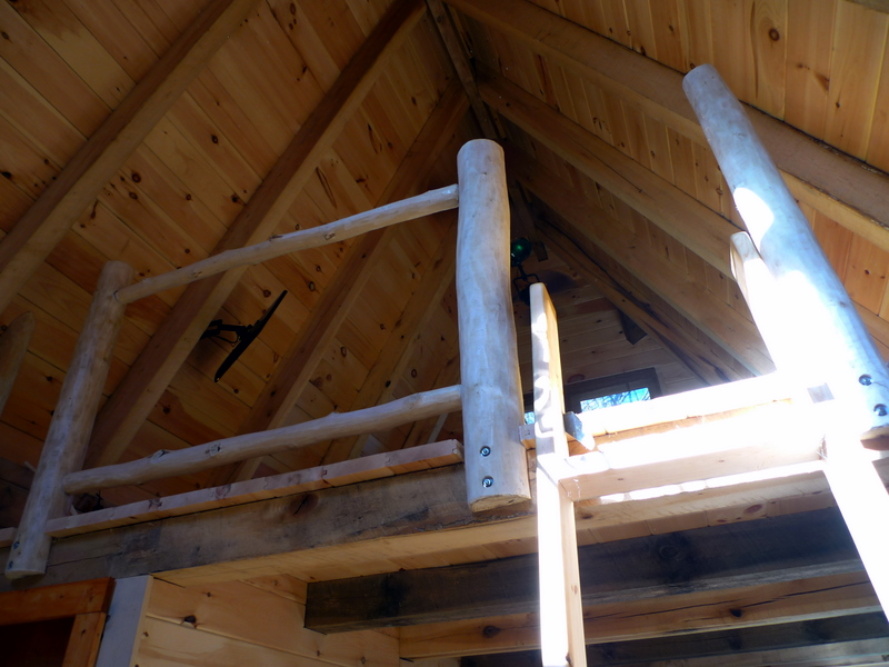

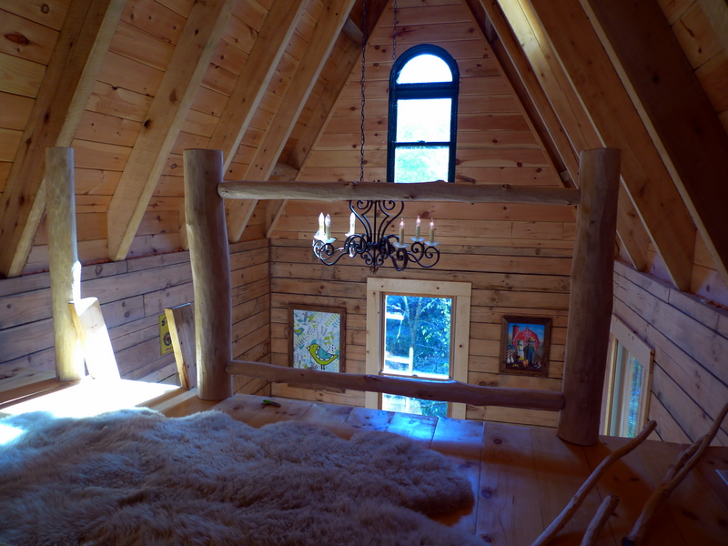

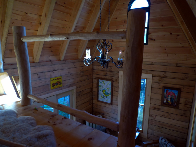

 I am on a new project with the cabin and thought I would update the post - I finally got around to starting a railing for the sleeper loft -only after my foot got snagged on a piece of clothing on the floor and nearly sent me over the edge.
 I decided to take down a poplar tree that had been blocking the view and use it for the railing.
 I used a draw knife to skin the tree and cut it into sections for the post and hand rails and then I applied a BUNCH of sealer to the wood. When it is finished there will be small branches spanning between the top and bottom railing - still deciding how I want to place them. I will post pictures of the finished project. I doubt I'll ever be 'finished' with this place :)
