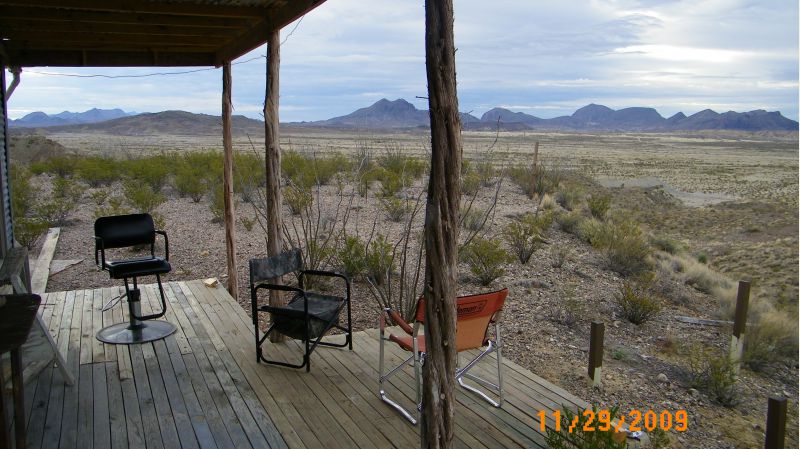

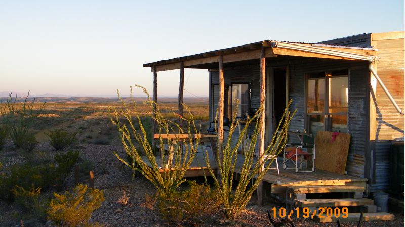

 |  front porch facing bluff ..to south

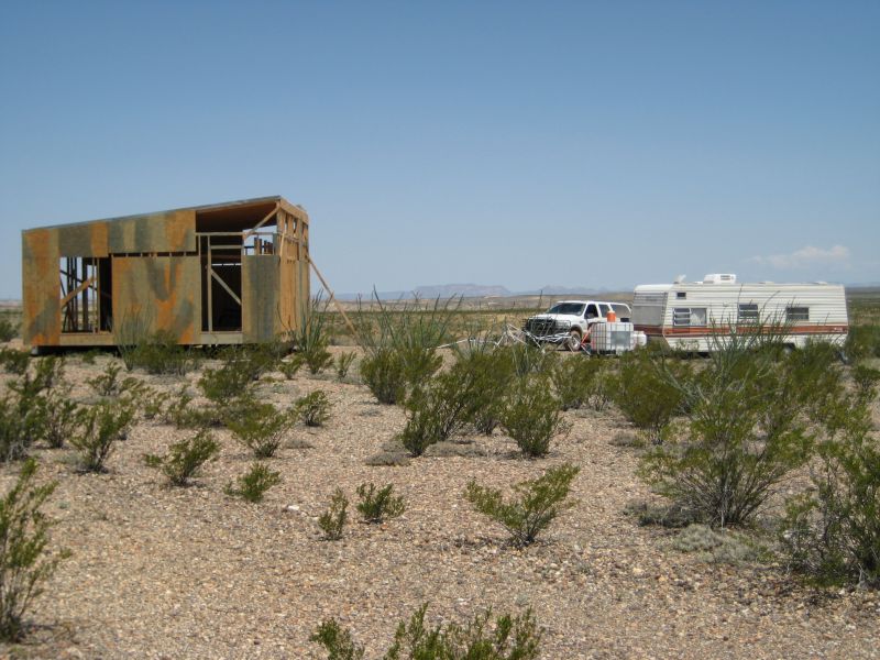

 |  framed and partial OSB skin up
 |  view from main porch..Big Bend Nat Park on horizon

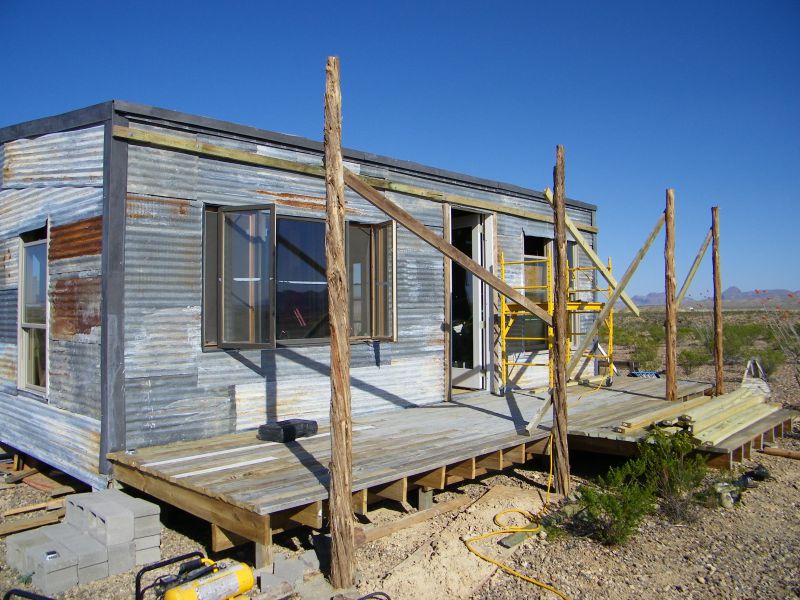

 |  front porch roof going up...no eaves due to super high wind storms

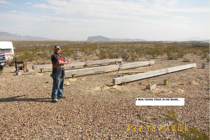

 |  in the beginning...6x12" x 14' girder bms

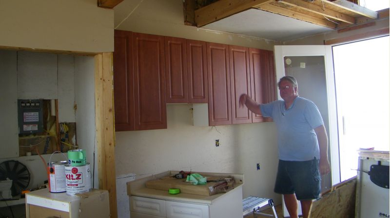

 |  cabinets in progress...kitch is way to big.!

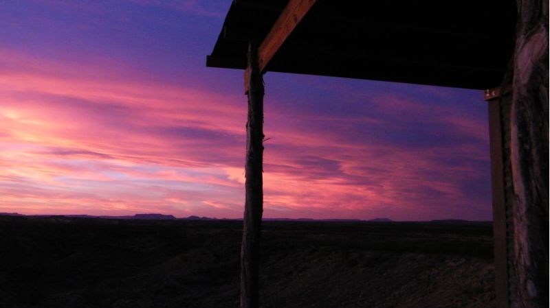

 |  another postcard sunset

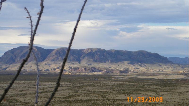

 one at a time...slow internet connection here for me.
 |  Agua Fria Mtn....5 miles away to the south

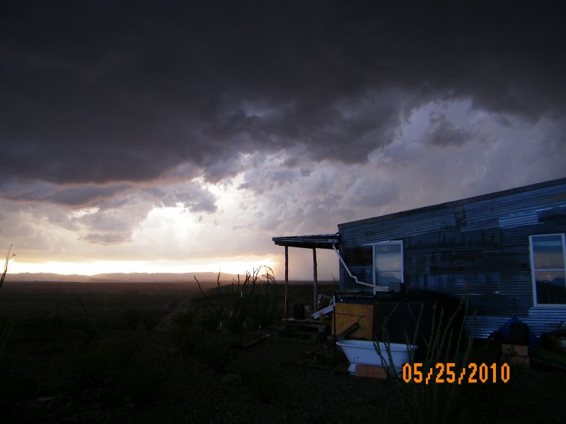

 pic

 Looks like an ominous storm coming. Hey- I noticed your nice bathtub. What kind of system do you use to get water to it? Pics? It looks like it is near your water container? Do you just open the spigot to fill?
 How far is your closest neighbor? You really look like you are by yourself out there. Cool!

 the tub (and I have another one now) is not connected, just sitting on the gravel ground.
 I plan to situate both ( like the commercial) side by side, at the cusp of the bluff off to one side of the cabin. Can fill via hose from the tank, using a cheapo 12V Harbor Fright pump....or 5 gallon buckets.
