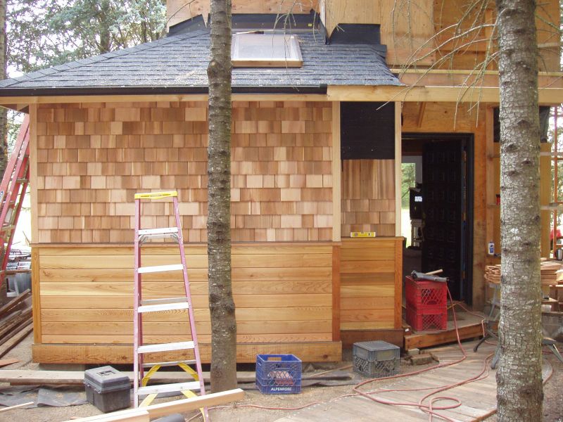

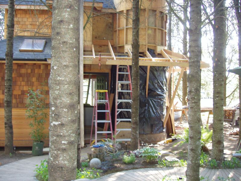

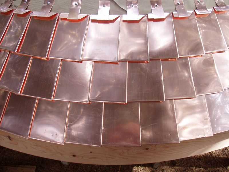

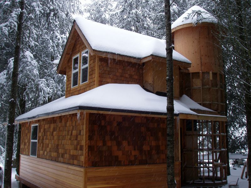

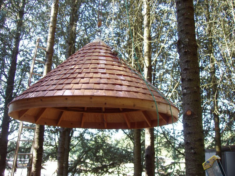

some pictures of my cabin in progress I've been working on this for about two years and hope to finish outside this coming spring> I'm building it semi modular the cabin actually can be unbolted. not likely though. It's been a very satisfying project as I'm posting this from inside no insulation and fifty degrees. brrr front door north side
|  handmade copper shingles on staircase turret roof
|  real life flying saucer
|  its looking like a white christmas

Beautiful! I can see you enjoyed building it - so much thought and attention to details... I like the copper roof.
Great work!

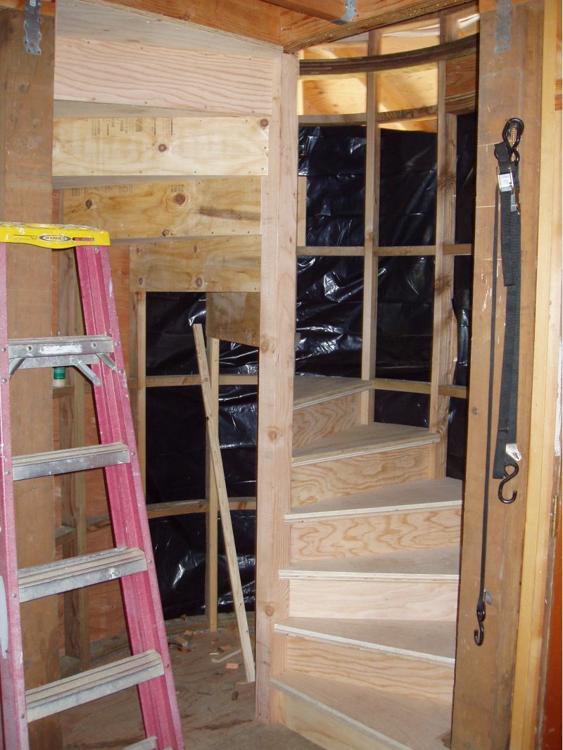

Thanks for all the positive posts. The turret when completed will be a spiral staircase. As far as fire proofing uhh no. The cabin is in a small grove of trees with firebreaks on either side. And a high volume well with firehoses.

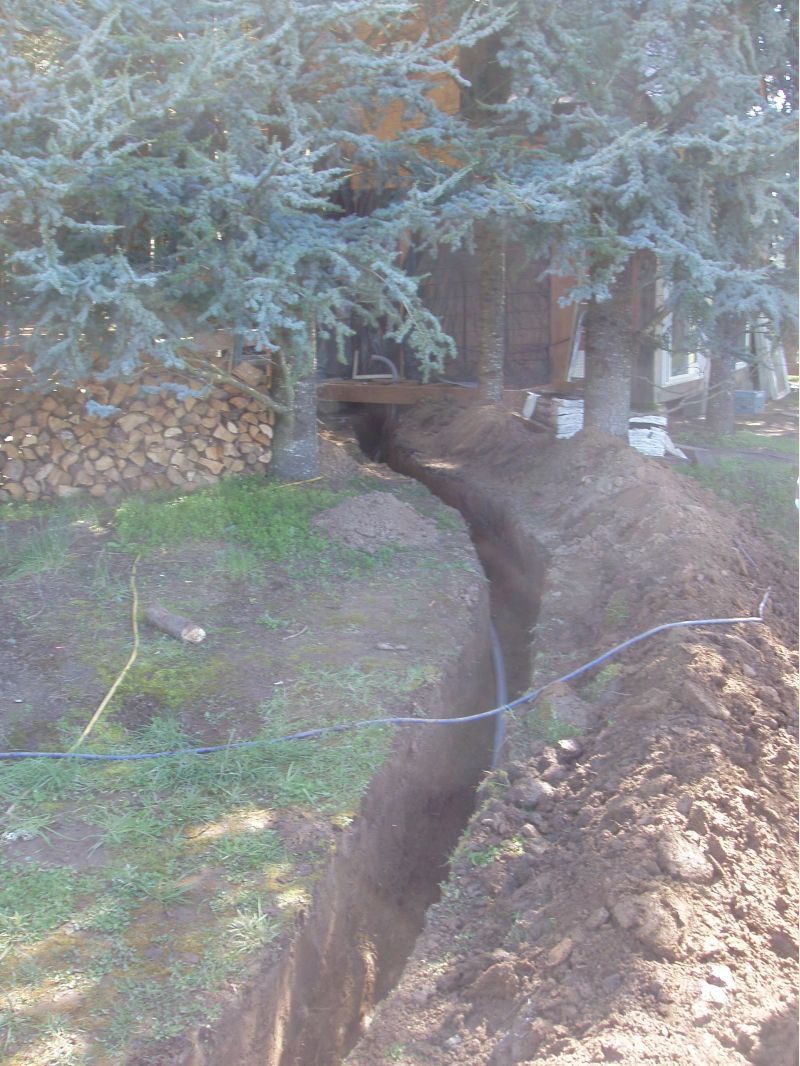

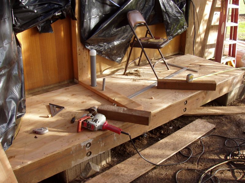

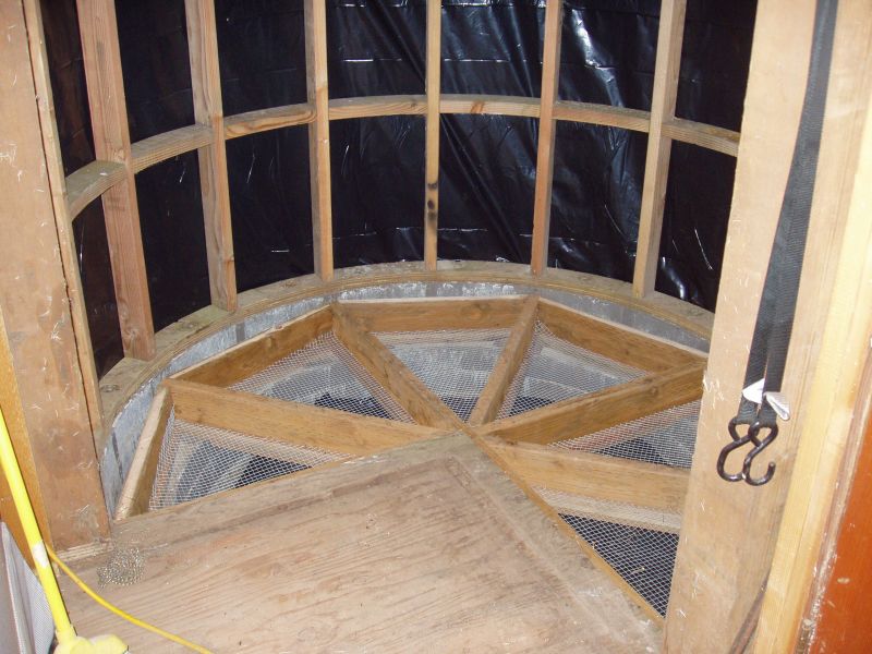

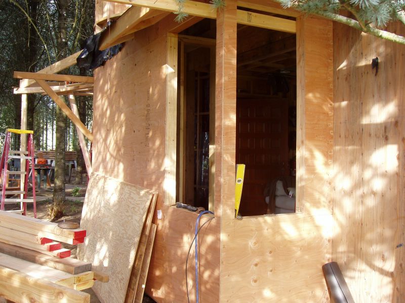

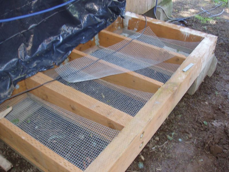

Between rain storms I've been trying to make some headway floor framing in turret
|  power conduit done
|  office/closet floor framing
|  office windows framed

Wondering what is the mesh/net for, on the "floor framing in turret" picture?
gmcgreg
# Posted: 11 May 2009 12:57am - Edited by: gmcgreg
Since I built the cabin on piers I used 1/2" hardware cloth, then landscape fabric and last Insulation. The the mesh is to keep the critters out of the insulation, even though the turret foundation is pretty well rodent proof.
Greg I fastened 1x2 p.t. to fasten the 1/2" hardware cloth to

I was reading up on the abilities of said critters, mice, rats, squirrels and from what I have seen they can get through extremely small spaces. Also rats have the ability to chew through wire to a point. I am wondering if your mesh has to large of openings. I was looking into stucco screen/mesh(not chicken wire). It comes in 4x6 or 4x8 sheets and has a much larger guage steel and much smaller holes. They cost about 4-7 dollars per screen at the large stores. I have yet to get to this step so my information on price and size could be inaccurate. The mesh has 1/4 inch by 1/4 inch diamond shape holes. I was planning on using this stuff to completely wrap the framing of the cabin. Any ideas or comments would be appreciated.

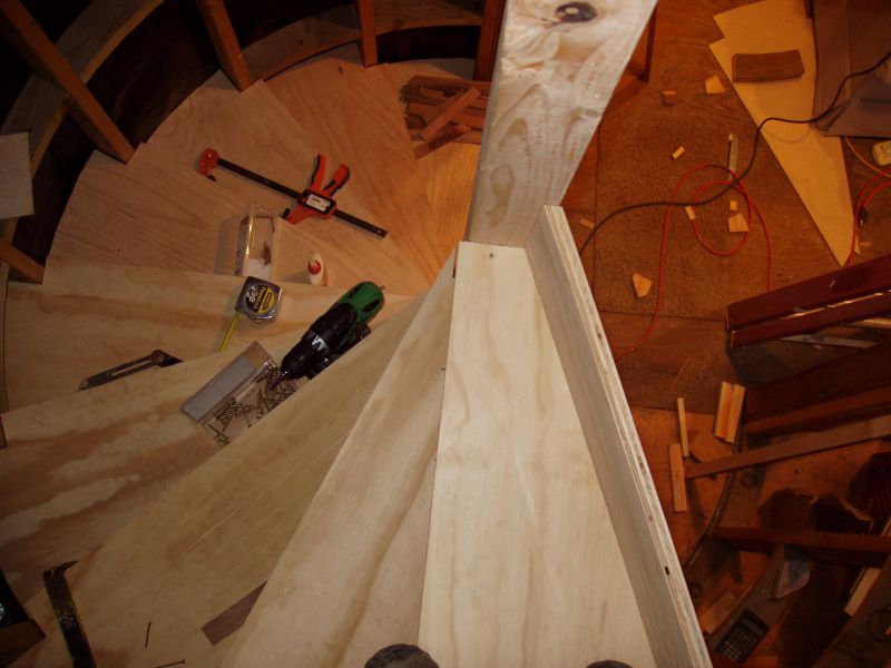

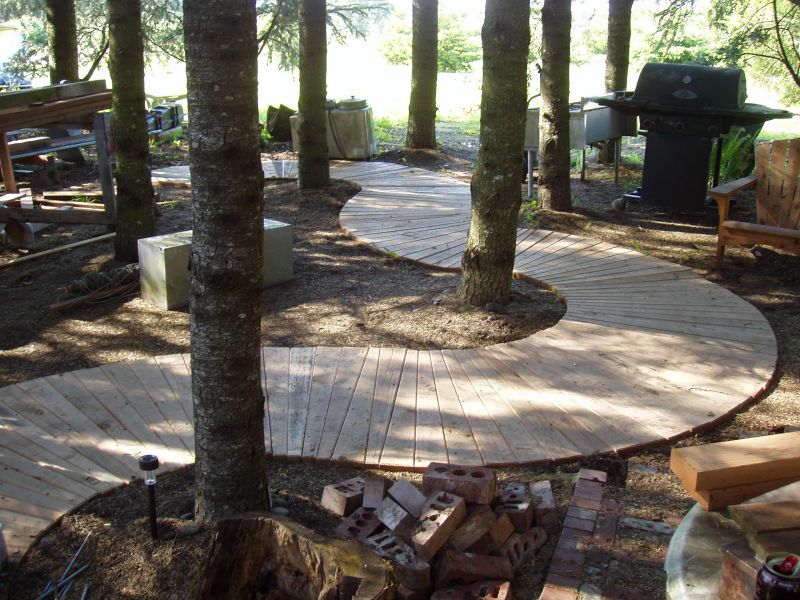

A few pictures of some work done this spring working on the lower turret roof this spring
|  My recycled deck board walk
|  three treads to go
|  sure beats the ladder I was using to get to the loft

# Posted: 15 Sep 2009 01:41pm
NICE walk way - reminds me of the family's sand dune cottage on Long Island as a kid - railroad ties and little boardwalks to get over the dunes and marshy cranberry bog area. Beautiful work!
