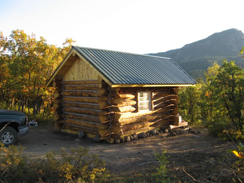

Well, we've finally got something going now. I wanted to post for a while, but figured we needed some more progress before we posted it here.
We are finally gaining ground on our shed at 8200' in the Rockies.

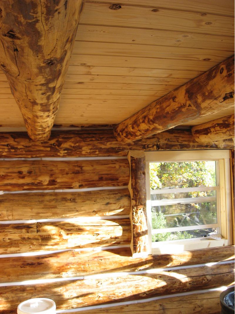

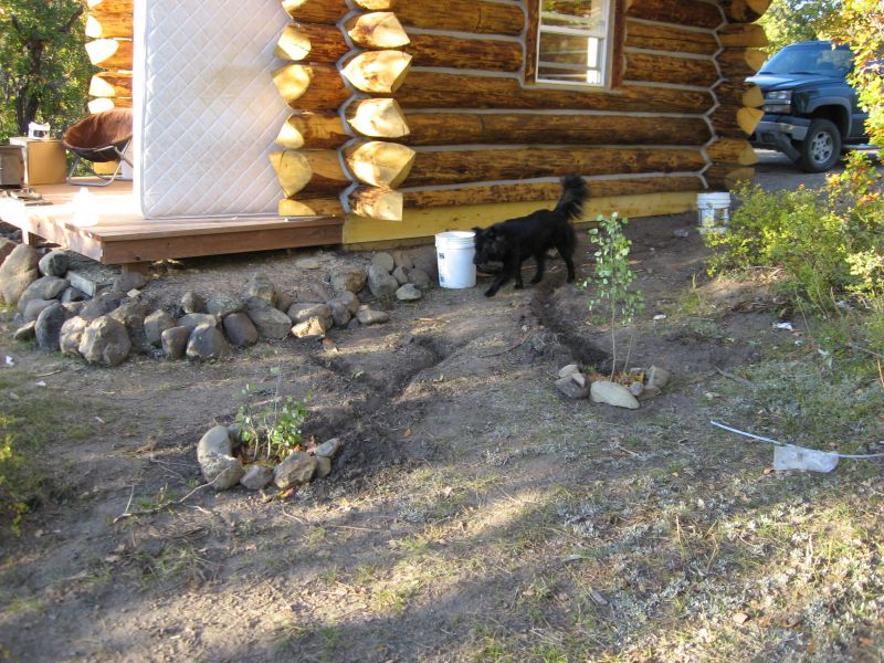

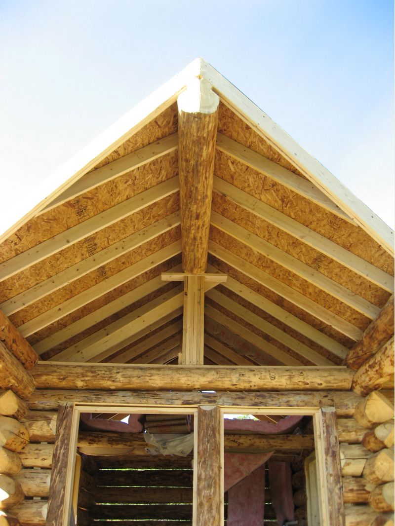

Managed to get up there last weekend. Windows hung, chinking started, staining started. Wow, that stuff has a powerful smell. Pretty sure I still have a contact high. We even managed to get a couple of Aspens planted. Fall is just starting to show its beauty. We have much to do before the snow flies though.
Roof is on
Roof is on
Loft detail
Loft detail
Under loft
Under loft
Aspen Plantings
Aspen Plantings

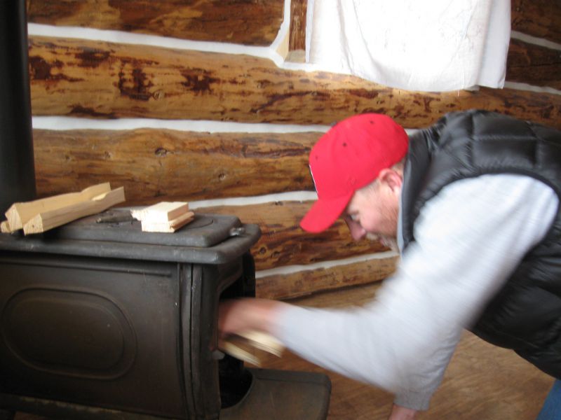

Well, after a couple nights of the dog's water bowl freezing and using 4 blankets, we finally got started on the wood stove. It was an older craigslist pickup, so we resealed the whole thing, and took to cutting a hole in the roof. We ran single wall pipe to the ceiling, then triple wall through the roof box. We managed to get the roof flashing in place after a little bit of finagleing, attached the spark arrestor and drip cap, and sealed it up with blackjack.
As you can see, we didn't have toe holds, so we did the good ol' fashioned "tie a ladder to a trunk on the other side of the eve" trick. Our rope wasn't duty rated for the 3 240lb guys working the project, but everyone made it out alright.
I still have a bit of learning to do with regards to burn intensity, and smoke reduction, but we're well on our way. Just skied last weekend and it never got below 50.

Great work on the stove! Your chimney doesn't look too tall, but it could be the angle. Do you get good draw? If so, you shouldn't have any smoke in the cabin at all. How does it do overnight?
Creative solution you had there for the ladder. We have a really long extension ladder so we were able to just lean it against the roof and walk up...good thing too, as our 2 sections of double wall weighed a TON and it was just my husband and I putting it up there.
dstraate
# Posted: 29 Nov 2011 02:52pm
You're right about the chimney. We only used one section of triple wall. It seems to draw just fine though. Mostly I need to just start a good hot fire immediately and not fiddle around. A little bit of smoke from a fumbling fire starter can make 180 ft. smoky in a hurry. Most of my issues are user error and unseasoned wood.

In general you want the chimney 2 feet above the peak. You might check into adding another section of triplewall (after the checkbook cools down). If shopping craigslist be aware that sections from different mfrs NEVER fit together. It is useful to have triplewall outside to maintain high flue temp for good draw and also in case your wood supply has a lot of creosote. And it might help to have a little longer flue.
When you build your fire::::
Build your normal arrangement of paper and kindling. But then put another fluffy ball of of newspaper ABOVE the little starter fire (or maybe behind). Light the kindling paper first, (as normal) then when it's lit in a few spots, touch off the upper ball of paper.
When the upper ball of paper goes off quickly and hot it will start your draft up the chimney.
Another tip I have for a small-cabin newby. Small cabin=small stove=all burned up by 4:AM. I buy the biggest, heaviest presto-logs I can find and use one per night. Just before bedtime fill the stove up and put that one presto-log on the top. With that method I've had good luck waking up to coals.
