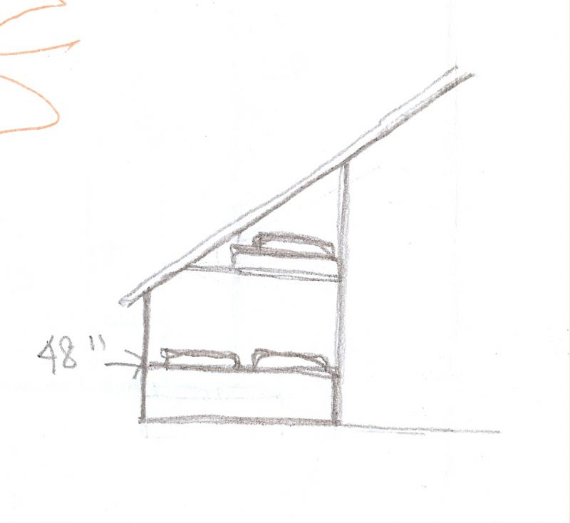

# Posted: 26 Sep 2011 10:41am
Congratulation bhebby!! Looks really good and it will be exciting watching it come along.
How big is your cabin and how many bunks do you need? In our loft we will be building in a single over double bunk. It will be just like your short wall. If your double side was placed parallel right up against your short wall the single would be over it but towards the outside of the double allowing for enough headroom I think. Does that make any sense? What is your roof pitch? How tall is your short wall?

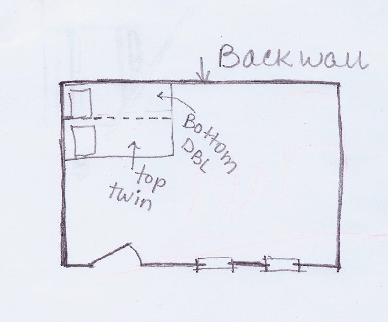

Maybe these (very quick) drawings will help. Depending on how many you need and how long your cabin is you may be able to build in more than one set of these.

# Posted: 26 Sep 2011 02:15pm - Edited by: trollbridge
Ha! The salmon and deer need you...you better hurry!!! I go mental when I'm not at our place!!! We are in northwestern Wisconsin about 11 miles south of Lake Superior. The way we are doing our bunk is a two person(dbl or queen size) on bottom and twin on top. So it sleeps 3. Depending on who is sleeping there you may want something different. Tell us more about what you are envisioning...is this a family cabin,hunting shack for buddies or something combined?

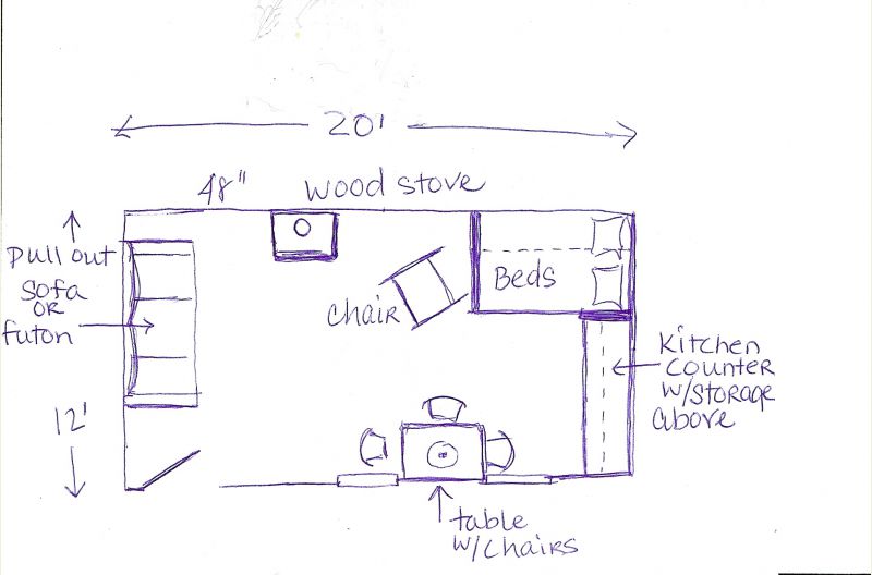

# Posted: 26 Sep 2011 04:12pm
Here is an idea that you may like. It is not drawn to scale.

# Posted: 26 Sep 2011 05:12pm
Actually in this case though it may just be best on the short wall- here is my thinking:
Not much else one can do with the shorter walls anyways and heat rises, so it may be better off in the lowest part of the roof.

# Posted: 27 Sep 2011 08:08am
Troll bridge thanks for taking the time with the hand sketches! I am taking your advice on the bed location and I was either going to put the stove where you had it or in the far corner and place the couch futon in the stove location you had on the last sketch. I think I may have have chosen fashion over function but again I didnt want it to look like I was bunking up in a lawnmower shed. I will eventually build a few small bunk houses for others to crash but one thing at a time right! I dont have a stove yet except for an old wood coal cookstove which I am no longer going to use.
# Posted: 27 Sep 2011 09:35am
If you do go with the futon on the short back wall make sure you have enough headroom and remember not just while sitting but also walking over to it. Yeah by having the sloped roof going down to a 4 foot wall you limited yourself somewhat but I totally think it is cool and very fitting for your area. Like I said , I can picture in my head a really cozy place with your set up. What are you going to do for siding?
